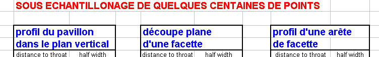

Hi Jean-Michel,
Can you explain the sections shown below?
In the Le ClŽFc'h profile, I wish to be able to set the initial angle of the horn. Is this done by setting the value right under the "throat diameter"?
What does the "d¨¦coupe_plane_facettes" sheet show?
Hello Soongsc,
You asked me to explain what means:"découpe plane d'une facette" in my spreadsheet one can use for the calculation of axial horns.
In this version of the spreadsheet an option is the calculation of a "gramophone style" horn. The horn is made from the edge to edge assembly of many facets (or petals). Each facet (or petal) can be cut inside a sheet of plywood, cardboard or metal using the coordiante of the points under the title "découpe plane d'une facette".
Also about "profil d'une arête de facette" this was added at the request of someone who want to build profiled rigidifiers to add at the back of every edge between 2 facets (or petals) in a gramophone style le Cléac'h horn.
