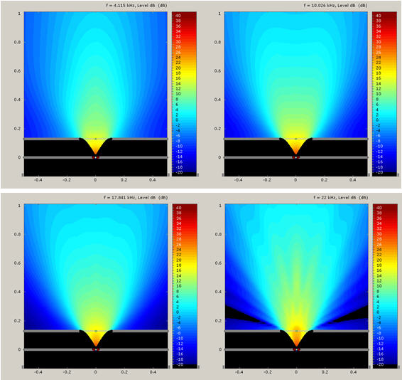

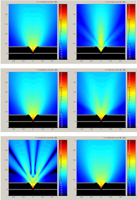

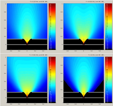

Very interesting things happen when you change the throat. Note now the directivity is not as good, but much smoother. Actually, at 19.8KHz the directivity is still quite good and still quite smooth.
I actually think if Earl's design had a specially designed driver with a well match with the wave guide, performance could really be such that possibly foam would not be necessary.
soongsc said:I actually think if Earl's design had a specially designed driver with a well match with the wave guide, performance could really be such that possibly foam would not be necessary.
Thats a guess, and a bad one IMO. "Necessary is not the right word, its "desirable" and always will be.
