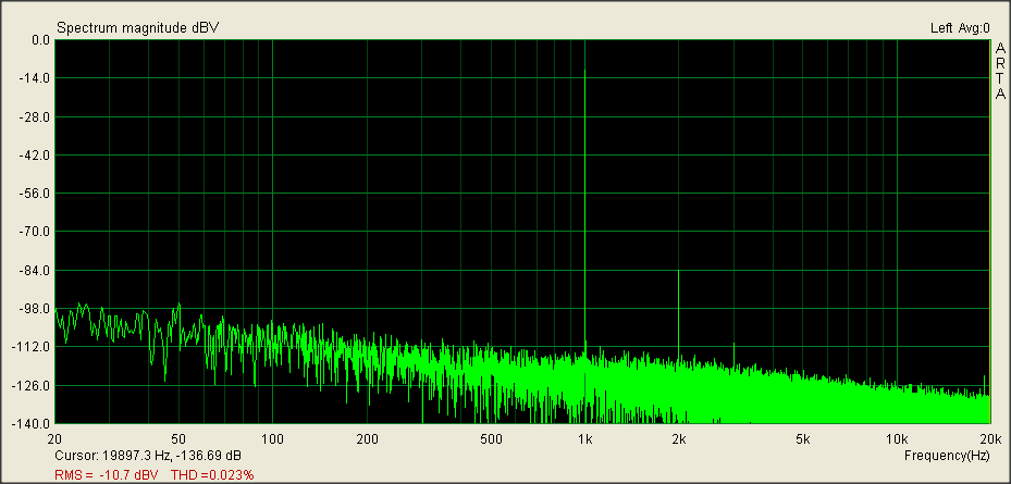

Its a no global feedback two gain stages plus buffer design of about 62dB max gain (HMC MM MC LMC sensitivity DIP switch selectable) and about 0.02% THD mainly 2nd harmonic at nominal output. Which is -10dBV consumer level (316mV at 5cm/sec record velocity) with ~40 Ohm output impedance.
A typical non averaged FFT chart at max sensitivity setting when driven with 1kHz 0.25mV shall compare to this one from the prototype:
