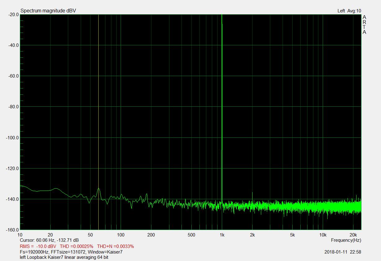

Hi Joseph,
Okay, here is what I get set as you recommend. I used Hanning because that is what I use on my real instruments.
-Chris

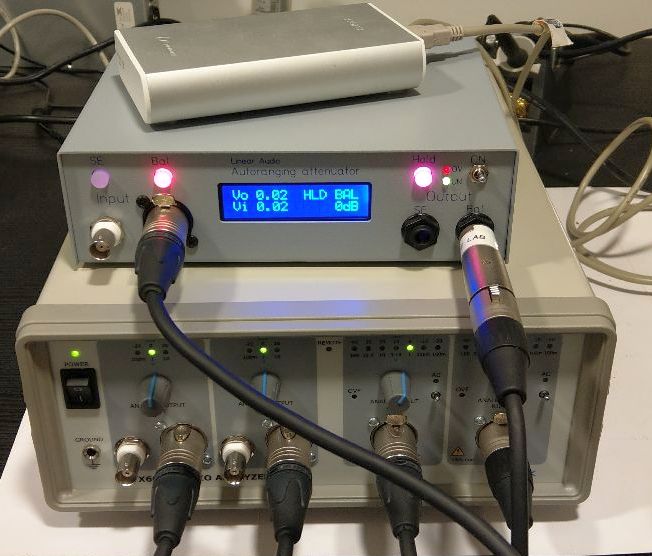

I've received my unit yesterday as well - thank you goes out to RTX team!
I did some quick tests at 0dB settings - looks as good as expected.
I then also ran one quick test with Jan's Autoranger (also 0dB setting) in the right channel loop... it's almost as good as RTX, but one can see about 5dB difference in noisefloor. That does show how good the RTX is - I sure am happy with it.

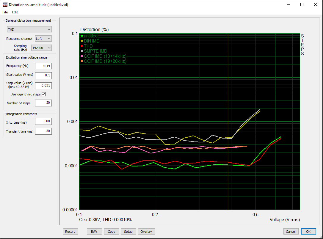

Some more results.
RTX6001 left ch loopback - out setting 0dBV / in setting 0dBV
For THD the levels below approx 0.47V show same THD. Above that a small raise.
For IMD it seems <0.4V is the lowest distortion.
dBV wise the stepping was from -20...-4 dBV
In any case the results are below 0.001% which is superb as is.
