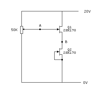

I saw some recent posts about matching the 2SK170's in the buffer, starting around post #902. So with nothing better to do I tried that on 18 unmatched 2SK170's, using 10V as suggested by AndrewT, with a DMM reading milliamps, and the gate tied to source as in Tea-Bag's link here.
The current I measured was (in mA) 6.74 6.82 7.10 7.24 7.50 7.72 7.73 7.85 7.90 8.32 8.38 8.53 8.67 8.68 9.64 9.65 9.90 10.95
I tested 3 of them at 9V and the result was approx 0.1mA lower. Looks like a few good matches there.
Still feeling restless, I tried matching some LED strings of 3 and 5 to get 5.4V and 9V as per Salas' post #642. The forward voltage drop seems to depend on the current through the string, so I breadboarded the string of 3 with the 2SK170 and 100 ohm resistor, which gave a current around 7mA. On the string of 5 LED's, I breadboarded them with the 2SK170 and 10 ohm resistor and the current draw was 16mA. So I managed 5.40V for the string of 3 LED's, and 9.39V for each string of 5 was the best I could do, should be OK. Be interesting to see if the matched strings of 5 actually result in equal pos and neg rails...being anal I included the 2SK170 with each string that I matched in the bag with the LED's, ready to go into the PCB. The Idss of the 2SK170 can be used to fine tune each string, but who knows what happens when it all burns in. If the currents through each string really are different when the cct is built (7mA vs 16mA), I don't understand how we can get the ideal 1.8V voltage drop across each LED by using the same part number LED in both strings - maybe it doesn't matter that much.
AndrewT said in post #910
"Within 1% is so tight, many of us cannot measure Idss to this accuracy AND hold all the other parameters at the correct values. I certainly can't. I doubt whether I can measure an absolute 5% tolerance for Idss."
From this I gather that the Idss measuring method in the link is very basic, or is not taking into account many other factors, or maybe it just doesn't test the true definition of Idss, I don't know, I don't have the experience that others do here on this forum. It seems that we are aiming for a minimum DC output offset by having the 2 x 2SK170's matched. So I breadboarded a simple cct to try to simulate what might happen as far as DC offset goes. It might be a bad idea this cct, but I was curious. Cct shown below.
I put in my "matched pairs" of 2SK170, set the power supply to 20.00V, set the pot wiper to 10.00V, and measured between points A and B to try to measure the DC offset. The result of this little experiment was, (whether it be a good idea or completely stupid) that the "matched pairs" I came up with by using the test method from the link above, returned small DC offsets from 0.2mV to 2.4mV.
Pair Idss 7.72/7.73 offset 0.2mV
Pair Idss 9.64/9.65 offset 0.3mV
Pair Idss 8.67/8.68 offset 0.7mV
Pair Idss 7.85/7.90 offset 1.4mV
Pair Idss 8.32/8.38 offset 1.4mV
Pair Idss 6.74/6.82 offset 2.4mV
Swapping the positions of the upper and lower 2SK170 often changed the DC offset by about 0.2mV, but there is drift going on and final values after burn in could be different. Will be interesting to see what happens when I put the bits in the PCB. Thanks for sharing you guys, Salas, NP, Tea-Bag, crt and all the others I've missed.
you are measuring Vgs. That is not quite the same as output offset.
But, it does allow a comparison.
Take the first three pairs.
Your measuring of Idss indicate that each pair have a mismatch of 0.01mA. That is 1part in many hundreds. i.e. a lot closer than <=0.3%.
Look at the Vgs variations. 0.2mV to 0.7mV. There is little correlation between the <0.3% selection and the output offset. That tells me the Idss was not measured to better than 0.3% it was more likley that it exceeded 2%. Now take these three pairs and set them up as an LTP, with the sources connected and the gates connected and now measure the volts drop across the 1k0+-0.05% load resistors. Connect gates to sources so that each half of the LTP is passing Idss. I guarantee that your load currents for all three pairs will not match to better than <=1%. i.e. your initial selection of 0.01mA is only good for batching into similar groups. Our DIY methods of measuring Idss and other parameters are flawed when attempting absolute measurements. That's why I compare one (DUT) against another (REF), I cannot achieve accuracy for absolute measurements and recognising this means I never fall into the trap of claiming absolute accuracy of my measurements.
Now look at the gross range of your six pairs. Here we can se the trend of rising Vgs as Idss difference increases. That conforms that the method has some reproducability. It is not worthless, just don't rely on it for absolute measurement.
The biggest problem as I see it, is holding Tj=25degC. I can never achieve that.
A final reminder.
The B1 does not need matched pairs. It simply requires selection of similar Idss pairs.
Any amateur measurement procedure with a bit of care can achieve that.
