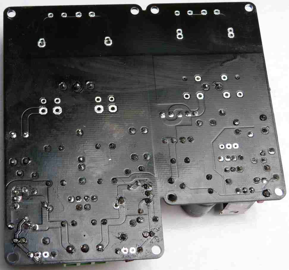

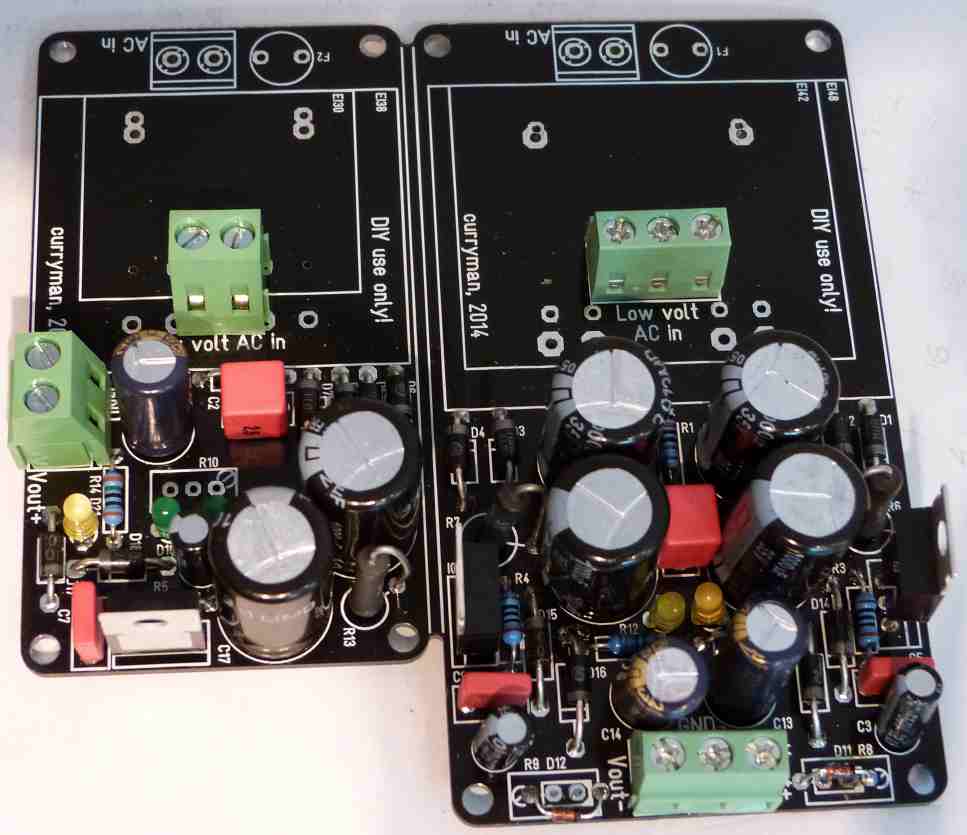

I've started assembling my Curryman DAC but I'm having some issues with the PSU that I could use some help with. I used the build as specified as the standard build in the build guide. I'm using a 9vac torroid for the small 5 vdc board and a 18vac torroid for the larger +/-14.5 vdc for the buffer. Under no load conditions I'm getting 8 vdc out of the smaller board, I'm also getting +14.5 vdc/ -18.5 vdc on the other PSU. I verified that all of the resistor values are as in the build guide, I replaced the both LM317,s and both of the 13v zeners with no change. I checked the board for shorts but haven't found any. I've attached some pictures so maybe someone can give me a pointer on what the check or can see something that I missed.
Thanks,
Paul

Hm, that's a tricky one...did you measure the resistors before soldering, and are you sure that the LM chips are no fakes? Once I was usig PRP resistors, and some had completely wrong values, which took quite some time to debug.
Good luck with finding the cause!
Ok so I figured it out. There is an error in the PSU build guide it lists IC1 and IC2 as LM317 and IC3 as LM337. It doesn't agree with the schematic, I should have followed the schematic and thought about things a little, need a LM337 for the negative regulator, not two positive regulators, duh. Lessons learned. Everything is functioning properly now, I should be listening to this DAC soon. I'll be comparing it to the Subbu DAC which I've got to has turned out to be a superb DAC after break in. Beats my Twisted Pear Opus DAC by quite a margin.

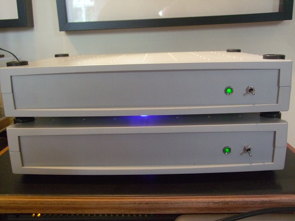

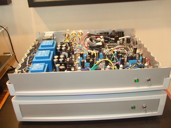

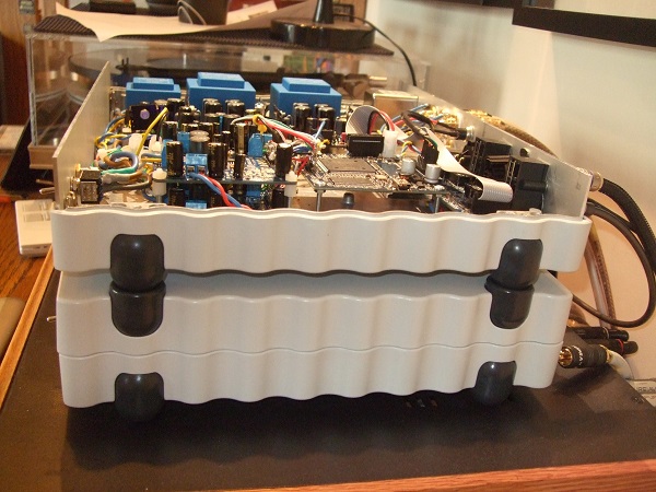

Here's a few pictures of my PSUs feeding 3 Curryman dacs. The Minisharc gets its power from a Twisted Pear shunt in the case below. There's not much spare space as the case was originally going to be used for a pair of dacs, but has now grown to three, so it gets a bit toasty in there, but not any hotter than other dacs I've had.
The more I listen to this setup the more I'm impressed by the Curryman dacs. In my system they output to an 8 ch MSB volume control and then to 3 power amps driving Magneplanar MG2.5r and a pair of Linkwitz LX521 dipole bass units. The highs are beautifully detailed and realistic, individual voices on harmony vocals are distinct and in the room - it's been fun building the PSUs and even better to listen to the end results - nice one Daniel (and Joachim).
