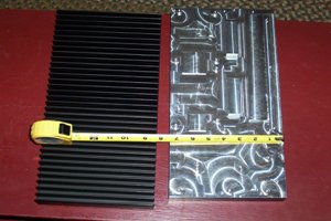

heatsinks
I am still looking for a source for these heatsinks, are they only available directly from Conrad?
I used Conrad MF35-151.5 heatsinks and they worked very well.

People looking for heatsinks should have a look at this thread:
http://www.diyaudio.com/forums/showthread.php?s=&threadid=117303
I'm not sure if more are for sale, but perhaps you could group together and get a new batch ordered.

I have the Surplus heatsinks we discussed earlier running with the PD F5 board. 3-4 hours and I can still grab the heatsink for a long time. The conrads (I have four of these now) I think are overkill for F5. The surplus heatsinks I have are ~13" X 7 1/2" X 1" fins (sorry for english measurements).
This weekend should be warm, so I will crank the house heat to 75F and run normal bias and let it run all day to see if it will have some room to run in the summer.
As we calculated earlier, these are .50 c/w sinks. If it's close, I will glue a bunch of PC heatsinks on the inside, since the board itself takes so little room.
