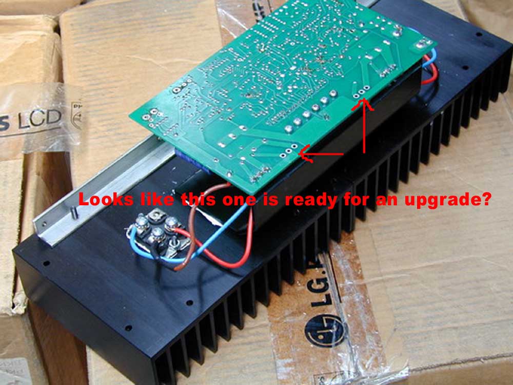

Yes,it's an upgrade
Yes, I think it's an upgrade but if you have only 1 biggest mosfet you don't need parallel mosfet together.
200WRMS/CH enough for me !!!
analog guy
Obvious upgrade or not? O.k. we'll ignore these holes in the board? Were the engineers having a battle? It seems someone wanted 4 outputs paralleled
analog guy
