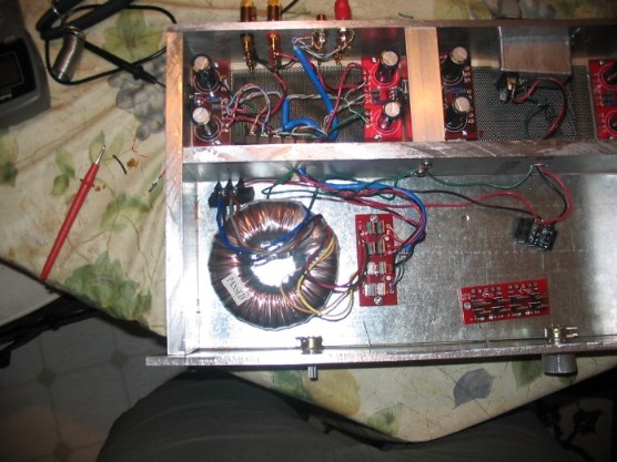

GC pwr miss-hap
Hi All-
I just powered on my first GC without spkrs for testing purposes and heard a buzz sound. I switched it off and then tried again with the same results.
After investigating, I realized that the PG+ and V+ wires were crossed from the rectifier board to the amp board.
I corrected that issue and turned the switch on again.
This time the 2.5 amp fuse blew immediately.
Questions:
1) 2.5 amp fast blow fuse big enough?
2) Did I kill the 1500uF caps? They were what were buzzing.
3) Did I kill the LM3875?
4) Which is easier to test, caps or chip? I have a Fluke 87 and I believe it measures capacitance, but I'm not sure if it will reach 1500uF.
5) Anyone have spares they want to sell?
By the way, I KNOW, I'M AN IDIOT!!! Such a simple screw up.
Thanks in advance for your assistance,
Troy

Troy,
Try using a 3A slow blow fuse, as the fast blow will probably die from the inrush currents.
The LM3875 might not be dead. As for the capacitor, if you don't see the top domed up, or leaking fluid, they might be fine for now also.
Give it a try again with a slow blow, and if you are still having problems, I can mail you some new components.
Brian
IT'S ALIVE!!!!!!!!!!!!!
I just finished testing the first 2 channels of my first GC which is going to be a 4 channel amp. I'm Stoked!! Thx Brian and everyone that helped me. I'll post more pics after I complete this little beauty.
