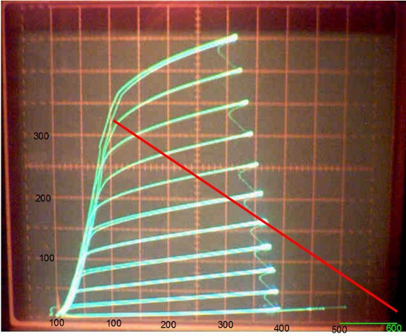

I made some more measurements and my plate swing is 480V peak for a 580V plate-cathode voltage. So I'm only swinging down to 100V plate-cathode at clipping. Clipping occurs at 160V pk-pk g2 drive, but the driver is capable of 200V pk-pk before it clips. The driver's pushing harder but nothing's coming out...
Vg2 = 8.5V idle, 160V pk-pk drive at output clipping, 200V pk-pk at driver clipping
Vg1 = -2V idle, 36V pk-pk drive at output clipping, 44V pk-pk at driver clipping
Idle current is 20mA/side at 600V plate-cathode.
All I can imagine is that I'm hitting some limit in the output stage that prevents further plate swing. I haven't checked the total cathode current but maybe the total g1 + g2 current is diverting plate current. Something to think about.
Maybe I'll configure it in regular tetrode mode and see how that works. Hmm I can also get another 20V pk with the current driver; maybe I can try to reduce the g2/g1 ratio, increasing the g2 drive swing ralative to g1, and see if I get more plate swing that way.

Hmm earlier in this very thread may be the answer
http://www.diyaudio.com/forums/tube...aled-drive-strawman-design-2.html#post2135104
Don's curve with my loadline leads me to only expect 100Vak minimum on this load line. And the explanation is somewhat similar to what I have been thinking.
The cathode current curves tell the story I think:
http://www.diyaudio.com/forums/tube...scaled-drive-strawman-design.html#post2133023
Showing 300mA cathode current peaks for 200mA plate current peaks, and apparently not showing the additional 60mA g1+g2 current spikes on top of that. If these ratios hold for 350mA peak plate current, the max cathode emission capability is probably being exceeded and I need a tube with a bigger cathode. More gm couldn't hurt either...
Oops, bottom left corver of the graph should be labeled "0"
OR
Maybe the solution is to reduce the peak g1 current. I can try to offset g1 to negative bias and increase the g2 positive bias, keeping the AC drive voltages and levels the same as now. This will reduce the g1 current and may get the Vak(min) back down to 50V as in pure g2 drive operation. for example, g2 could be biased at +80V and run with 160V P-P drive, while g2 might be biased at about -20V or thereabouts, which would prevent g1 from needing to go positive.
Time to think up a circuit for adjustable g1 offset...
