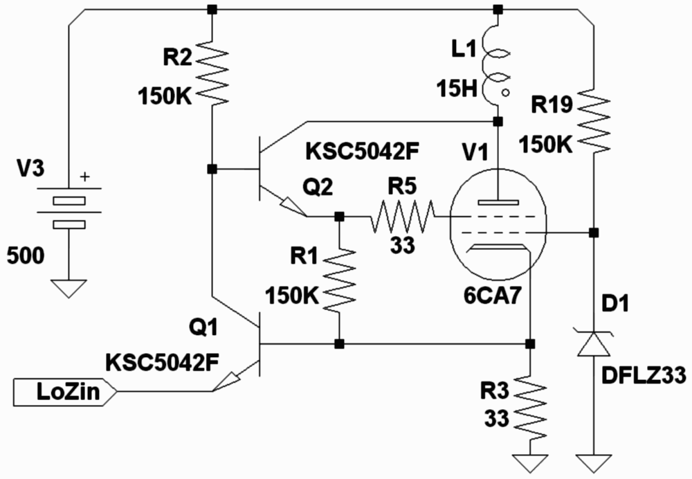

G1=G2/mu Scaled Drive Strawman Design
I was messin with a similar idea but run into two problems, not sure I have
chosen the most ideal ways for solving them...
Problem 1: Triode voltage amplification. Too darn linear, neither triode nor
screen have the right curves out at the bottom to cross without a glitch.
And also no guarantee this warms up before the Pentode it must control.
I've solved by using starved FET to round the bottoms into a nice crossing,
and solid scrape BJT for voltage amp scaled to both grids. The plate dipping
into the screen with no feedback to "fix" it, seems to round the top nicely.
Problem 2: This is a sim with imperfect models for grid and screen currents.
I really don't have a clue how well this correlates to reality, especially in
terms of what G1 with positive bias is likely to bleed... Or what affect the
positively bent shadow casts upon G2?
I've not made any progress toward solving this, other than make sure to
select a pentode without screen and grid alignment. I still worry the G1+
shadow focuses a hot spot directly onto G2? 6CA7, EL34, and GU50 all
seem likely suspects to not have any such alignments. There are not any
big space charge tetrodes with deliberate grid screen un-alignment???

Late edit:
Q1 Q4 don't substitute well with 12ax7 (not enough current) nor 12at7
(not enough voltage gain). Mu isn't really needed where already Schaded
by grid divider. I might revisit this area to see if a small pentode might do.
Why the crossing glitch has not been looked into before? All the rest are
looking only at Class A or pure B? If I don't care AB crossing, I can make
the single ended behavior very much more linear.
Dump a constant current into G1, and drive G2 just like an Aleph pair...
Its plenty linear, but you won't get no soft limits nor a smooth AB crossing.
Here we forget to care what is screen drive voltage? Only care what is the
cathode voltage...
Kentucky Sanded Chicken 5042F is original recipe below 900V and 6W.
Above those limits, extra crispie.

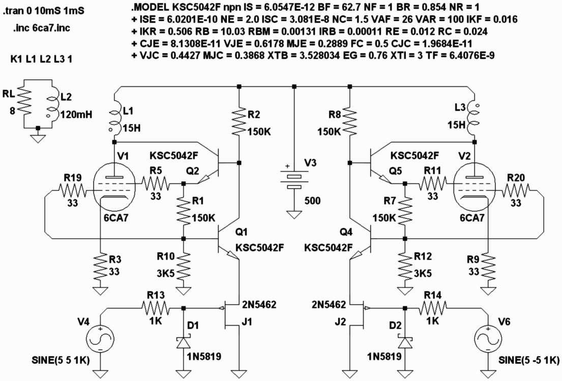

re Ken:
In your schematic in post #41, the pentode Spice model must not be drawing any g1 current. R1 at 150 K will never hack it. Maybe connect g1 to Q1 emitter instead, except that will affect the input current gain -> faster turnoff or slower turn-on actually (positive g1 drawing current). Maybe just massage the divider resistors, as is, until you get the crossover curve needed. Hmm, no, this just affects the high current end of the pentode curve (g1 positive).
I've modded my curve tracer to include grid current curves now, so I will get some curves up by the end of the week hopefully. Some quick tests didn't show any particularly obvious g1 -> g2 focusing effect yet. I still have it all apart for mods to the stepper voltage power supply.
I question how well the SPICE models are going to work here.
I suspect that the tetrode model is unlikely to be of much help in evaluating the fine points of this mode of operation. It seems like they assume relatively high G2 voltage and have a simple diode model for +G1. Even if the focusing is not a problem, an accurate current model at low Vg2 and high Vg1 is required. G1 current will likely be over 100mA at peak. It's not clear if cathode resistance is modeled properly as the limit of emission is approached, which is also necessary to model this mode.
I have been looking into tube models and wonder if the Excem models are being used anywhere? They seem to have taken into account more of the edge effects, but still not sure about low Vg2 region.

re Ken: Hmm, no, this just affects the high current end of the pentode curve (g1 positive).
Yes, the base follower corrects G1 with a strong feedback. G2 not so much...
Exact opposite your situation where G2 is corrected by the strong feedback.
I suspected 150K was a bit high, but without an updated model or real info,
just dividing in the dark.
In the second drawing: How many mA could a CCS safely dump into G1???
I hope that G2 in the Aleph variant will automagically pinch off and cloud up
extra electrons around G1, if G1 ever starts to become dangerously emissive.
In light of Q2 watchdog over runaway, do you think Zenier serves a purpose?
Here are my thoughts on the nature of the crossing glitch:
- Composite gm changes abruptly as one tube goes into cutoff. This can be mitigated by controlling the overlap and, in the case of scaled drive, the bias ratio of the 2 grids; i.e. if either g1 or g2 dominates the gm as cutoff is approached, then the gm slope will change
- Each side of the driver may see a slightly different copy of the output signal as feedback which may change abruptly in the crossover region. I think this causes the phenomenon discussed in another thread, where each side operates as an independent low impedance triode, leading to the behavior Schade discusses about triodes in class AB in his paper. One solution is a topology that combines feedback from both sides as in the coupling transformer in Schade's paper.
- The stored energy in the transformer leakage inductance causes back-emf as each side's tube cuts off. I have wondered if a minimum current through the tube e.g. 5mA would make any difference. Prevent the tube from cutting off completely. Is it then class A? ;-)

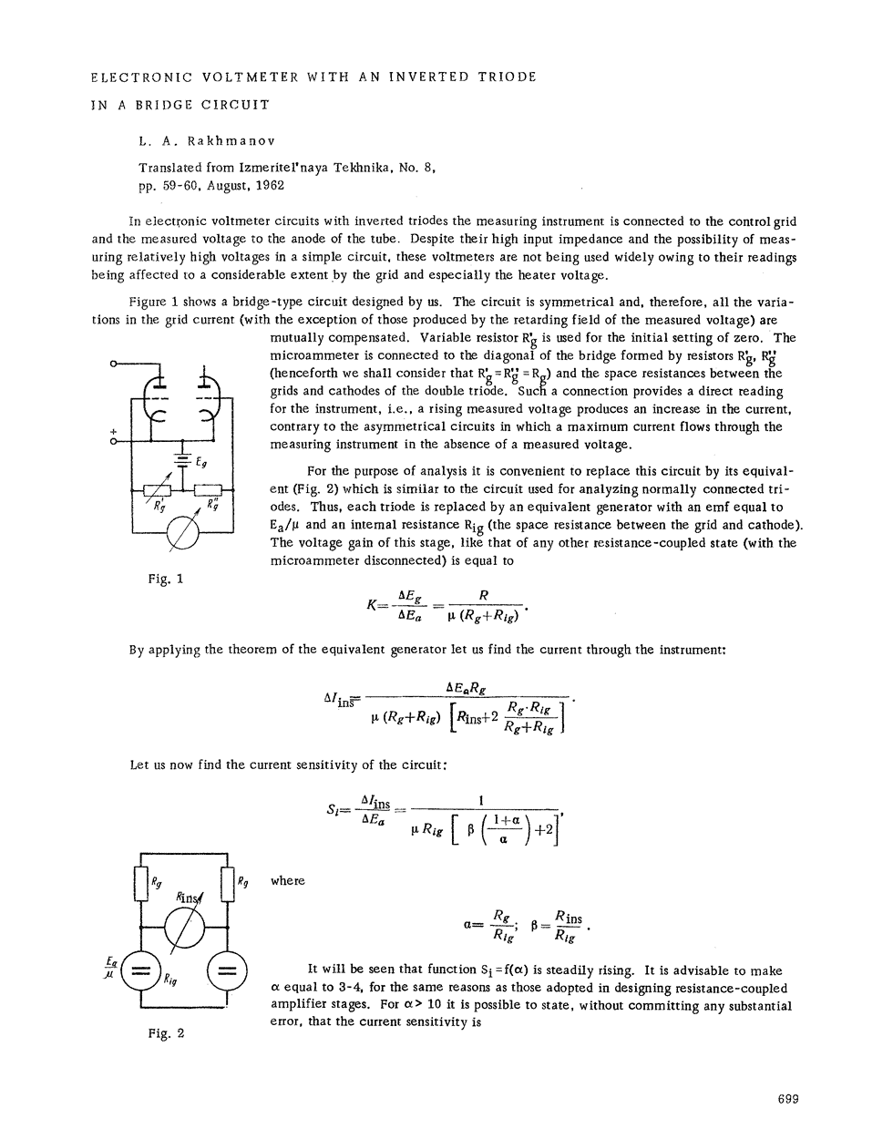

The only infos I can scrape up about how a triode's plate affects positive G1
current: relate to abusing plate as grid, and grid as plate, in "inverted triode"
1/Mu mode. Do you think this is still a relevant model for figuring grid current
when both plate and grid are positive?
SpringerLink - Journal Article
How to fudge realistic G1 currents into Duncan's tetrode model???
I should probably attempt a triode with known A2 grid curent first.
Just incase the link (from a search) turns to be invalid, or preview
some other page later... This was the preview page that I saw:

Hey, if I put CCS into G1, Volts outa be 1/Mu related to screen?
I mean, if the inverted triode model is truly applicable? Maybe we
don't need an external voltage divider at all?
Self inverted triode G1 drive? Iffen it works, think the parts saved!

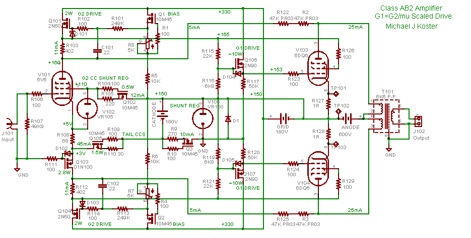

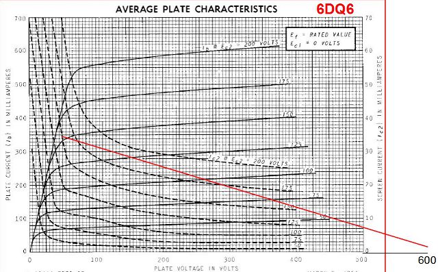

What's that smell?

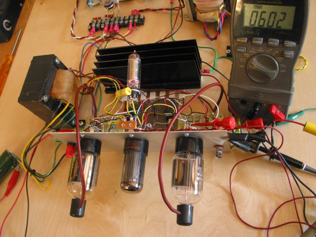

I plugged in the sweep tubes, starting with 12DQ6s, to the scaled drive amp "tester" today and cranked up the B+. With the variac all the way clockwise to 600V of B+ (about 580 under load) I'm getting 67V Pk-Pk into 8 ohms, right at 70 watts Po, at clipping. The only thing getting hot is the load resistor.
So far it's working out as planned, taking about 75V peak on G2 and 17V peak on G1 to reach the point on the G2 plate curve corresponding with 0V G1 and 150V G2. I don't know if G2 is doing 1/2 the work, but the voltage to do a given amount of work is 1/2 when G1 is also driven at G2/mu.
The idle current is 25mA on each side, with about +13V on G2 and -1V on G1 at 600V on the plate.
I'm now investigating a strange kink in the output that starts at about 15W Po (well above crossover) and moves up toward the crest of the sine wave as output is increased. Other than that, everything seems to be working out.
I also have a 600V tap on my ICT that will get me up to 750V B+, but I'm using 440VAC motorrun filter caps. I'll bet they will hold at least to 700V muahahaha
More scope shots to come, etc. as I proceed.
Michael

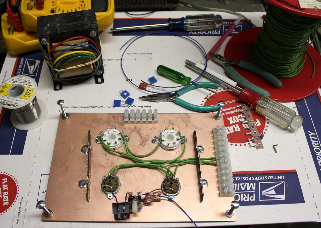

I guess that there is new life in this thread now! The clip lead and turret board furball that I tested in posts 29 and 30 has been stripped for parts. I performed a few experiments on it, and learned a few things, but it was too limited. I have played with Petes red board for several months, learning quite a lot, and discovering its limitations. Many screen drive experiments revealed high efficiency and power output, some tube melting limtations exist there too. As I mentioned in the red board thread, I need a new board, but I don't quite know what it is yet. So, I decided that a little prototype system that could be warped into an amplifier is what I need.
I thought about it for a while and this is what I came up with. It bears some resemblances to yours mechanically. The circuit is totally different. Mine is a cross between the red board and the circuit in post 29 with a mosfet replacing the triode.
Since I am trying to bring together several concepts that I have learned over the past 2 years, and test a few new theories, I call this the "grand unified theory amp".
