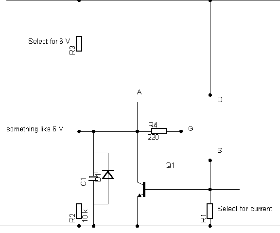

I would find matching Vgs, as follows.Lucas_G said:... just likes to build the Aleph 5 in the best possible way, how can I match these?
I have only got a digital multimeter ...
JH
As a test using potentiometer as voltage source, reguires repeated adjusts and messurments, I tried to make circuit that will work in a more Automatic way.
Select the resistor for 6 Volts, without MOS connected.
Turn Power off.
Select resistor for current. I=0.65 Volt/R.
Connect MOS, and power on.
Put a voltmeter across A - S.
When the reading is stable and does not change any more, that is the messurement to be used. (the temp is then constant, almost)
Turn Power off.

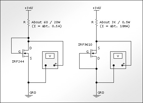

Just use the circuit that jh6you posted, this is the same circuit as used by Nelson Pass and while it has it's limitations, it is perfectly fine for our purposes. Yes the absolute current will vary a little with Vgs, but when the Vgs matches for 2 different MOSFETs, the relative current will also be the same.

If this is for IRFPxxx you need to put the FET on a heatsink to do this unless you want to wait until it is stable at it's own death.
/UrSv
1000mA on irfp240 for 30 secs isnt enough to kill it, i tested them on this current and they were fine.
Fets were matched ok (but you must read vgs exactly after 30 secs if you want proper resoults), because the guys i sold some to matched them again, because they wanted to build a3 instead of a5 for which i was matching them for, and they said that they were already matched very good.
