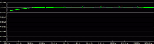

I am just guessing - perhaps the roll off is due to a combination of the other bands and the cathode bypass capacitors - are all the stages fully bypassed? Try putting in really large cathode bypass caps to see if the LF flattens out - no roll off until may be 10Hz to get rid of the sub-sonic frequency.
Jazbo8, thanks for the suggestion. I didn't have any bypass caps, but put some in. Tried values ranging from 10pf to 100uf. Tried just one cathode, just the other, and both. They cut my gain and didn't really flatten the low end.

I think you should have a look at all capacitor in the signal path.
The tone stage forms quite a load.
Perhaps if you use a cathode follower instead (see my schematic).
What is the effect of changing the value of the 100nf dc decoupling capacitor after the first stage, for instance using .47uf cap? What if you change it to 0.047 uf (the effects will tell you something about the impedance of the tone stage at low frequency)

Larger bypass capacitors give more gain not less, do a quick experiment - if you bypasses all the gyrators, do you get a flat response? You should if nothing is loading down the tubes and they both have bypass caps on the cathode. If not, then there is something wrong with your circuit.
Once you have established that the response is flat in the bypassed mode, then you can determine exactly what's loading down the driver and causing the LF roll off. Hope this helps...
Jaz
Ahhh...ok, i changed the 100nf to 1uf. Now i can leave everything flat (i had to boost gain on first band before) and i'm getting a smooth 1.4db/oct roll-off as of 50hz. I should mention that i had changed the cap on the 2nd stage cathode to 10uf - anything low would jack up the low-freqs. Can't believe i didn't try that...thank you.

The easiest way to bypass the gyrators is to disconnect them at the summing node or float them, so the input tube's output is connected directly to the output tube's input without any of them loading the signal down. If you use 22uF for both bypass capacitors, that should get you a very flat response below 50Hz. Sounds like you are pretty there, congrats!

I bypassed the first few bands, overall gain went down about 5db, and wasn't exactly flat. i should just follow your suggestion and bypass all of them....BUT....
I moved all the bands down in frequency and put a 1uf cap instead of the 100n.
Now i'm getting a pretty dern flat reponse (see attached image) and the low end rolloff is acceptable for me.
