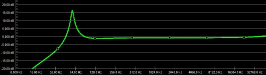

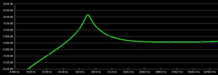

One thing I'm seeing is that when you increase the frequency, the Q changes (it's not as sharp, and is gutting a lot more sidebands) and the overall boost amount goes up too. But down at the low end of what this 'inductor' will do, it's nice and sharp.
Are you seeing this, too?
Attached are some screenshots: All i did was change the frequency pot from extreme low in one to extreme high in the other.

Yes, R.G.'s article the grand-daddy of the EQ articles online (there are many in textbooks though), anyway if you refer to Wikipedia, you can see that the Q is a function of f, so changing the center frequency will effect the Q.

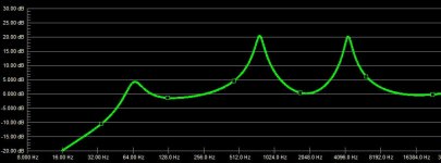

By the way, adding a couple more 'inductors' is working out really well.
Here's a screenshot....
I just wish i could get tighter Q in general. It's kinda gouging out sidebands. I've tried changing value of Q pot and a variety of other tweaks. Anyway, I'll keep plugging away...

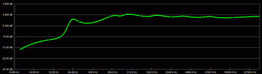

Not sure if anyone can help, but I am trying to get a "flatter" response out of that low-frequency gyrator. I have everything over 256hz "kind of" flat (there are 6 bands now), but this low end has been a bugger. I've tried adjusting all kinds of values, but can't get it quite right. :headbash:
All settings are at half-way (freq and gain), Q at minimum.
Screenshot attached...

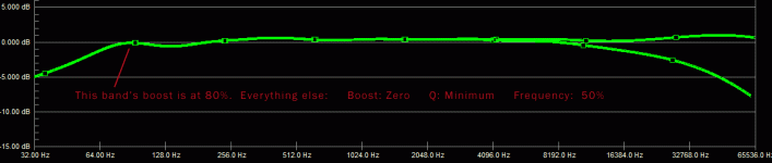

In other news, I figured out the issue i was having. In my endless tweaking, i never put the Q pots back to 10k. Once i did, it 'sort of' worked out.
Attached is a screenshot. I added a LP filter on a switch, so that's what the 2nd line is on the image.
I guess the last issue i'd like to work out before ordering the parts is this: The first (lowest) band needs to be cranked to 80% boost to keep it 'flat-ish'. So, any suggestions from ye geniuses slumming it on my post are welcome as always!
