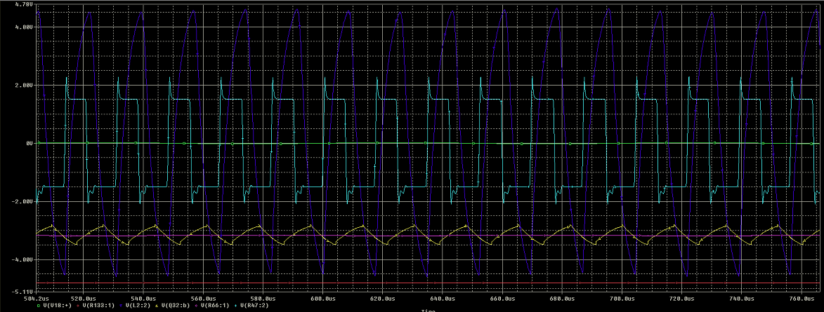

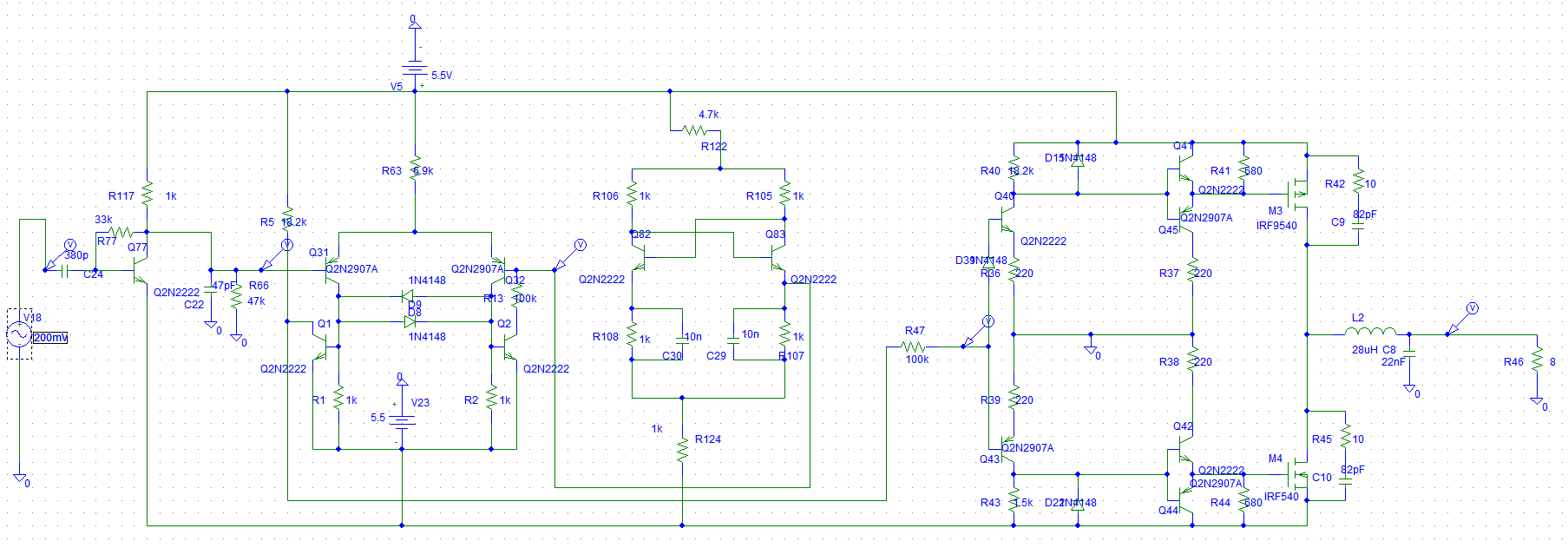

So I've still been working on this project (lol no choice but to work on it to graduate!) and I've finally got it to the point where I can actually hear music through the speakers!
What I noticed before is that audio from headphone jacks give very little voltage so I had to throw in a pre-amp in there and mix matching the right caps finally got something going!:wave2s:
Attached are my up to date schematic and here's a video of it in action (here)
Sound quality wise, it seems to sound nicest at about 5V. When the music becomes more heavy the higher tones seem to sound less appealing (symbals specifically on the drums) Any advice to make this better? To be honest, I'm just happy it sort of works lol

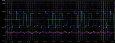

It looks like your M3 does never turn ON properly.
In order to get symmetric signal magnitudes to the your input of the switching stage you should chose R5<R47.
Background: Q40 is turned ON from +8V through R5+R47, while Q43 is turned ON from -8V through R47+UcedropofQ1.
Give it a try and check if something turns better when you change R5 from 100k to 18k.
In fact you have chosen very high values for R5 and R47 anyway, so in a second step slowly reducing their both values might be a good idea.

...how do you conclude these things X_x?
In your SIM results I saw that the signal behind the switching stage is not going high. So I concluded M3 never turns ON properly.
Consequently I started to look what in the circuit is different of driving M3 vs M4. This leads you to Q40 and Q43 and their base drive.
If you want to have the available base drive currents similar you have to fullfil:
abs( 8V / (R5+R47)) similar abs (-8V + UcedropofQ1) / R47)
abs means 'absolute value of'
Now guess Ucedropof about 0.5V
==> 8V / (R5+R47) similar 7.5V / R47
This would lead you to an even larger ratio of R47 vs R5,
but I did not want to have R5 to low, because also the gate drive of Q1 is weak and its capability to pull down R5 is limited.
Furtheron when looking to typical properties of small signal BJTs, you will find that your drive impedances are pretty high for driving them at reasonable speed, that's why I additionally proposed to reduce both in second step.
How much you can reduce R5&R47 is limited by the pull down capabilities of Q1. If necessary - in a third step you could reduce R63 to extend amount of possible impedance reductions.
A fourth step might be a DC adjustment.
Without that you most likely will have a high DC component at the speaker.
Adjustment is possible through variation of R77 and/or R117
A fifth step could be asking your tutor why he expects that you would able to debug his circuit. ...just a guess that the circuit is from him.. ;)
In case step5 bears risks for your graduation, skip step 5 or schedule it after you have passed your graduation.

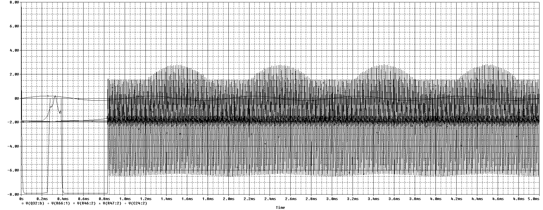

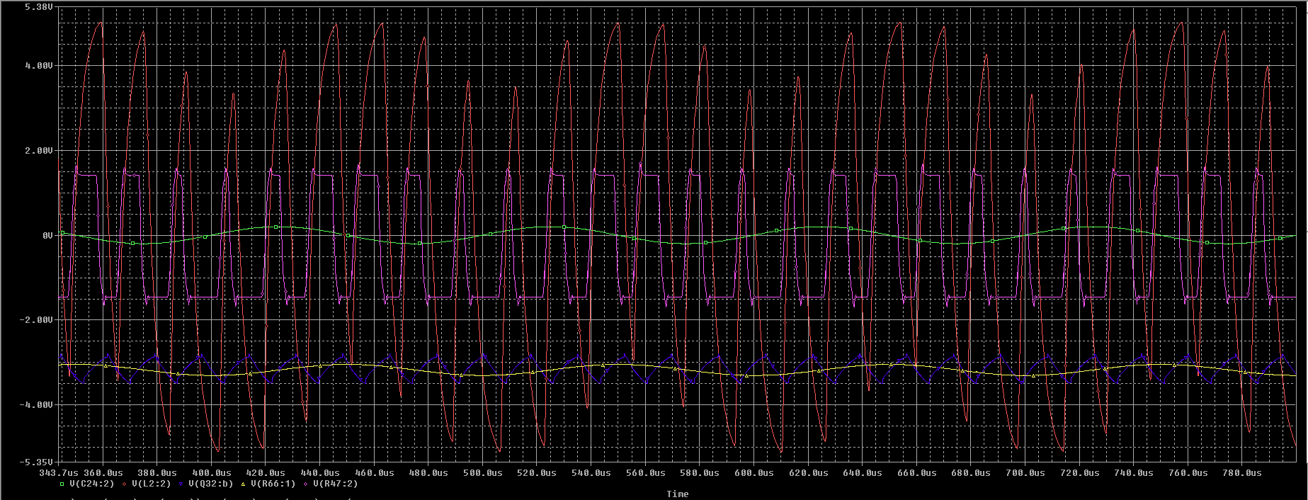

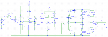

I've taken all your input into consideration and here's my updated schematic (attached.) R47 since R5 is 18.2k should be roughly 180k but for some reason it just doesn't sound as clean as 100k. Changing it to 47k also had more distortion as well X_x.
It's really weird though because at 5V it plays fine despite the lack of some bass and weak volume. BUT once I wrap my fingers on the top of C24 the audio gets louder AND I get a much cleaner bass. :confused: I felt like I had magic hands hehe. Though I'm not sure how I can keep that bass and louder audio without touching it. :eek: That's my next goal.
Here's a video of what's happening HERE

The low volume and poor bass is fitting to your input gain stage values.
In simplified view the gain of the input stage is defined by the impedances of R77 and C24. C24=380pF has a high impedance at audio frequencies and furtheron shows a 1/f impedance, which increases the gain of the input stage towards higher frequencies . When touching a 380pF the way you did, your fingers form a parallel impedance to C24 and change the transfer function of the gain stage.
Try to substitute C24 by a series connection of a cap and resistor.
Reasonable starting points would be 1uF (towards the signal generator) and 10k (towards the base of Q77).
R47 is already pretty high with 100k. Going to 180k results in weak driving signals for your gate drive circuit.
The ratio of 100k/18k should be OK.
You could try to step down both in small steps and search fro an optimum.

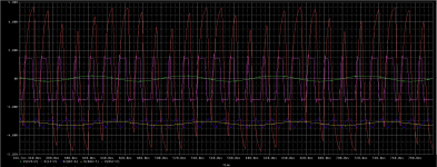

It's sounding as good as I can probably make it right now and I'm off to step two and soldering it on a board. Here's a video to show where it is now (here).

Your output filter doesn't filter much.
The amount of HF at your speaker is so huge that it might already be stress for the tweeter.
You have a low switching frequency and a fast filter - not really fortunate.
When changing the filter, take care not to place the filter resonance close to the switching frequency....

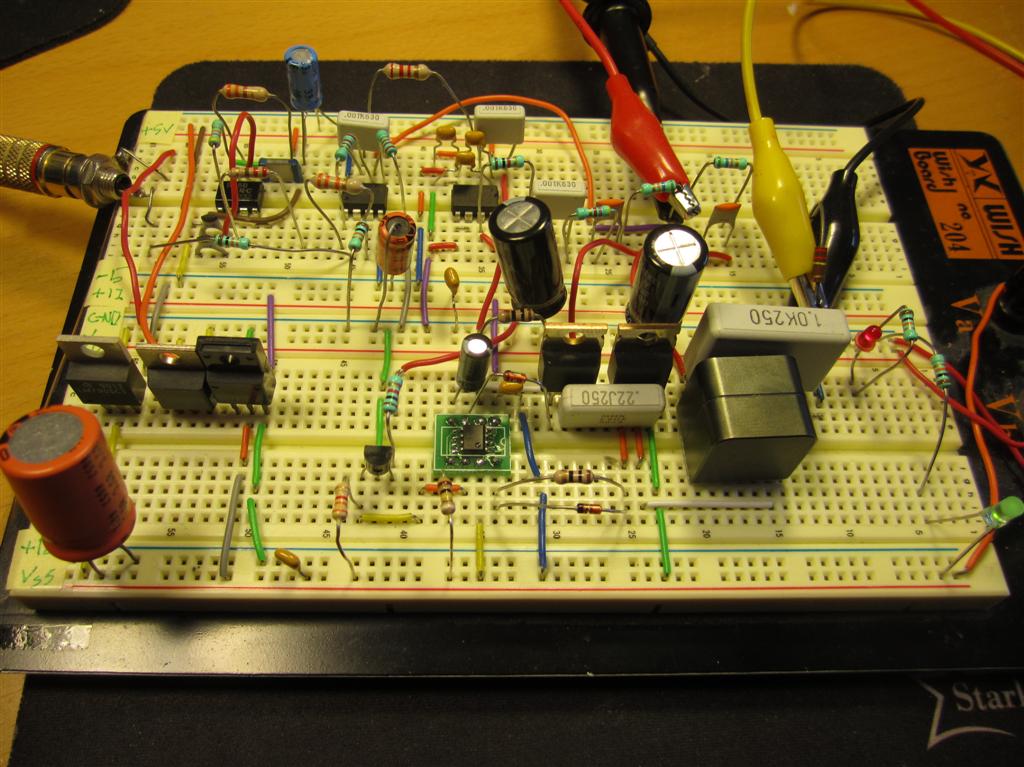

Breadboard
Hi darkamikaze
Good to see you are up and going. Just a small trick, when starting up a new design, I always start on a bread board (see picture). It can actually work ok for first test and to make sure the design is ok (don't use high voltages and high currents on the bread board though). This makes it extremely easy to change component values and get the first shot right.
Then I go directly to prototyp on two layer pcb .... it's just so cheap to get manufacturednow, that nothing else makes much sense .... though there is some waiting time though :)
I have now sifted to ITEADStudio for pcb manufactory, and are waiting on my first batches. (before i used Olimex).
Keep the good work up.
Baldin :)
