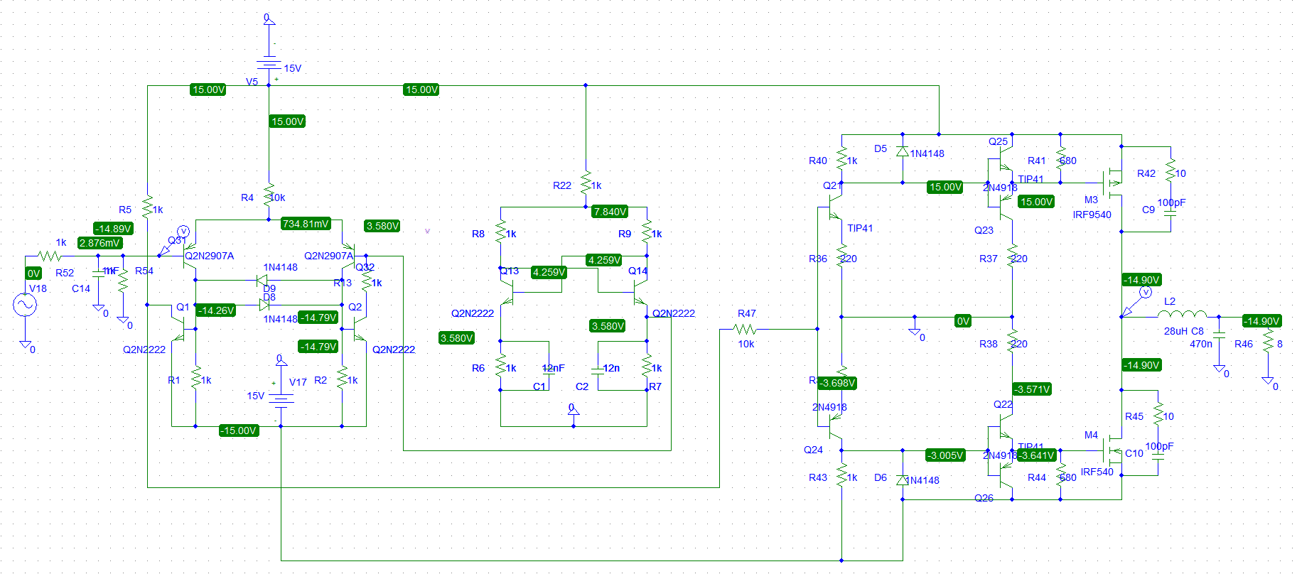

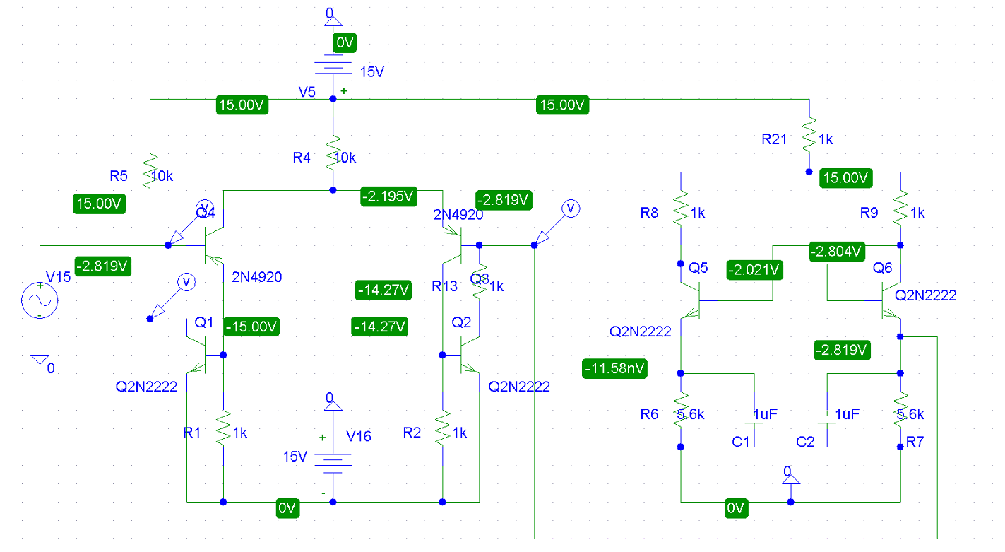

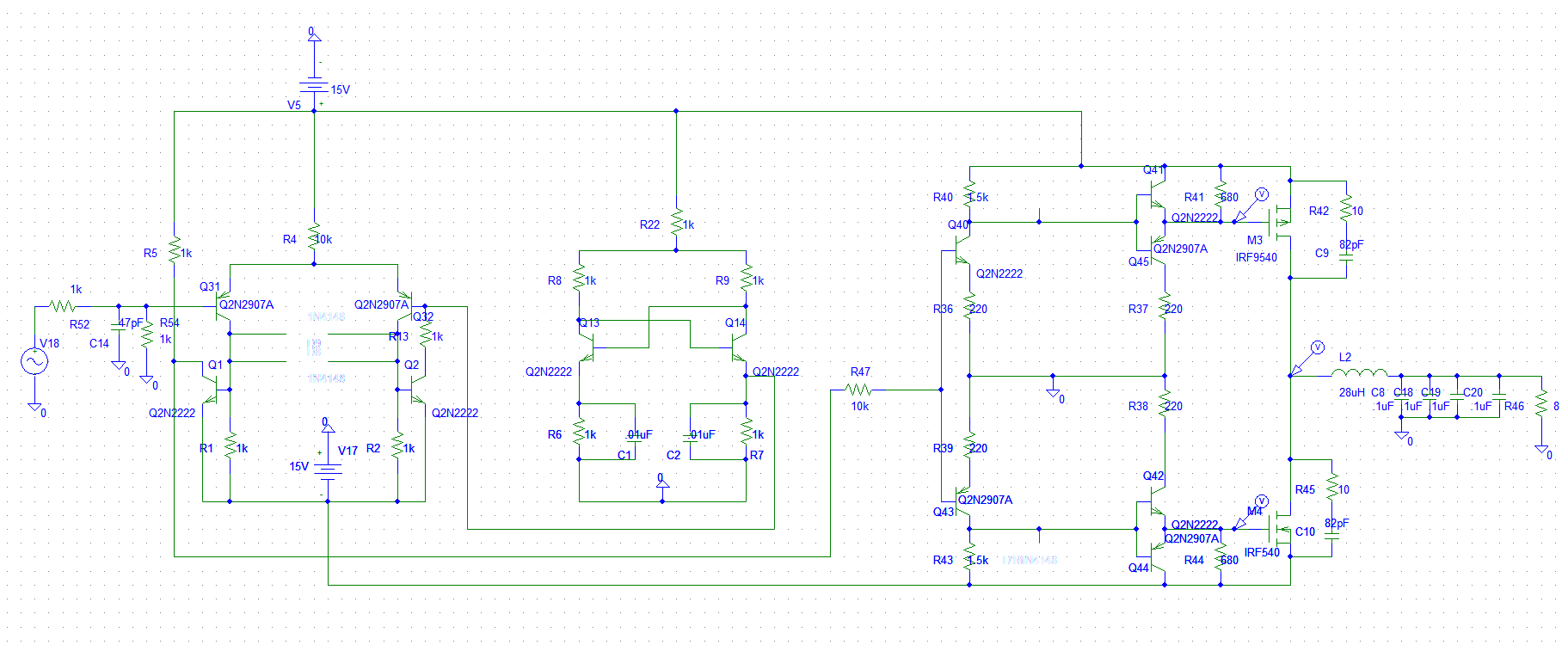

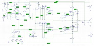

I was able to create a small differential amplifier to act as a comparator and a triangle waveform generator with all discrete components (See attachment.) So far my pspice looks promising and to be honest this is as far as i've gotten X_x. (WIP! :eek:). Any opinions or advice? I'll try to somewhat, log my progress and hopefully be able to have fully functional discrete class D further down in time. Thanks!

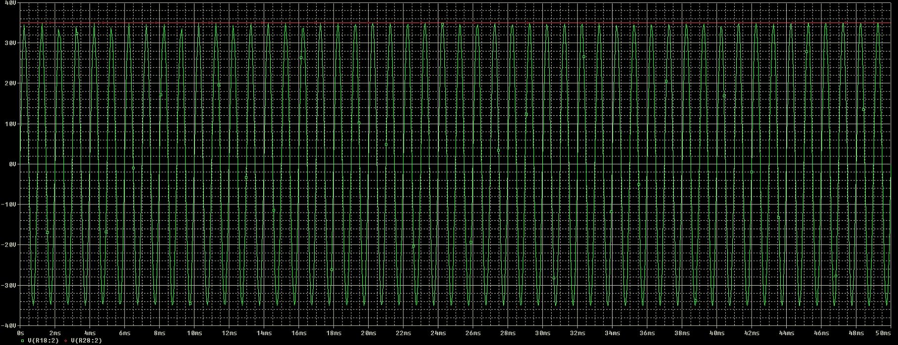

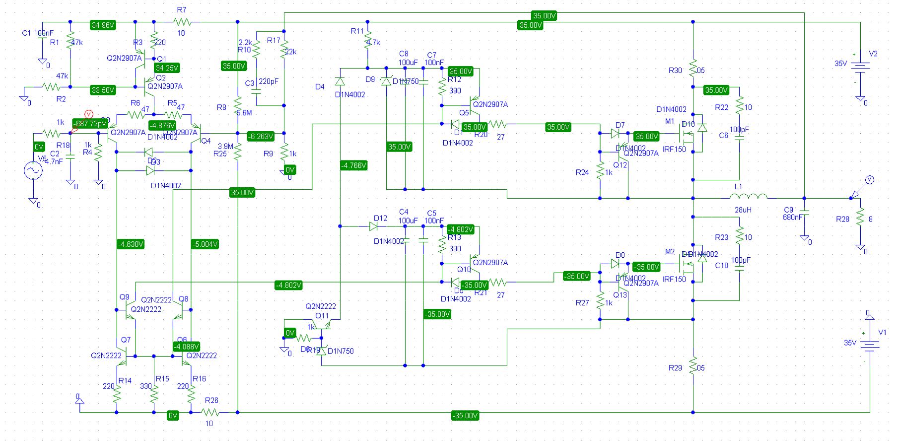

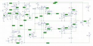

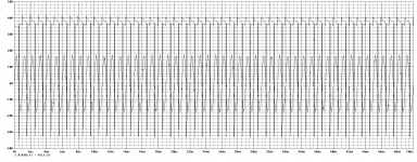

I actually tried to PSPICE the Philips UCD but my results were a little odd. (See attachment) It seems that my output was always the Vcc/Vdd of the circuit. It may be because of the parts I chose but those were the only ones available to me in the student edition? Or something in my setup is wrong?
Also, I don't understand the Philips one so well X_x I can't tell what part is the comparator or if there's a triangle wave generator :confused: I made a circuitlab.com of this as well found here. :p for reasons I don't know why since it compiles REALLY slow online

I too got same prob with philips amp but no worries buddy.. Its the problem that your negative switches are unable to get the bias 12v supply....just check it out and dont use powerful transistors...use high voltage low power transistors only.....and set the freq and dead time properly...
I guess it will start up, when you define the initial condition of C8.
Put its innitial condition to 12V (or -12V, this depends on your chosen orientation during placement of C8).
@stinius
Thanks I just noticed that as well but it didn't seem to make a difference in my simulation X_x
@sweetperfume
I'm not sure :eek: but on PSPICE my output is always 35V as shown in my attachments in post 5 X_x. It's also hard to understand parts of the design as to what they do :/

in your schematic please replace all diodes with high speed ones e.g 1n4148 and d4 and d12 make sure you use mur120 or uf4007 to be on the safe side.
q11 use tip41 or bd139 .
http://www.diyaudio.com/forums/atta...ly-discrete-class-d-amplifier-wip-capture.jpg

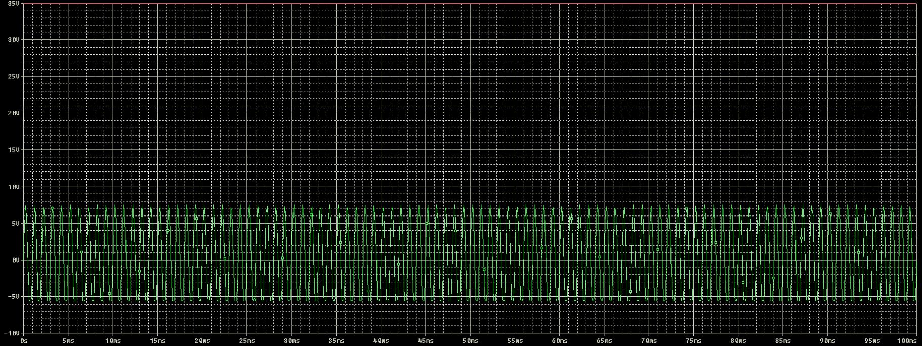

Just finished swapping out those diodes with the ones you requested. I still feel like I set something up wrong since my output is always a constant 35V or is that how it is on transient solver?:confused:
:eek: anyways hopefully tonight I can mess with it more and figure out what I can do. Thanks

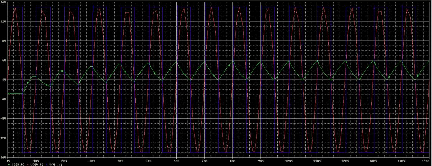

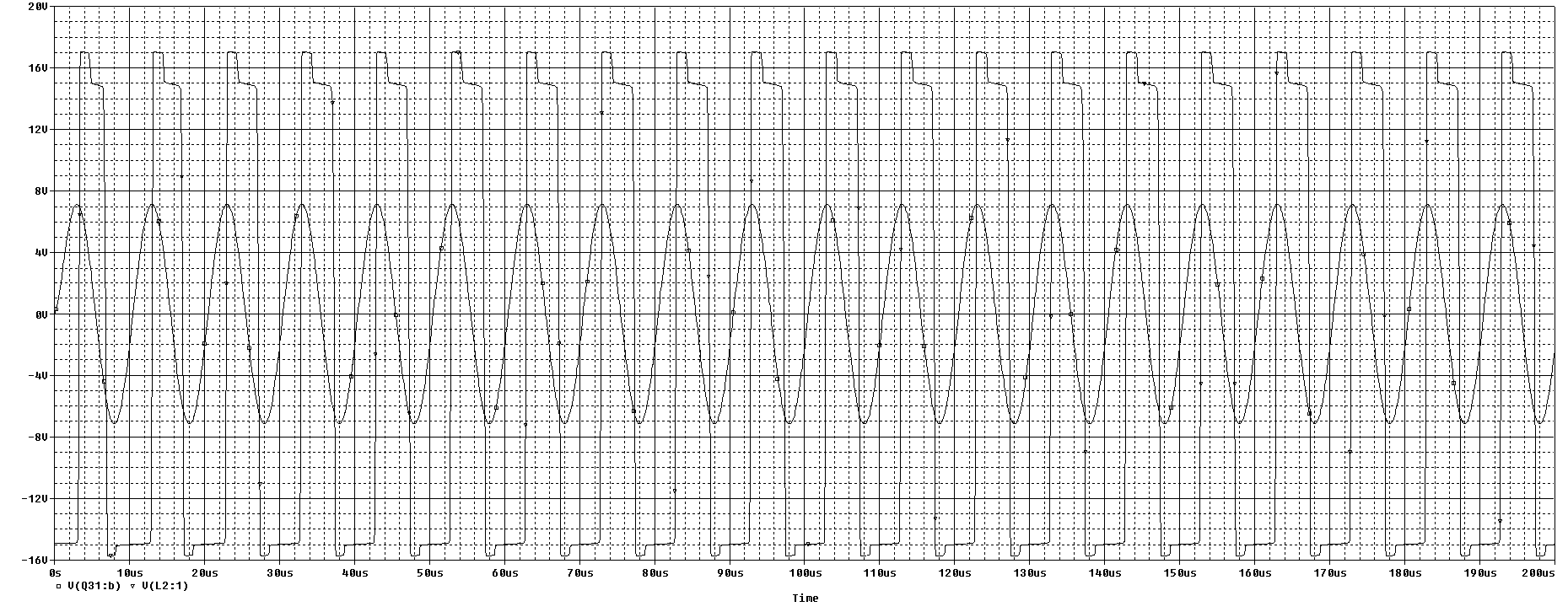

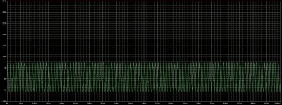

Alright, so I've been working on my amplifier again and also a replicate of the Phillips UCD.

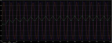

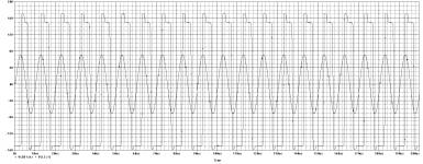

I think I figured out why my output is always just my power supply voltage. I've been taking the voltage reading AFTER the inductor as opposed to before it. (Attached is the results of taking the readings of input v. output before inductor. The Philips UCD schematic is attached a page back.)
I also have my own class D design going as well which is attached below (2nd picture. Results 3rd picture) Let me know what you guys think! The driver portion of the design was taken from diyaudio's very own stewin. Thank you very much and I hope it's okay X_x.
I still have to figure out how to tweak it so that it's in line with my professor's specifications but I think this is a start for me :eek:.
