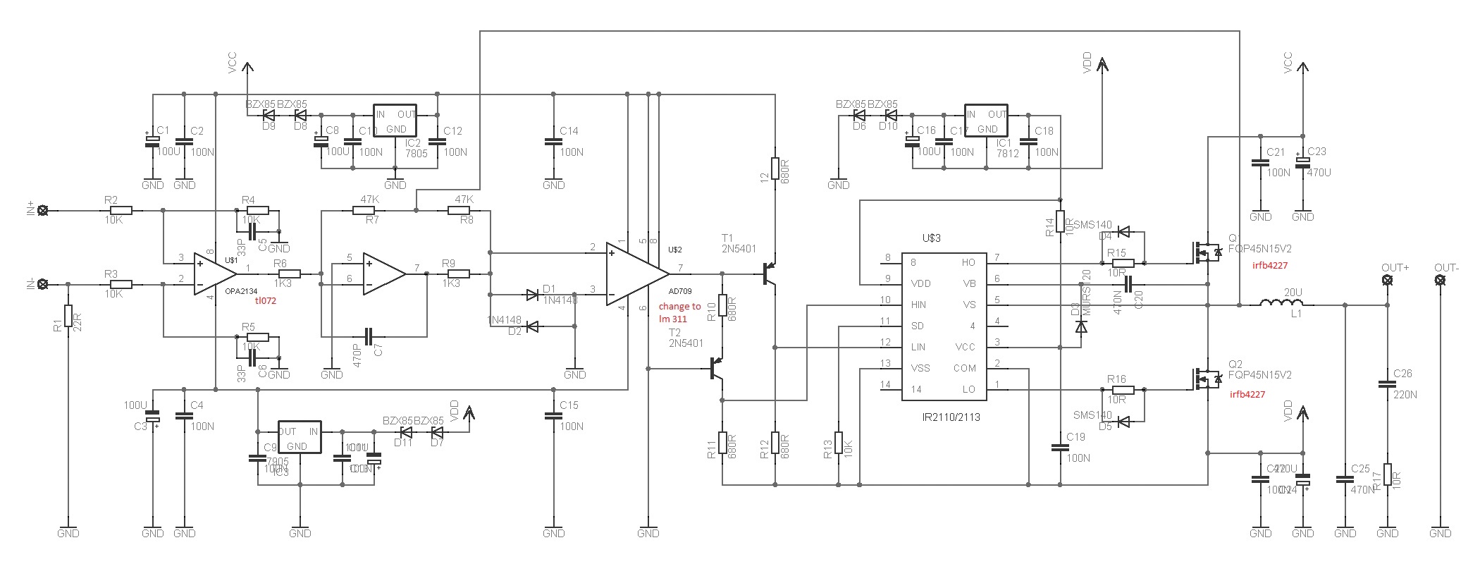

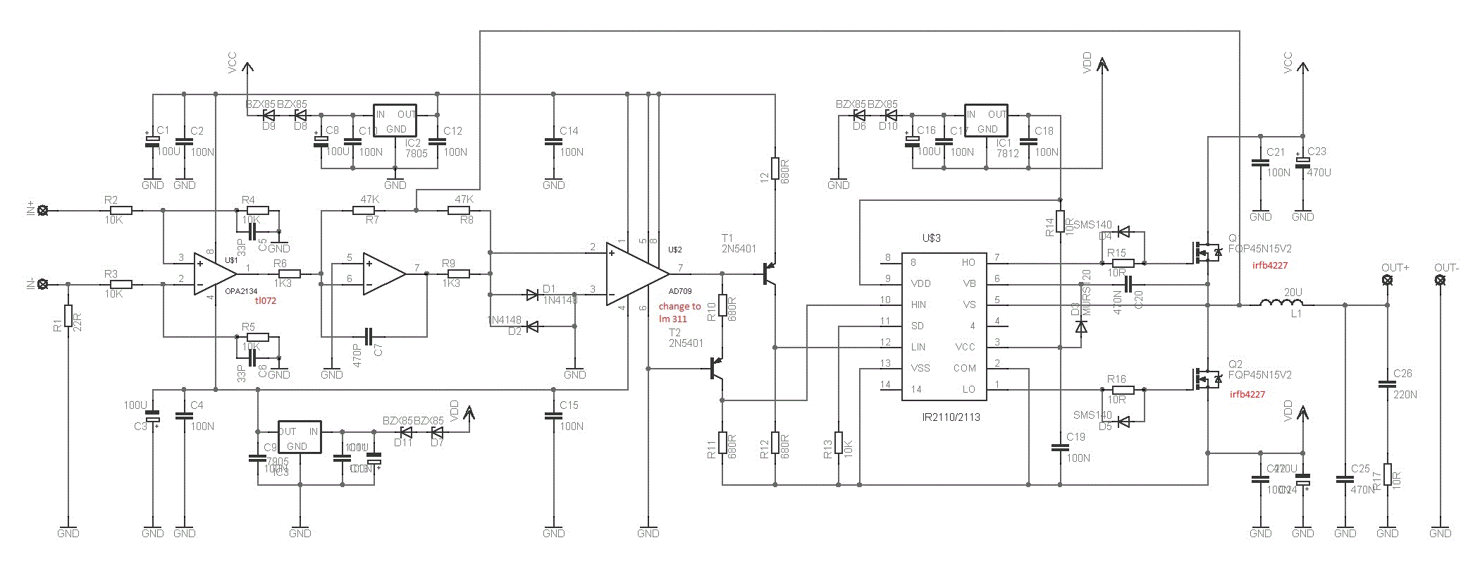

hi pafi will this circut work comfortable with +/- 85vlts with a 2ohms load ?? outputs fets are irfb4227

85V and 2 ohms is possible for irfb4227, but no headroom, and there is no protection in this sch, and
- I can't find the gate driver PSU (not on schematic)
- bootstrap voltage is not hold correctly during positive overdrive. 3 ms max, it is dangerous.
- turn on is very slow. Good enough only for bass.
- clipping point is much lower for negative.
- Opto pairing is not indicated. :-(
- offset voltage setting is terrible.
should I continue checking it?

yes i would really appeciate that , because according to the author this circuit is compatible with many different fets
What does it mean? It works the same terrible way with any of them?
Why do you care a dangerous and bad quality design with missing parts? The one in the first post of the topic http://www.diyaudio.com/forums/class-d/166214-ucd-25-watts-1200-watts-using-2-mosfets.html is much better!

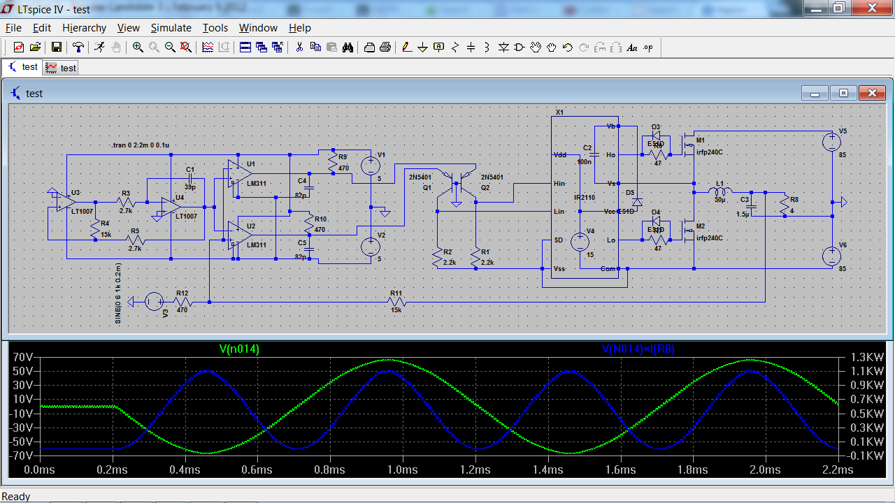

thanks sir pafi for the quick reply .i wanted to use ir2110 , irfb4227 fets at +/-80vlts at 2 ohms . i wanted an effecient stable design which will not fry the fets for no reason.
o.k then is this tekkos design with two lm311 nice ??

Not really. The feedback is inefficient, it has visible distortion. No protection, high DC offset, etc...
Chocoholic had a public design. I am sure it is 10 times better.

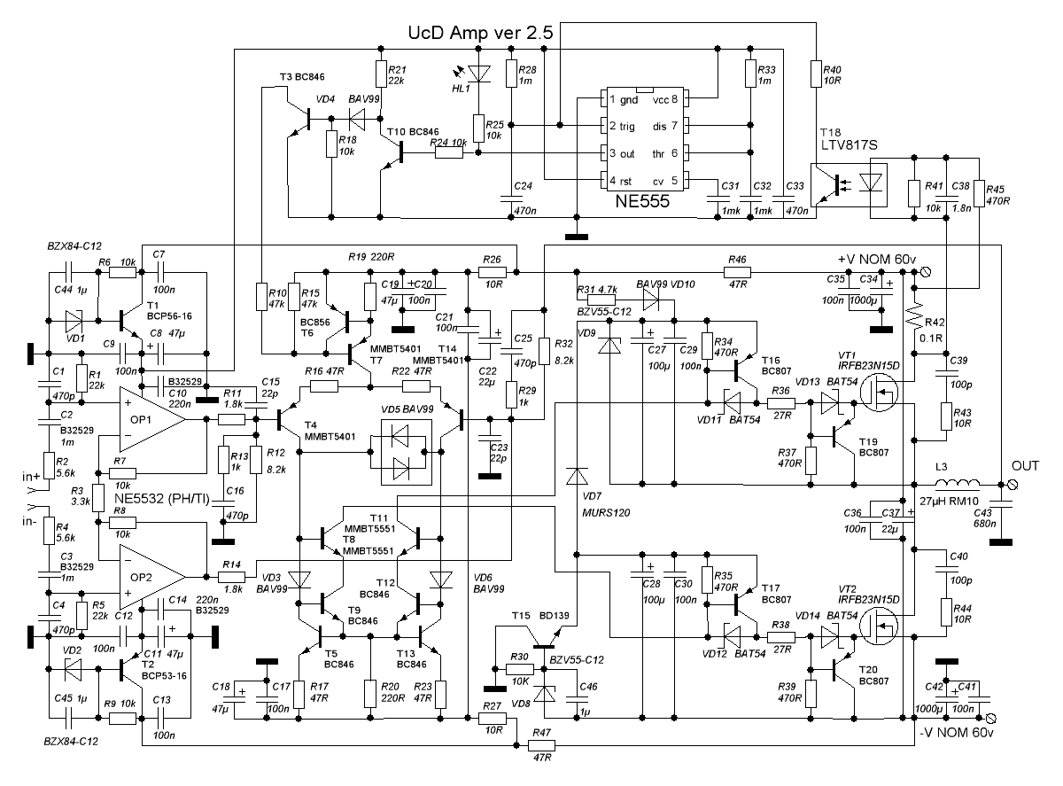

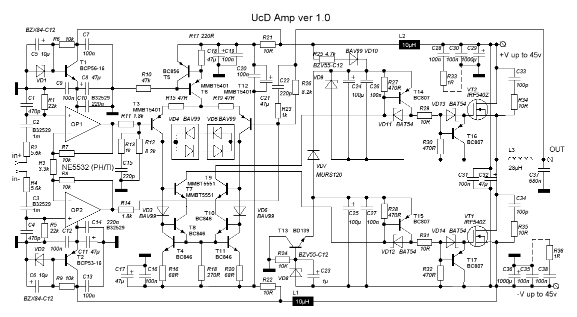

thanks paffi for the quick reply ,let me perfect on designing high speed, Low EMI PCB . hopefully i,ll design a custom board for discreet ucd i found it sounding the best except layout issues.
