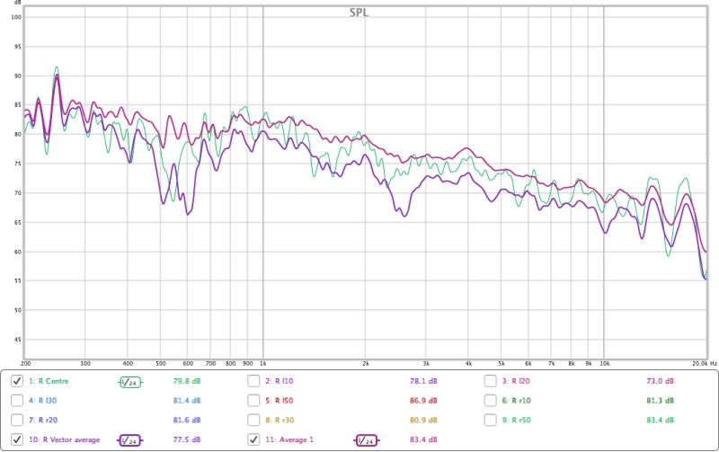

Averaging across the couch and correcting will result in better, but not the best, sound in those positions where it was measured. Measuring just at one place and correcting will result in the best sound at that position, and may or may not improve it elsewhere (depending on speaker location and directivity). You takes your poison, and you lives with it! I personally could care less how it sounds at locations other than the listening spot because for more 95% of the time it's me and me alone doing the listening. And the remaining seats are not that bad either. All of the above is especially true about the low frequencies.
The more consistently the speaker measures in an average the better as far as I am concerned as it will sound more even across that area than one that varies significantly. Fortunately the arrays seem to do a good job of that. Wesayso has shown a very good correlation between an average and single point measurement in his thread. In my measurements the room is more of a factor and the averaging helps to not overdo the correction in general and gives a more quasi anechoic response to work from.
I agree in general with what you say which is why it important to look at all the graphs in the average to see if the sum is a better representation. The benefit to the averaging is that you can apply a stronger correction without the risk of making it very position dependant. Depending on the results it might still be better to use a single point. I don't often sit directly in the centre as I have a large two seater couch and right in the middle is not so comfortable and harder to recline
For me, measuring at one spot has worked quite well, though I've always manually dialed down the DRC (possible over) correction at certain spots. This is what the averaging does automatically.

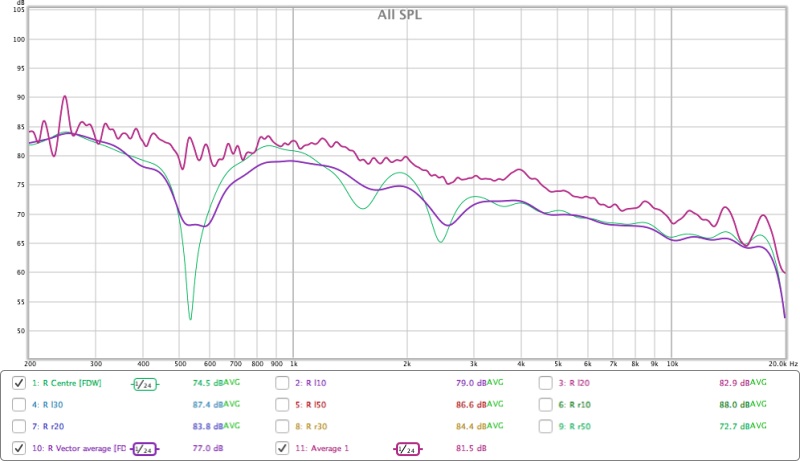

We do get effects of comb filtering at the single measurement position. Letting in surrounding measurements will filter out the few peaks that could emerge from a single spot correction when one isn't exactly in that measurement spot with the ears.
These comb patterns are not really seen in the FDW from REW except, maybe in the clean outdoor measurements done by fluid.
We do still see that comb behavior in the early waterfall plots.

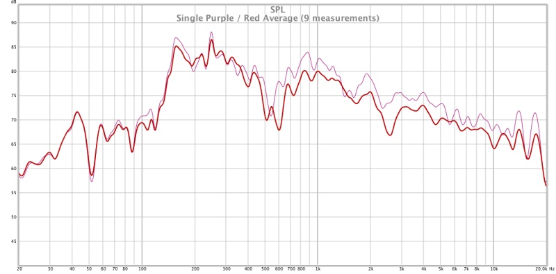

I've done a series of measurements and first will correct based on a multi seat set, but I can also choose to only use the ones that correspond best with the left and right ear position (with some wiggle room included).
I like these options to try and see what works best, one could measure exactly at the left and right ear. I know jim1961 does exactly that in his room. Up till now I've always used one single spot. With the series of measurements I have proven (again, as I had done this once before) the consistency of the arrays over a larger area. But it also gives me more options to try later on.
FR and phase of the single point measurement is in close agreement with the center point measurement, it has one other advantage though. It is more free of reflections, just as fluid said. You get closer to viewing the speaker output without the reflections that are very place dependent.
You can't easily filter out those from a single point measurement. Move just a cm and their influence will change. This is why my results are pretty close as I did try to absorb as much of the early reflections as I could.

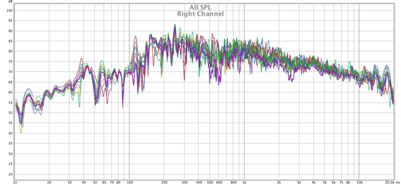

I've been making steady progress behind the scenes and getting to enjoy listening to the speakers a bit more.
I took some new measurements after the position change and they are an improvement.

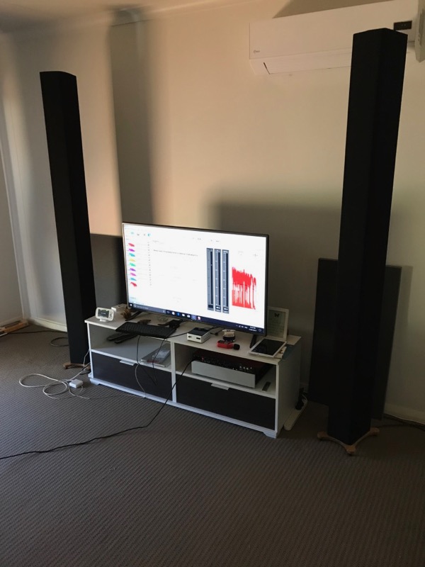

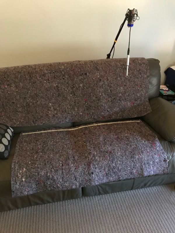

Here is a picture of the mic setup, I read a write up on a minidsp where there was a description of the setup and it made sense to me so I tried it. It has helped to clean up some of the very early reflections I had before which were coming from the couch.
miniDSP DDRC-22D Dirac Live® 24/96 Room Correction Audio Processor Review - Home Theater Forum and Systems - HomeTheaterShack.com

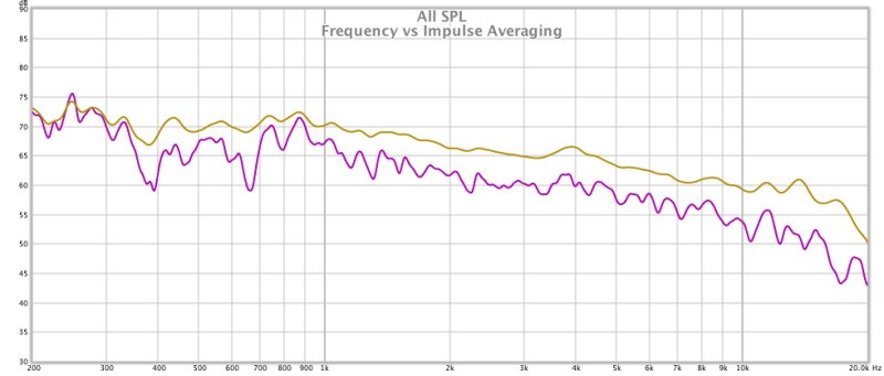

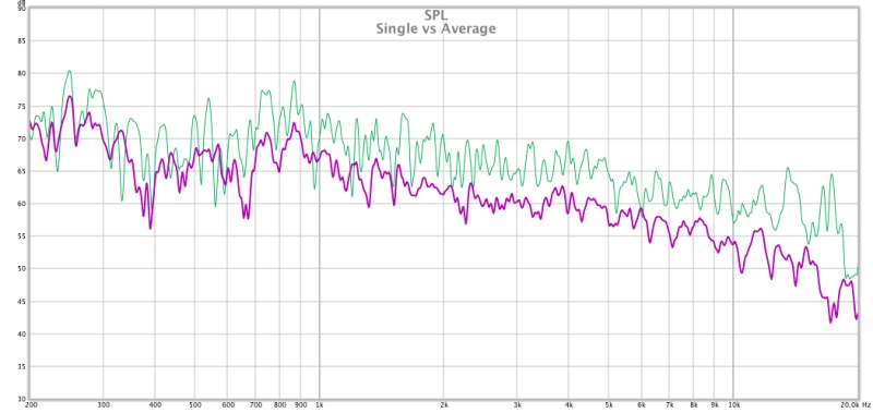

Here is a comparison measurement for samuelj, indoor vs outdoor. The SPL should be fairly accurate but as they were not taken with the same equipment at the same time there could be some variance. The outdoor was also directly on axis where the indoor is slightly off axis. There is the expected 8dB or so rise in the low frequencies from 100Hz down. The main modes at 44 and 88 are obvious and a dip which can't really be avoided easily. Much better overall than what I had before.

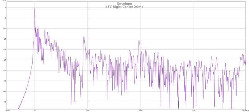

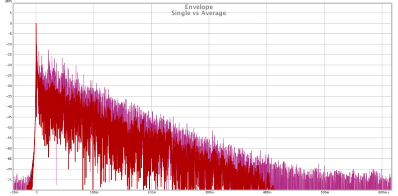

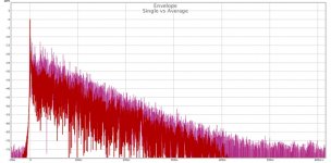

This ETC shows what happens due to averaging, you can see the level of room contribution goes down significantly. This measurement was an average of nine positions. The more averages the more the room is suppressed but it does take a long time to record them. I think 9 is about the sweet spot for me.

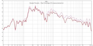

This the SPL difference in single vs average for one channel

Se you have a reflection at -13 dB ETC that is close to the main lobe.
Is this the backwall reflection at about 16cm from the mic? So extra pathlength is 32 cm and that reflection will cancel wavelengths of 64 cm.
That is about 530 Hz.
Then the ETC should show an energy burst at a little less than 2 ms after main lobe.
The avaraging with different lengths to backwall and broader dip also suggests this.
If this is the case be very carefull about have an EQ top at 550Hz. That EQ top will also attunate the back wall reflection where it maks most damage.

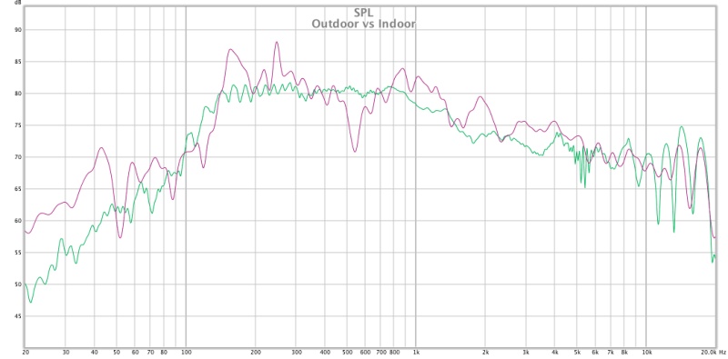

A last issue is the overlay between outdoor and indoor measurement.
I would be suprised if you have 5dB room gain from 800Hz to 4k Hz.

A few comments, fluid:

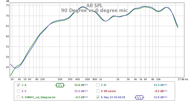

- That mic setup looks strange to me. The mic response is not omni as far as I know. It will have a very different response pointing downwards compared to pointing towards the speakers.
- What is the material on the couch? From the pic, it looks like a felt mat. That's going to absorb only the very highest of frequencies. You need at least 2 inch thick fiberglass/denim style insulation on there to have a meaningful absorption in the mid frequencies. 4 inch thick is better.

- The dip at 550 Hz corresponds to about 2 ft. Is the speaker to front wall distance about 1 ft? What happens if you push the speakers right up against the front wall?
- I don't see how the room is suppressed. If the room were suppressed, wouldn't your averaged chart look smoother, i.e., less wiggles? If the reflection levels go down, it should look more like the outdoor chart.
- Finally, it is hard to believe the sub-100 Hz response in the averaged measurement. If you measured across the couch, there is no way your sub-100 Hz will be identical to the single measurement. Something is off there, could be the mic, could be something else. Probably worth investigating further.

Well you saved the best for last I am also quite pleased with the result but I'm not sitting as close to the back wall as you think (there is 1m).
The mic is most certainly omni and the 90 degree position is the position the manufacturer uses as part of their own room measurement/EQ solution. They only supply a 0 degree calibration file but it isn't that hard to make your own 90 degree file I linked the article I used to do it earlier. The difference is really only at the highest frequencies.A few comments, fluid:
The reason why I use a 90 degree position is because I don't have to change it between measuring the Left and Right speakers. It is very hard to consistently place the microphone tip in exactly the same position when changing the angle of it. You might have a wizz bang mic stand or some clever method of doing it. I just found it frustrating and inaccurate so I don't bother.
This is a comparison measurement of the supplied 0 degree calibration file dead on axis versus the mic at 90 degrees with my generated file in as close to the same position as I could line it up. I am happy with the tolerance. If you use a minidsp UMIK they provide generated 90 degree files too although I can't vouch for their accuracy as I think they just introduce the same offset into the original calibration file. Try it for yourself and see.
The material is felt about 10mm thick. You are quite right in your description of the type of absorption needed if I was trying to kill the reflection.- What is the material on the couch? From the pic, it looks like a felt mat. That's going to absorb only the very highest of frequencies. You need at least 2 inch thick fiberglass/denim style insulation on there to have a meaningful absorption in the mid frequencies. 4 inch thick is better.

I will try and explain it. Look at the ETC. You can see that the red level is significantly below the purple in both level and how long it lasts for. That means there is less energy for less time ergo less room.- I don't see how the room is suppressed. If the room were suppressed, wouldn't your averaged chart look smoother, i.e., less wiggles? If the reflection levels go down, it should look more like the outdoor chart.

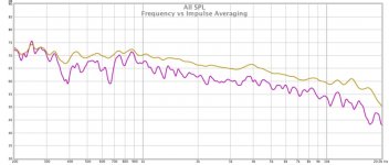

The averaging I have shown is impulse response averaging so it can be used with DRC. This is different than pure frequency averaging and gives a different response. Here is a comparison of my first measurements above 200Hz. There are 22 measurements used. The gold is pure frequency average, nice and smooth, the purple is impulse average, not so smooth but you can see that the room contribution has been reduced as the level above the transition frequency is reduced more and more as you average more measurements.

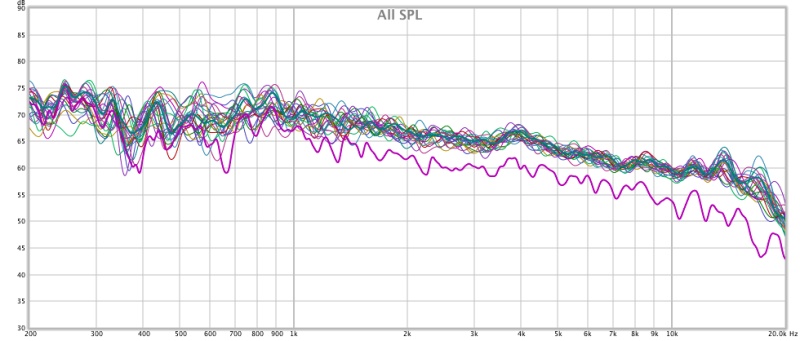

This graph show a single measurement and the 22 measurement average at 1/48 smoothing. You can see that the average has a lot less of the small wiggles which are the result of the position dependent room interference in the single point.
What I am trying to achieve with the impulse averaging is a more quasi anechoic response that includes the most prominent room induced peaks and dips which are not totally position dependent. That is why I have settled on using 9 averages. The image below shows all the individual traces together with the vector average in purple. You can see that the frequency average lines up in the middle of the traces and the impulse average has the room contribution suppressed. When I compare the RT60 of my room to these graphs it makes complete sense.
For me it's not hard to believe and nothing is off. What that graph showed was that the centre position is very close to the average nothing more. Don't worry there is much more variation across the couch but still pretty well controlled. That is what I like about using the arrays full range. The bass is very even. Here's the graph to show the variation.- Finally, it is hard to believe the sub-100 Hz response in the averaged measurement. If you measured across the couch, there is no way your sub-100 Hz will be identical to the single measurement. Something is off there, could be the mic, could be something else. Probably worth investigating further.

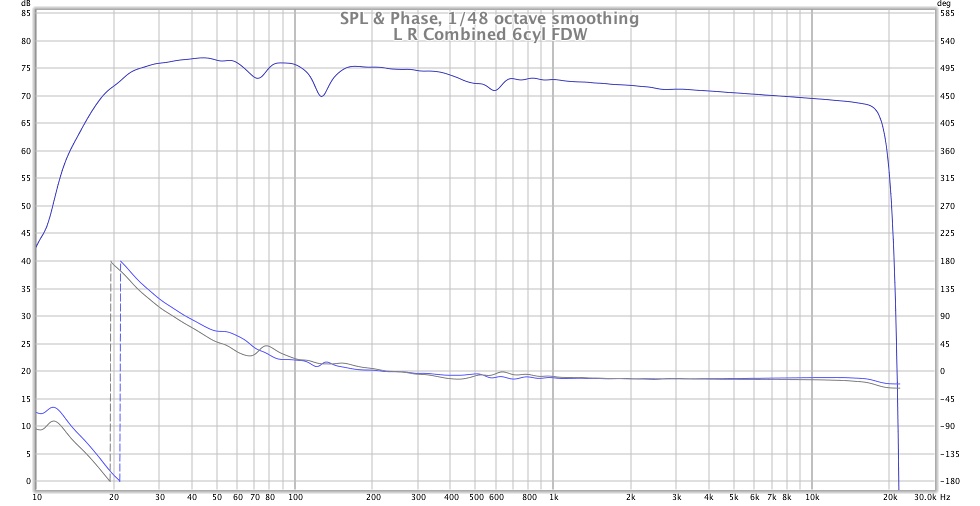

Hello Fluid,
Thank you so much for sharing the room gain curve as I was very curious about that I am baffled how it is so close to your predicted/simulated curve. There seems to be some low Q dip around 100-150Hz. For room gain study purpose, I will consider a smoothed out version of the indoor curve below 80Hz. I was concerned about the 1-4k gain, but then the average response takes care of that.

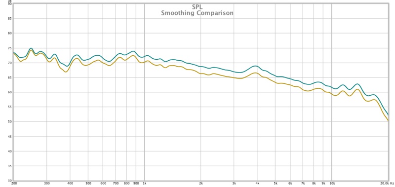

I assume you have used FDW of 1/6 for the indoor measurements or am I wrong?
I guess you are still playing around a final curve for your arrays that you can settle down with, hope to see that soon.
This is really interesting. Can you please tell what gating/window you are using?
Based on the same measurements, just varying the averaging method you get curves with a significant 5dB difference. So, which one do you use to get the ideal psychological flat room curve. If I am not wrong, the final curve that Wesayso shows is based on frequency averaging.
REW has only recently come up with impulse averaging, which seems awesome.
But a target curve based on that might be too hot in the HF area.
My original correction was based on single point measurements. Over time I have reduced reflections in my room trough adding damping panels in key locations. (first reflection points)This is really interesting. Can you please tell what gating/window you are using?
My latest graphs were based on IR averages. Inspired by measurements from Fluid and I always wanted to compare those two methods. The center point measurement has a very close resemblance to an 8 point average along my seating area. However since I have reduced reflections I only took 4 averages into account for my current experiment.
A weighted average around the left and right ear position. Not a FR average, an IR average to be able to use it with DRC.
Phase curves of this average and my usual center measurement are spitting images. For all practical purposes usable enough to use for DRC processing.
Hope that helps.
You're welcome
It is fairly easy and accurate to predict modal behaviour in a room as long as it is a rectangle of some sort. Everything is based on the dimensions and the distances from surfaces. I found that by using the mid point between floor and ceiling in the REW simulations was pretty close to reality. I have found the array's work best in positions that most conventional speakers would not in my room.
No FDW used on any of those graphs. I look at the measurements through all the different levels of smoothing and windows to get a better picture of what is going on. 1/12, 1/24 or 1/48 were used in the above graphs (not including the microphone comparison that was 1/3).
I'll show the DRC predictions in another post to not confuse this one.
No gating or window has been used at all.
In the graph you quoted the impulse average had 1/24 smoothing applied and the frequency average was 1/12. When I went back to check the frequency average was computed with the individual graphs at 1/12 smoothing. Removing all smoothing before averaging gives a slightly different result.
This graph is the difference between the average being done on smoothed measurements first or raw and then smoothed after. The shape is the same but the level drops. The best way to compare would always be to do the averaging on raw data. The higher (green) line is raw then smoothed.
The impulse averaging is like a semi anechoic measurement but with persistent room influence added. The right room curve is very personal but I also think that the RT60 of the room is a good guide as to what to expect will be added back from the room. When I compare the average vs single and view my RT60 graph the single measurement is basically the average with the RT60 based boost added. That boost from the reflectivity of the room will be added back when the speaker plays in the room so the difference will be less than you think.
If you have gone to the trouble of treating your room then your RT60 might be lower and more even. In that case you might prefer a target that is closer to flat. Or you might not
REW has had impulse averaging for a long time but the new betas make it easier with the vector averaging function. I didn't find the batch time aligning to work very well, I preferred to do that part by hand as a mismatch in the impulse timing will skew the high frequency results.

I have run my latest average measurements through DRC processing based on wesayso's sample template he posted with some changes. The differences between Left and Right average out quite nicely in these graphs. I have not listened to it yet and it is somewhat virtual and not a complete listening position measurement, but it looks promising.
This is left and right combined with a 6 cycle FDW, you can see how close to the minimum phase pass band it is. It looks pretty good I hope it sounds that way
Thank God, the impulse average and the frequency average are getting closer now, using same smoothing for each individual measurements. I was confused with the earlier average comparison and how to deal with the difference between the two.
Of course, wesayso didn't use any kind of averaging earlier as he was doing single point measurements. Infact, REW didn't even support impulse averaging earlier and frequency averaging would have got him nowhere with DRC! So, it had to be single point impulse based EQ. I should have thought about that.
I'm not sure what I can say to convince you that floor to ceiling arrays have limited vertical dispersion and that this significantly reduces the influence of floor and ceiling reflections. That was one of the things that attracted me to the concept and so far I don't see evidence of significant floor or ceiling reflections in my measurements. If you think you can see them then please point them out.The boundary conditions of the array are of course important for the directivety
And reflections of floor and ceilling is only about 45 degrees or less of axis.
I would have a look at the floor reflection instead of the TV as of the mid band cancelling.
And even if it is not back wall reflection it is still important not to rise the frequencybands with most reflection as it will rise early reflections.
That is a nice document with plenty of good recommendations. 1.5 m would put the couch right in the middle of the room and reduce my listening distance which is not ideal with arrays. My room is a living room and not a dedicated listening room. The shape of the room lends itself to having the speaker facing the long wall and having greater distance behind the listening position but the house designer didn't have audio in mind and arranged the windows and power points to make that awkward. I won't be living in this house for that much longer so some of these things may change when I move.As of 1 m from back wall. EBU recomends 1.5 meter minimum from back wall.

As you asked so nicely here is the Right Channel Single Centre ETC to 20ms.I forgot to ask if you would share a 20 ms ETC curve of one speaker. As I am specially interested in early reflections
No the basic frequency average is higher in level than the individual so it has gone the other way.
Here is some more graphs to maybe show it more clearly. These are from my second set of measurements so 9 in the average.
The impulse average and single centre are quite similar, because of the more limited number of measurements.
1/24 Smoothing
6 cycle FDW

ETC: Thank you.
Se there are some clutter at -8 dB within 1 ms.
Then there are some more at -10dB around 1 ms
And again some more at -12 dB around 5 ms.
Windowing normal time response and looking at the freq resp. will give a clue of the HF spectre of the reflections. So the trick is to start the windowing just before the reflections (as if they where the main lobe in the time responce)
The length of the window gives the frequency resolution, 1/T where T is the length of the window.
