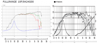

FF85WK probably a very nice performer, but have you any data to share for why 10F is as you express killed by a FF85wKeN and why when looking at below compared frq plots why one of them is only a midrange but not the other one.
Below is manufactures objective datasheets for stock FF85WK verse 10F/8424 stretched to same scales, below each plot is placed some scales to show X axis was quite right before aligning Fostex plot Y axis to same scale as SS plot. Then in picture 2 and 3 is 64 watt into those two drivers and their excursion limits, add virtual a XO point and think about possibilities when some distortion components starts to kick in.

Hard to compare the charts -- not the same scale & who knows how close the measuring conditions were. The sims show significantly lower bass from the FF85wk. The FF85 will have course have greater excursion because it goes lower with about the same cone size.

.....Hard to compare the charts -- not the same scale & who knows how close the measuring conditions were. The sims show significantly lower bass from the FF85wk. The FF85 will have course have greater excursion because it goes lower with about the same cone size.....
Okay fair regarding compare charts but on the other hand those two brands datasheet are often close to diy home environment measurements and wonder in that you have both can share some under same condition data, FF85wKeN also welcome. But regarding linear excursion can't you see FF85WK have quite some less advertised linear travel compared to 10F.

stamped steal frame on FF85WK is hopeless verse casting on 10F
There is no question that the 10F is well built. The steel frame on the FF85wk is cheap, but really well engineered to get the most out of the format. In the end what matters is what they sound like. 10F stock is still more expensive than FF85wKeN and doesn't sound as good.
Stock i don't know. But 2 stock FF85wk cost about the same as a single 10F.
Moot. What matters is what the whole does when you listen to them.
Could be wrong but if high passed 400Hz or higher personal consider frame construction for FF85WK close to perfect executed for application, so therefor sorry think my English language skills spoiled some the context and what i meant saying that sentence. Seems we agree 10F is well build and FF85WK well engineered and probably the other way around too, also in the end what matter is what they sound like, next is of course respect your personal taste and preference for FF85wKeN and also like its lower cost but have hard time imagine 10F doesn't sound as good.
You right 10F is costlier and that is good point, but regarding this thread OP ask to improve his sound from pair KEF LS50 which I'm not sure is easy and at same OP have pointed to and approved budget for a pair 10F.
The magnitude of the differences i found surprising.
if you don't accept acoustic measurements and there coherence related to electric domain measurements and find it weird world shall rely and trust only your ears as a reference point to measure acoustics with precision resolution.
The ear is the final arbiter. (Henry Olson said that). I do accept acoustic measurements but i also understand their limitations -- which many don't seem to.
dave
All things considered, the FF85wk has a more even tonal balance. The 10F may need some passive correction (bsc) to sound balanced.
Larry
Thanks info perceive message as so is performance those two drivers period.
Is this analyze and proposed correction filter based on instruments ears or some of both.
Will have to buy a pair those Fostex to have a listen their sound.
