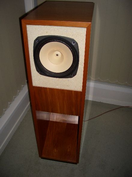

I just can't get these photo's to upload. Can anyone tell me how I am to paste the photo's directly to the post as I see many of you all do?
Ian
Hang on try this!!!

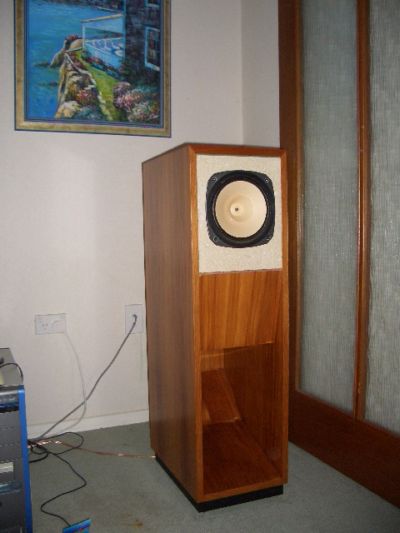

Anyway here are the rest and I hope can live up to some of the great pieces presented here.
There are not many close up shots as they would emphasize my first attemps at finer wood working.
The cabinets are MDF venered with a heart Rimu. Varnished and then waxed.

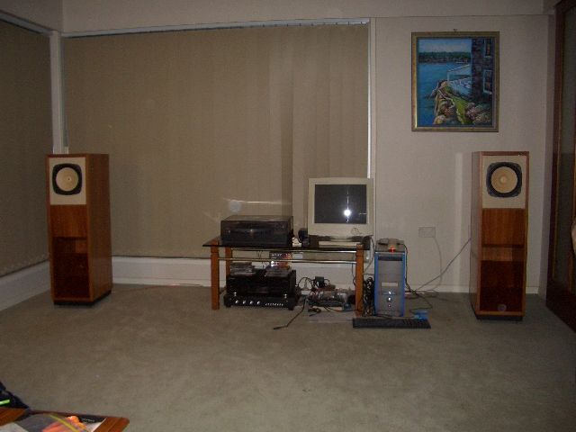

And the final one of the set up.
Thorens 160b TT, Home made amp "Winton" from practical wireless 1977? and Pioneer stable platter with legarto someting or other.
Anyway they certainly sound great with certain recordings, maily vocals smooth sounds "Norah Jones" etc. I like thier in your face, fill the room sound (much to someones anoyance) but are up for any sujestions on improvements. Yer I know get a cross over and multiple drivers is what some would say and I will be exploring that when the Leach Clone get finished.
In the mean time I would be interested "Dave" on your thoughts about a phase plug and how it would change the sound. I have also heard of some people using a resistor in series with the 206 to tone it down?
I eventually hope to have two systems "Analog and digital". So when I complete the Leach then I have to decide on make up the Zen9 for these and the pass lab B1 buffer or new speakers for Leach.
The never ending life of DIY audio I guess.
Ian

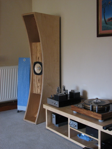

Another pair of Scott’s Curvy Changs

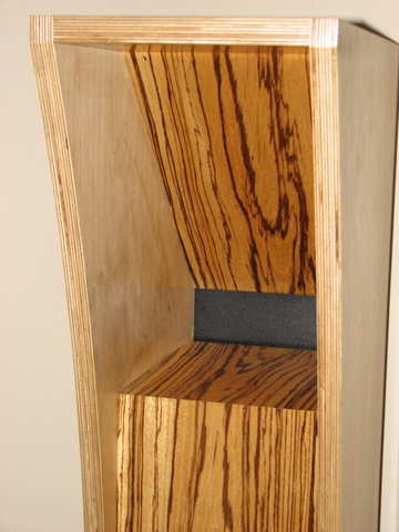

A few pictures of my Changs.
A great speaker with musical insight, I would recommend them to anyone, a fairly easy build with basic power tools.
My cabinets are 1” Birch ply veneered with Zebrana, finish is three coats of cellulose sanding sealer and wax, quick and easy!
Steve.

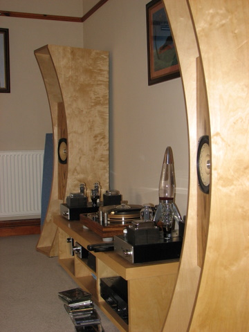

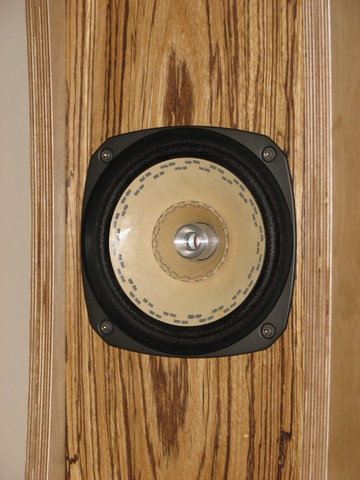

The drivers are fe206’s, not the first choice for the cabinet but I was keen not to use a tweeter. I had intended to keep things as simple as possible and use them with only the recommended series resistor. Scott pointed out that this cabinet design doesn’t need a BSC filter but I found that, in my room 1.8 mH and 5ohms in parallel tamed the 206’s rising response nicely. I was a bit dubious about the benefits of EnABLing but the results are well worth the effort, cleaner, smoother and more detail. (its much easer to do than to contemplate!)
Steve.

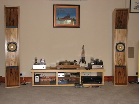

Last one!
I’m sitting here and Christy Moore is standing at the other end of the room telling me to “stand up and cry like man” I feel very compelled to do so!
Thanks again to all involved in this great design
Steve.
Ps. I Would be very happy to pass-on the template for the side pieces to anyone in the south east interested in building the CC’s
