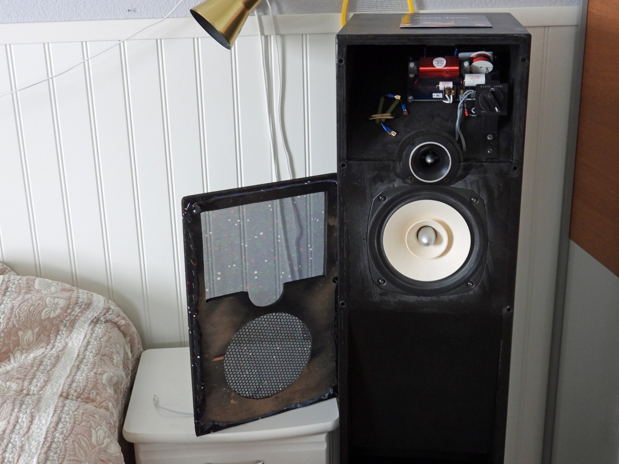

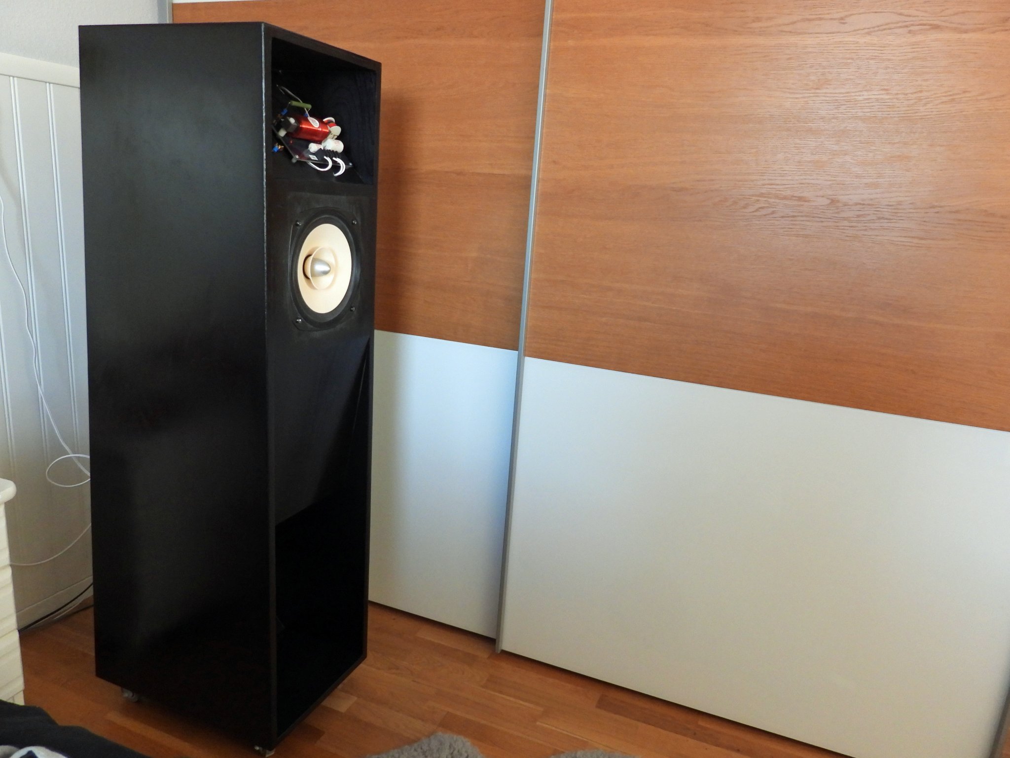

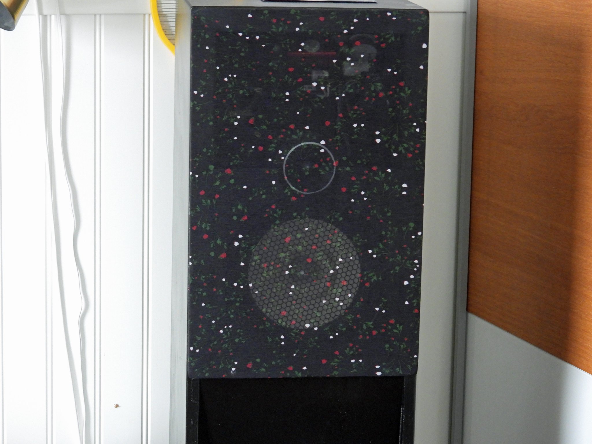

I've built a pair of Dallas II with 206NV and frecuence correction circuits. Tested with REW and found they limited hf at about 16000Hz and added a pair of old Coral piezo horns i found in my basement. Even my old man's ears could hear it sounded a lot better. Right now I only feel a need to open them again to take away some damping to gain some 80 - 150 Hz bass. I think that's the way to go. Hope my english is good enough, I'm a swede born in Norway. Happy to be a member of this community. DSCN1650.JPG DSCN2522.JPG
