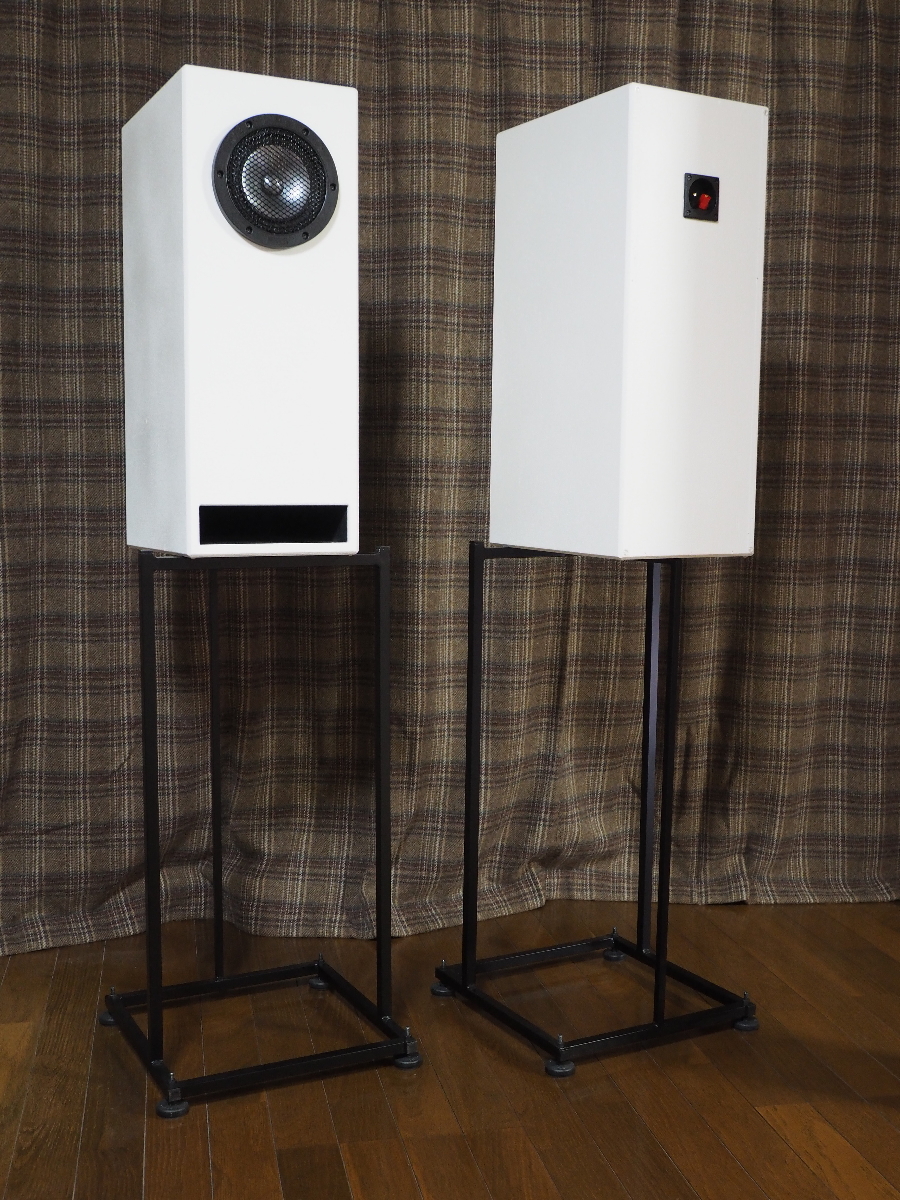

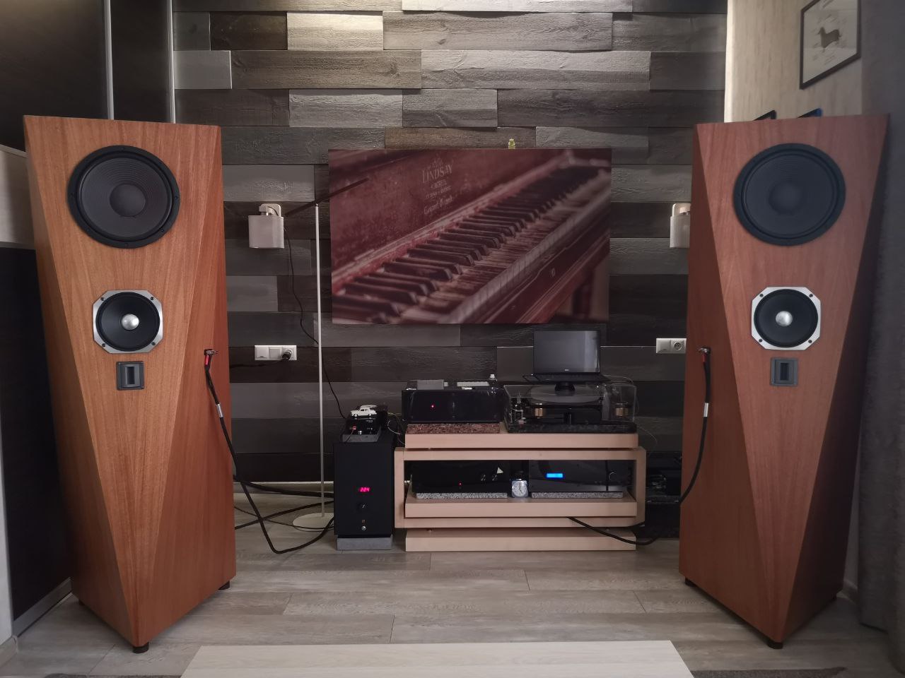

Hello, friends. My acoustics Fostex F200A - from 170 Hz Supertweeter Fostex 17 RP first order from 18 kHz Bass with electro-mechanical feedback (for now) Fostex FW305 - from 17 to 170 Hz. Of course, the voice of the acoustics is the Fostex F200A.

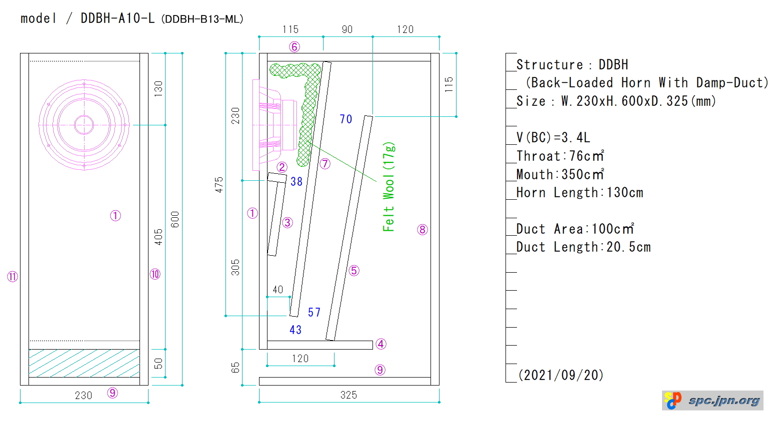

MarkAudio Alpair10v3 + DDBH-A10-L(Back-Loaded Horn with Damp-Duct)

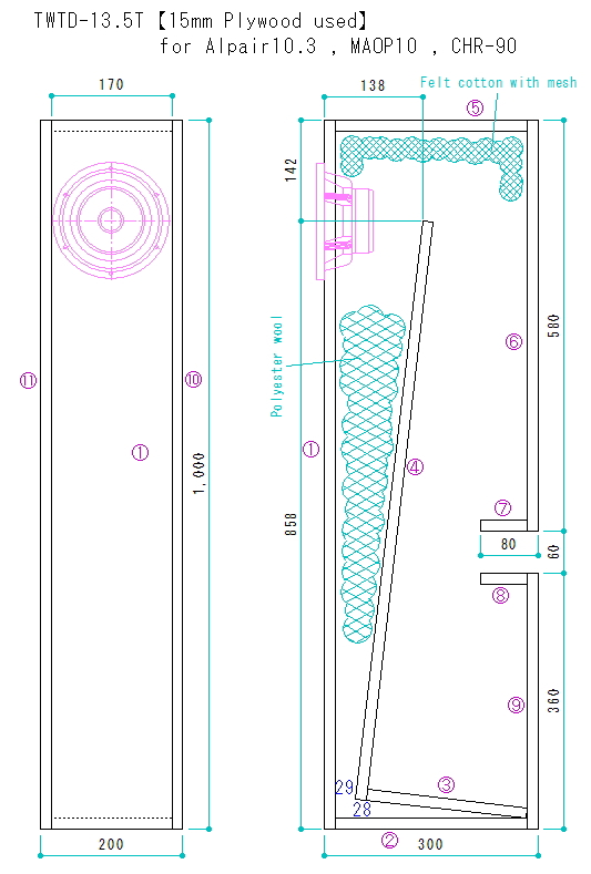

Received a pair of MAOP 10.2s earlier this week. Looking to settle on the first cabinet to build for them. Will be used with 6V6 PP amp (Poinz's Musical Machine), and future First Watt J2 clone, LuFo and Tokin SIT amps (I've got all the unobtainium sand parts).
What is your opinion on this cabinet design vs your TWTD-13.5T design when fitted with the MAOP 10.2?
From the YouTube videos with its limited sound quality, they seem close enough in performance, with my ears (possibly) giving a slight preference to the DDBH-A10. With your ears listening directly, do you have a preference to share?
Dear steve jones,
If you want to use a tube amp, I recommend DDBH-A10.
DDBH-A10's sound is a hard and sharp, so jazz and rock are great.
If using a tube amp, mellow sound sources such as classical music also will be even more wonderful.

Thanks, Nandappe. This gives me a good idea of which box to build.
Not sure what you mean their nandappe?
Could be something lost in translation?
dave
Dear dave,
Sorry, I can't translate well.
I wanted to say, "Even if I use the same driver, the sound that comes out will be different depending on the structure of the box, the amount of damper, and how you use it."

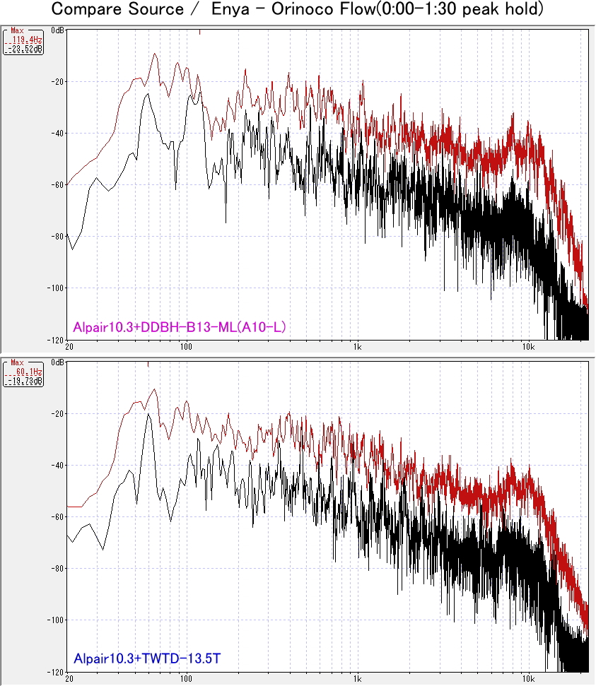

Compare Air-Recording: Enya - Orinoco Flow
Alpair10.3+DDBH-A10-L(DDBH-B13-ML)
MarkAudio Alpair10v3 + DDBH-B13-ML ( minimum limited series for 13cm full-range driver) - YouTube
Alpair10.3+TWTD-13.5T
Tapered Wave Tube with Damp Duct(TWTD)/ ダンプダクト付きテーパー波動管(開口部オフセット型TQWT) + Alpair10.3 - YouTube
Those are not really useful.
The particular word “sharp” you used is to my mind not something you want in a loudspeaker. It usually means an unwanted HF resonance.
A good loudspeaker should be able to reproduce anything, but the compromises taken will often favour specific genres.
dave
Dear dave,
There are many people who make use of the air recordings on YouTube.
In Japan, the general idea is that air recordings are more useful than words and graphs.
I think that is the time now.

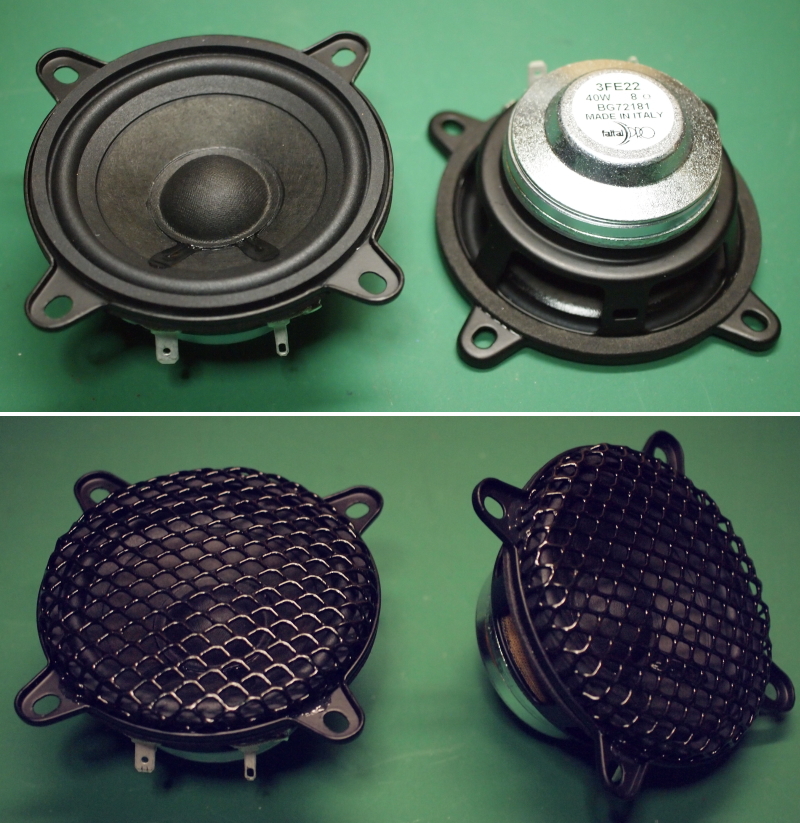

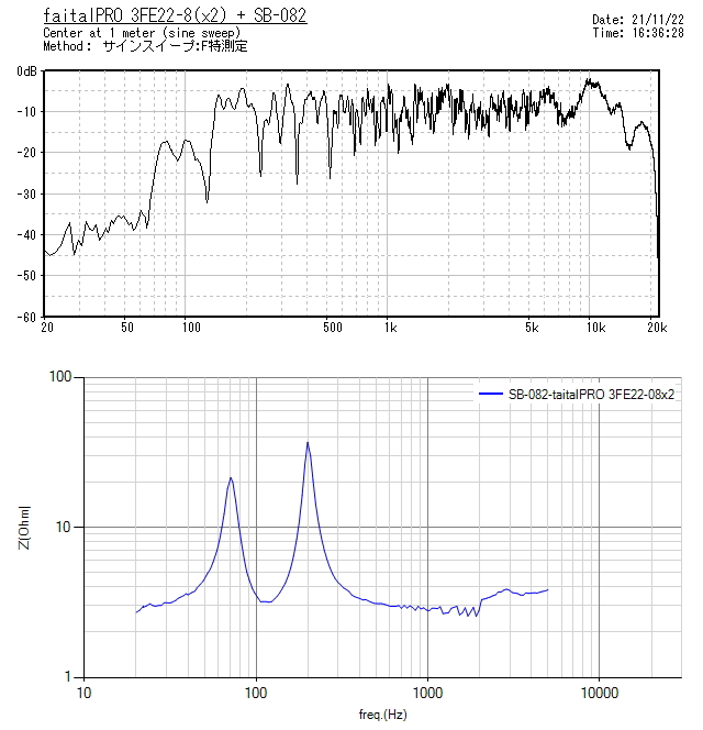

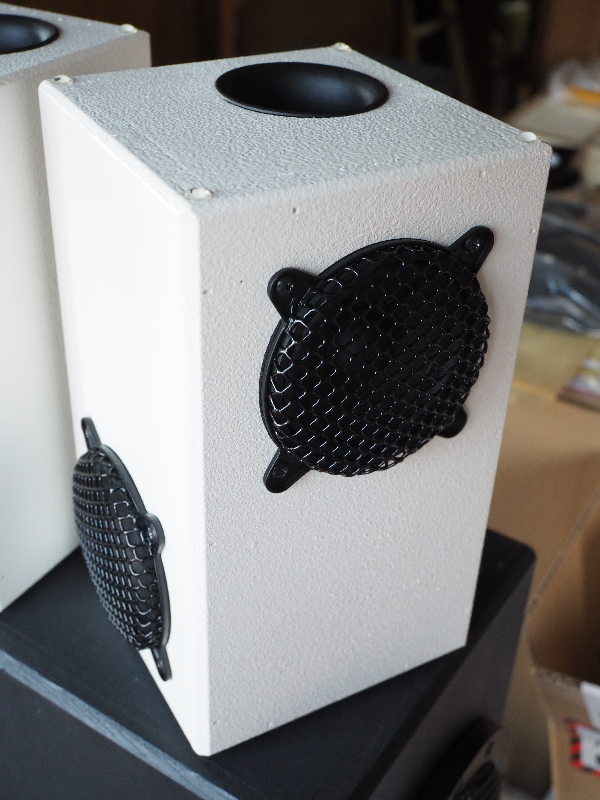

SB-082 is a surround back speaker for DDBH-A10-L.
Drivers are two faitalPRO 3FE22-08/ch.
YouTube [AIR RECORDING] - SB-082, TAKE FIVE / Helge Lien Trio
SB 082(surround back speaker for DDBH-A10-L)+faitalPRO 3FE22-8 - Take Five - YouTube
