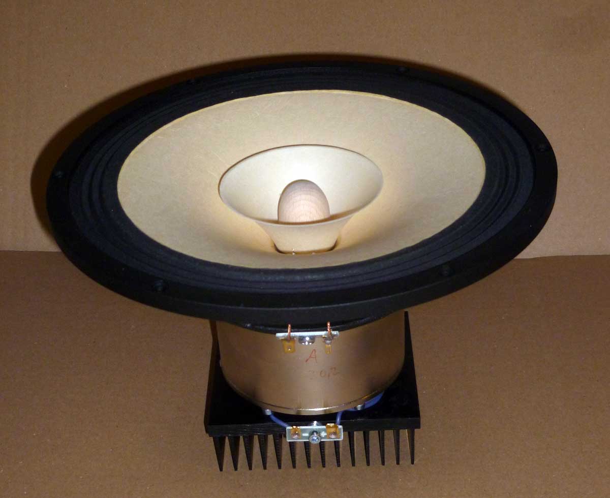

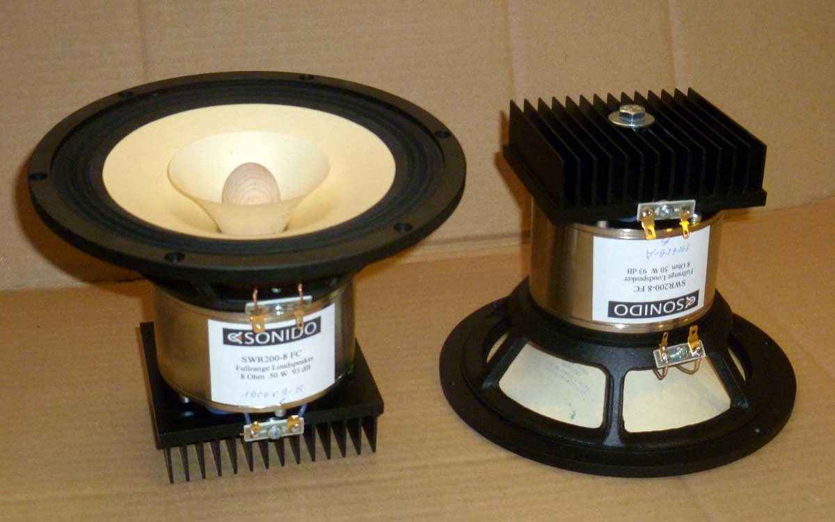

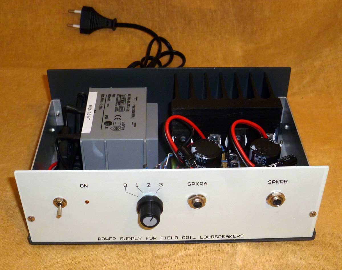

Field Coils from Sonido .... and actual price list
So , Mr. Istvan Varga is shy guy ....... he's not shy to make bunch of good drivers , fluent enough in Hungarian ( of course :rofl: ) but also in Russian and English , but shy enough to not write here about his products......
Anyway - I know Sonido products probably more than 10 years , and I was/still am satisfied with them ; again - I'm not in any way commercially connected with Sonido or any other manufacturer ..... always being Solo Shooter , which gives me freedom to promote quality , and also declare BS when I see it.
So , Mr. Varga sent me an email the other day , with following info :
Hi Choky,
Thanks for the feedback on forum.I can help you make any drawings for these drivers.
My drivers are therefore reminiscent of the Telefunken, because I bought production and technology from someone who before and after World War II, produced diffusers for Telefunken, Siemens and Philips.Cellulose which I use for drivers I still have original and this is from Sweden.
I send you the 2019 price list.
You will probably be interested to know that I have NEW drivers, this is Field Coils drivers.
SWR 222/FC ( 8")- 490,-€/PAIR
SWR 250/FC (10") -560,-€/PAIR
The field coil drivers all reguire a power supply,sold separately 150,-€
Best regards,
Istvan.

I wonder how the usage of a tube amp will affect the sounds of the speakers. Please excuse my ignorance for asking such a question. It seems as if there tube amp would be useless if the speakers have a power source. Isnt it like a powered sub? Why feed a powered sub through an amp when the sub has its own built in amp?
A field coil gets it's magnetism from an electromagnet (essentially) instead of a fixed magnet (like an alnico, ceramic, ferrous, etc.). So the power supply that was mentioned is to generate the magnetic field in which the voice coil moves. You still need an amp to drive the voice coil for sound reproduction. You really should read up on them if you are thinking of using them. Very interesting stuff!
