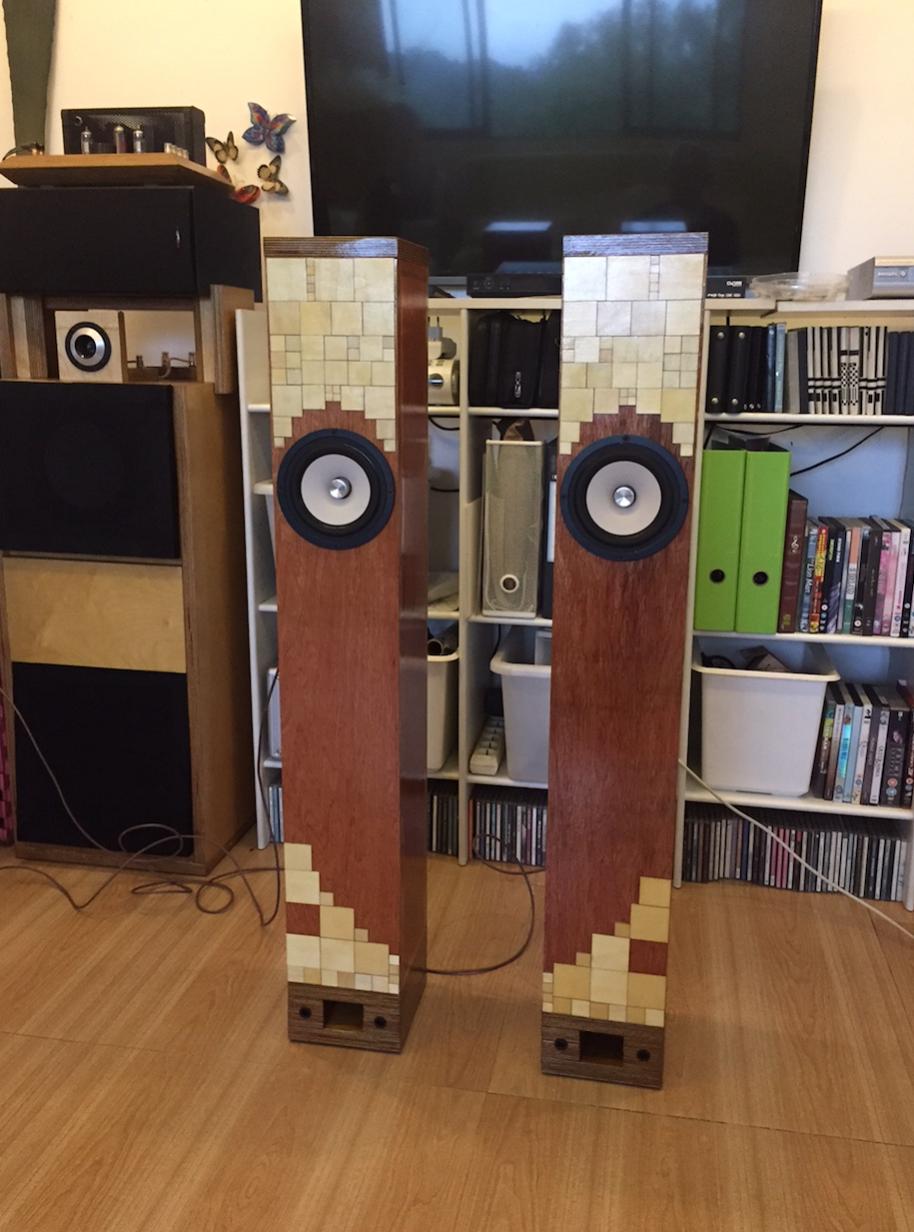

Just finished two ml-tqwt's for Alpair 10.3
Design (or dimensions) is pretty close to frugel xl, but I wanted straight enclosures and no curved back. Port tuning is adjustable. Sounds pretty good actually and the amount of bass is absolutely ridiculous! Lower cutoff is somewhere around 40Hz, line tuning about 45-50Hz.
There is bump at 200Hz and severe dip at 230Hz, need to figure out that. Propably some harmonics going on and messing things which is typical for tqwt enclosures.
Also lots of presence from those alpairs but in a good way, not annoying at all. Highs are little bit "harsh" sometimes. Overall, satisfied results.

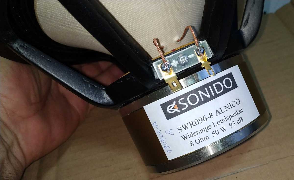

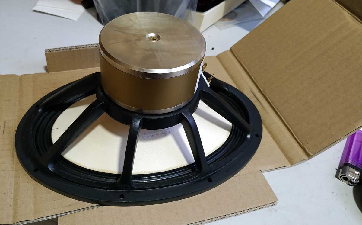

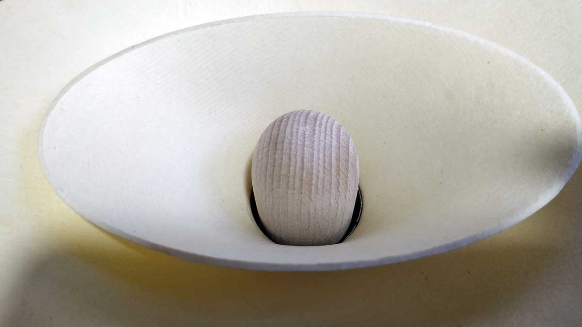

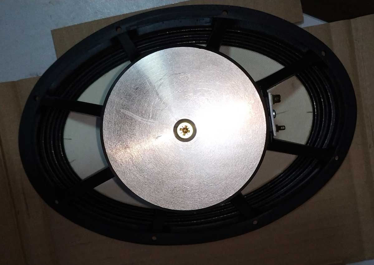

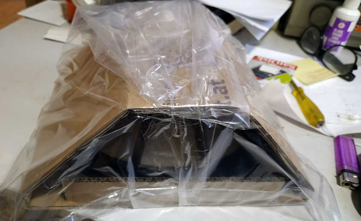

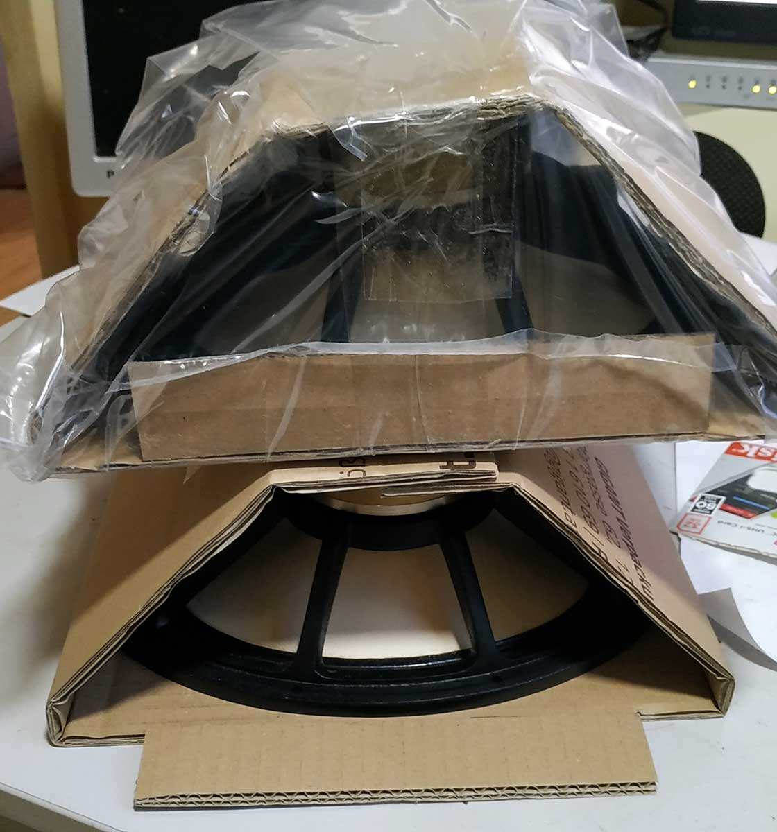

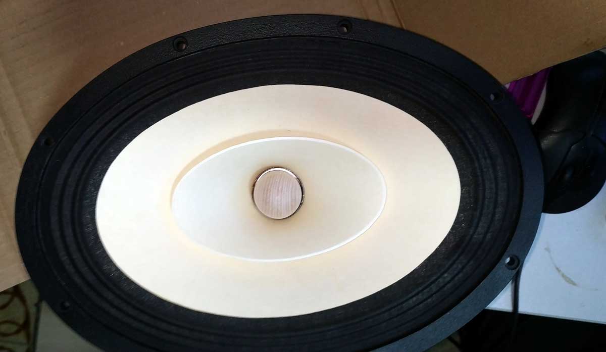

just got my new SWR096-8A Sonidos
tnx to Mr. Varga , excellent product , as always
as I'm used to say - these reminds me on GrandMa's Telefunken , just made with modern materials , where's important and beneficial

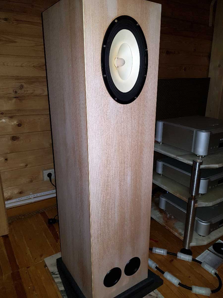

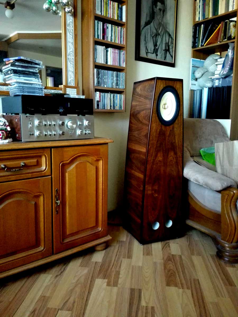

once more
last two pics taken from sonido.hu site , few examples of boxes made by customers
still didn't decided where my are going to end , box wise
most probably will keep them some time near my PC desk , to enjoy just looking at them
edit - and yes , they're ovals , no broken pics , even if I took them with phone
