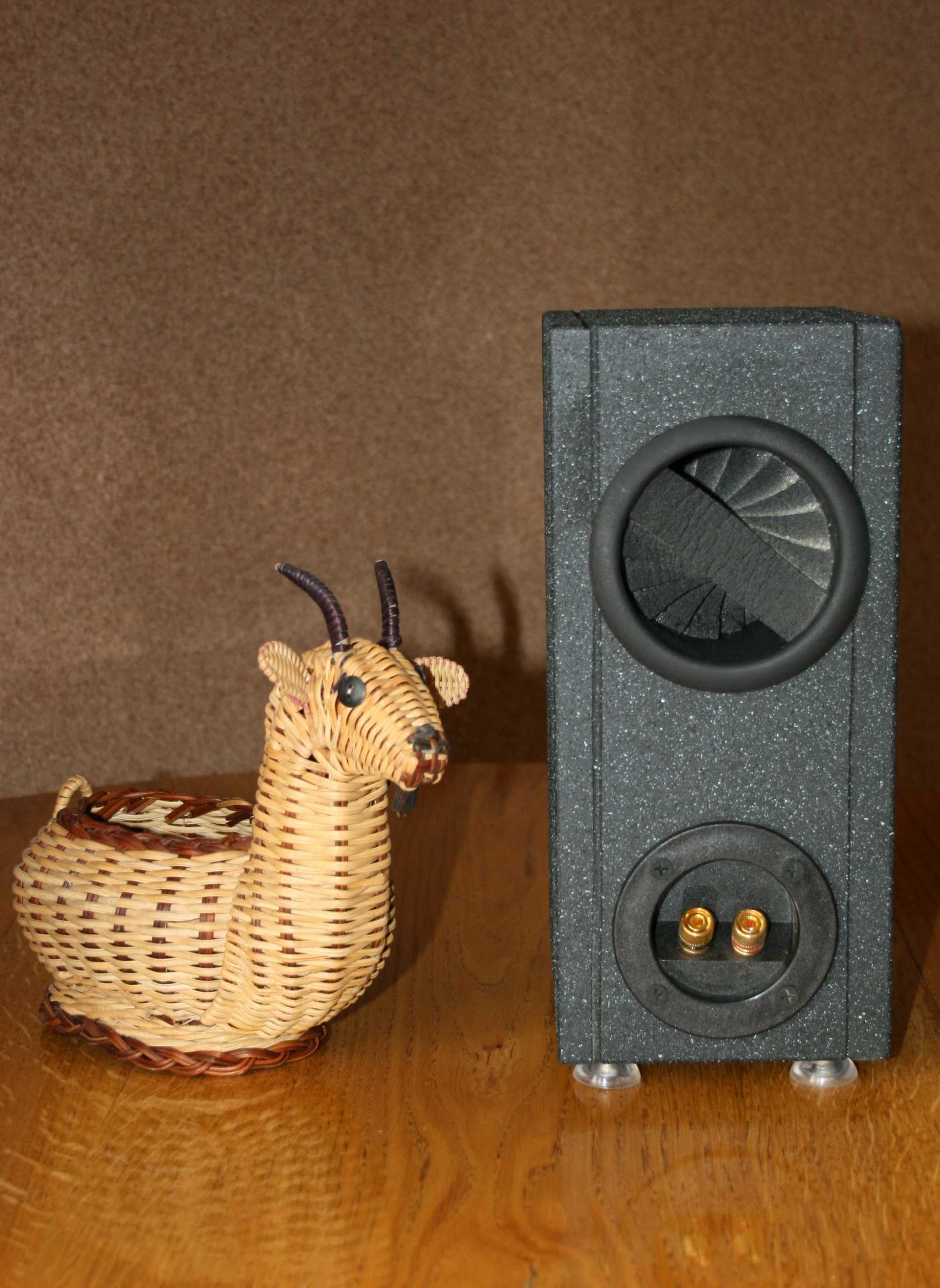

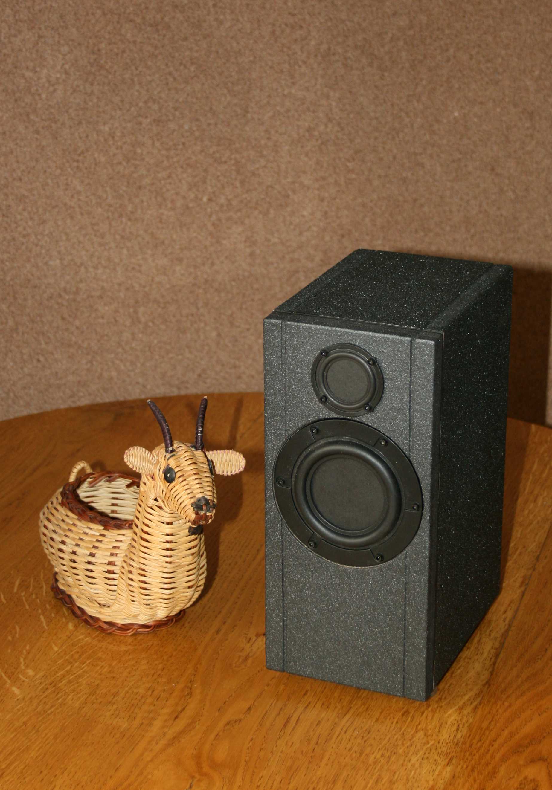

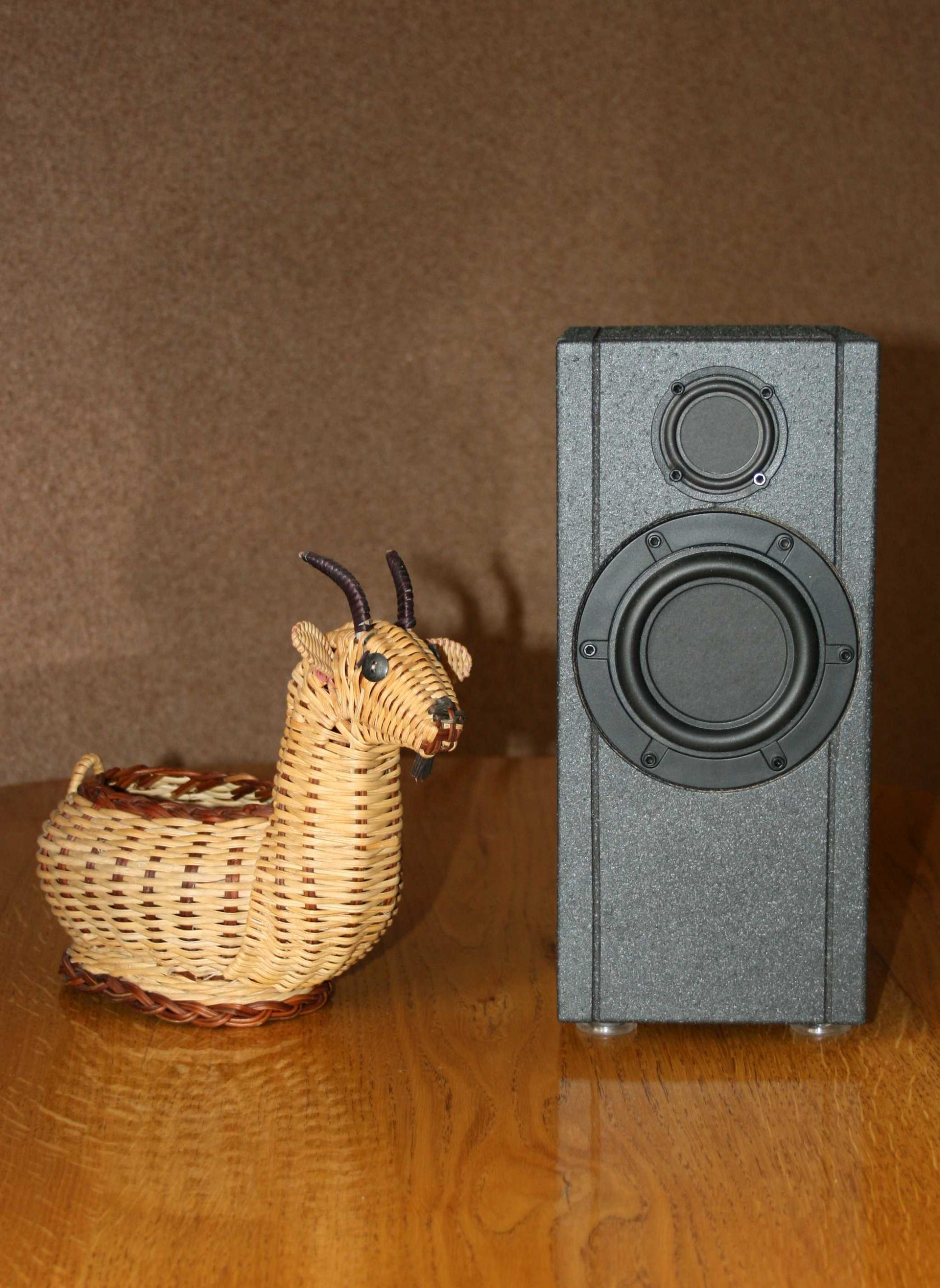

My new DIY computer minimonitors:

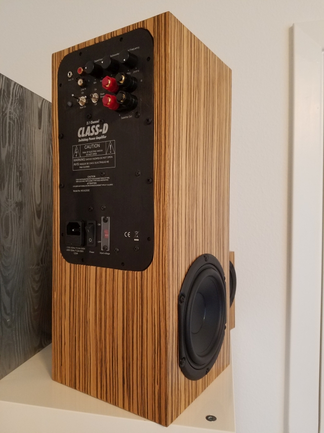

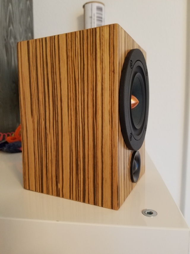

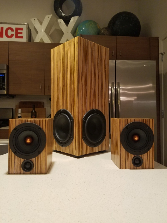

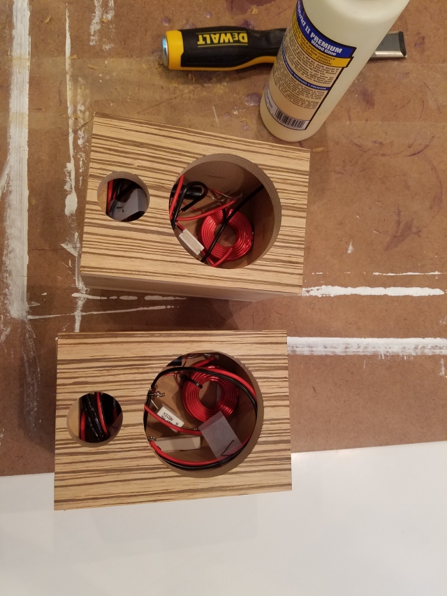

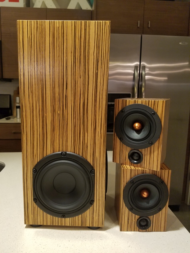

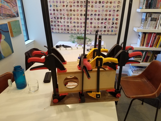

Zebra Sub-Sats
This is my third speaker build. It is a 2.1 sub-sat configuration that I'm using in my bedroom, with the sats mounted on the walls.
The sub has a Tymphany 5 1/4" subwoofer driver, with two matching passive radiators in a sealed enclosure. It has a 5 liter volume.
The sats use a 4" 'point source' Dayton Audio full-range driver with additional 3/4" Dayton tweeters.
I taught myself how to veneer specifically for speaker building and these enclosures use 3/4" MDF for the sub and 1/2" MDF for the sats with African Zebrawood veneer.
The sound is really good for classical music and vocal oriented music (like folk music), but they aren't the best for rock as things get a little muddy and strained. Overall though, I'm pleased how they turned out.

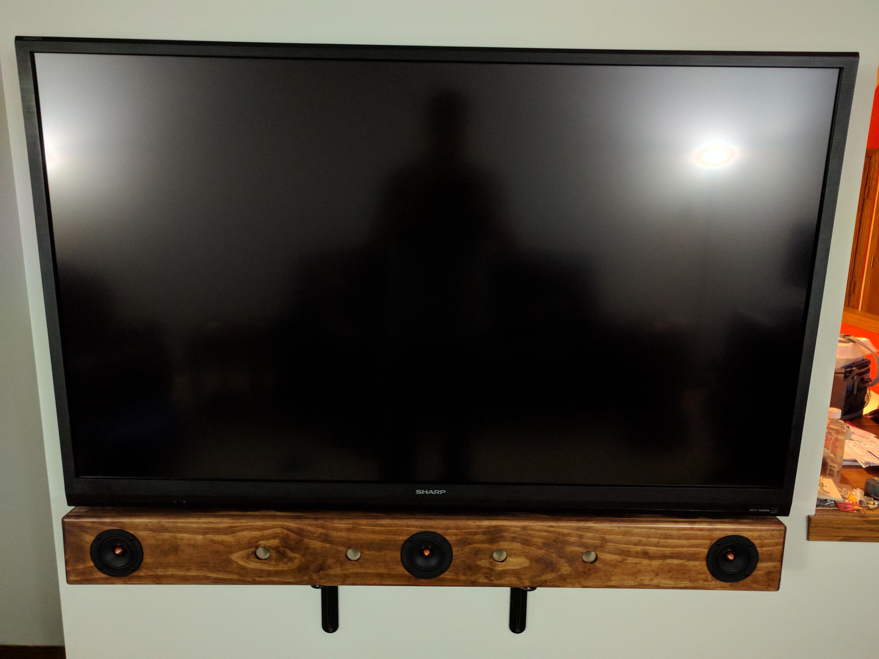

Dayton PS95 speaker bar
My first speaker bar build, using Dayton PS95 fullrange drivers, ported to around 72hz on the left and right channel and 85hz on the center - which has dual ports for cosmetic purposes.
