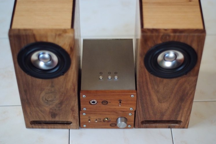

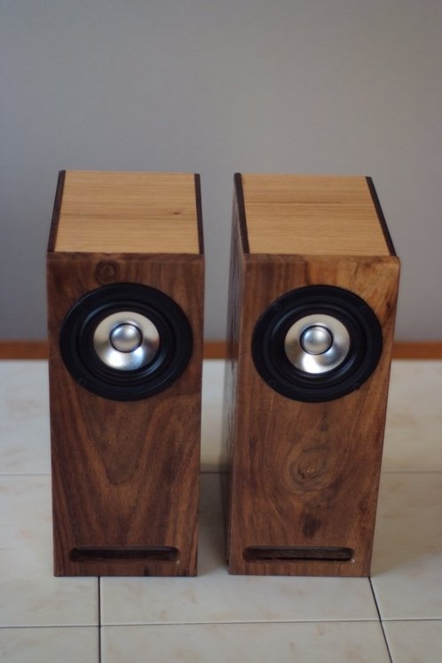

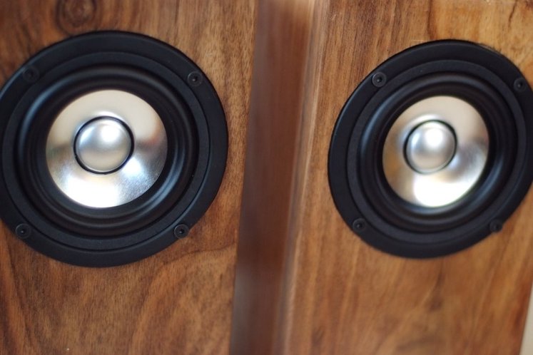

Since I really like Bigun's "Martellos", I wanted to make them with some nicer material - I'll let you be the judge to say whether these turned out OK.
I also wanted then new pair to be more "in line" with the rest of my designs (two other devices in the photos are a digital amp based on STA333BW, and an FX6 DAC). I think the new speakers go nice with the general design.
This time I've used Fountek FE85 drivers, which are more visually "attractive" than my first try with Visaton drivers (which look rather bland, but sound great...). These Founteks sound nice, but still need some hours to break in properly...

Very interesting! You make up the varnish from turps and resin? What effect does the varnish have on the frequency response, did you measure at all? I've been measuring and in the range 2KHz to 10KHz, the AN10 is like a sawtooth, all ups and downs from (say) 80db +10 / -15, but below 2kHz and over 10, very smooth... Love those horns!!
Glad you are interested. I never measured the freq. response but the sound gets more elegant, refined, defined, extended...etc. This after a brief period (depending on weather; you probably have the right weather) of muddiness while it cures.
Indeed, for the varnish, turpentine, a little linseed oil and gum Dammar, all to be found in providers for violin makers. There are several recipees online, from the violin world. I remember for my last varnish just put pulverized Dammar into a bottle with raw turpentine and let it rest on direct sunlight for weeks...
IF/when you want to apply the varnish, let the speaker rest on its back, be sure that nothing can enter the coil/magnet gap, then apply one thin layer (one always have the urge to apply more...) to the whole transducer's surface (omiting the surrounds!) and even to the HF, whatsitsname, cone something...

Sheesh these look nice, well done!
