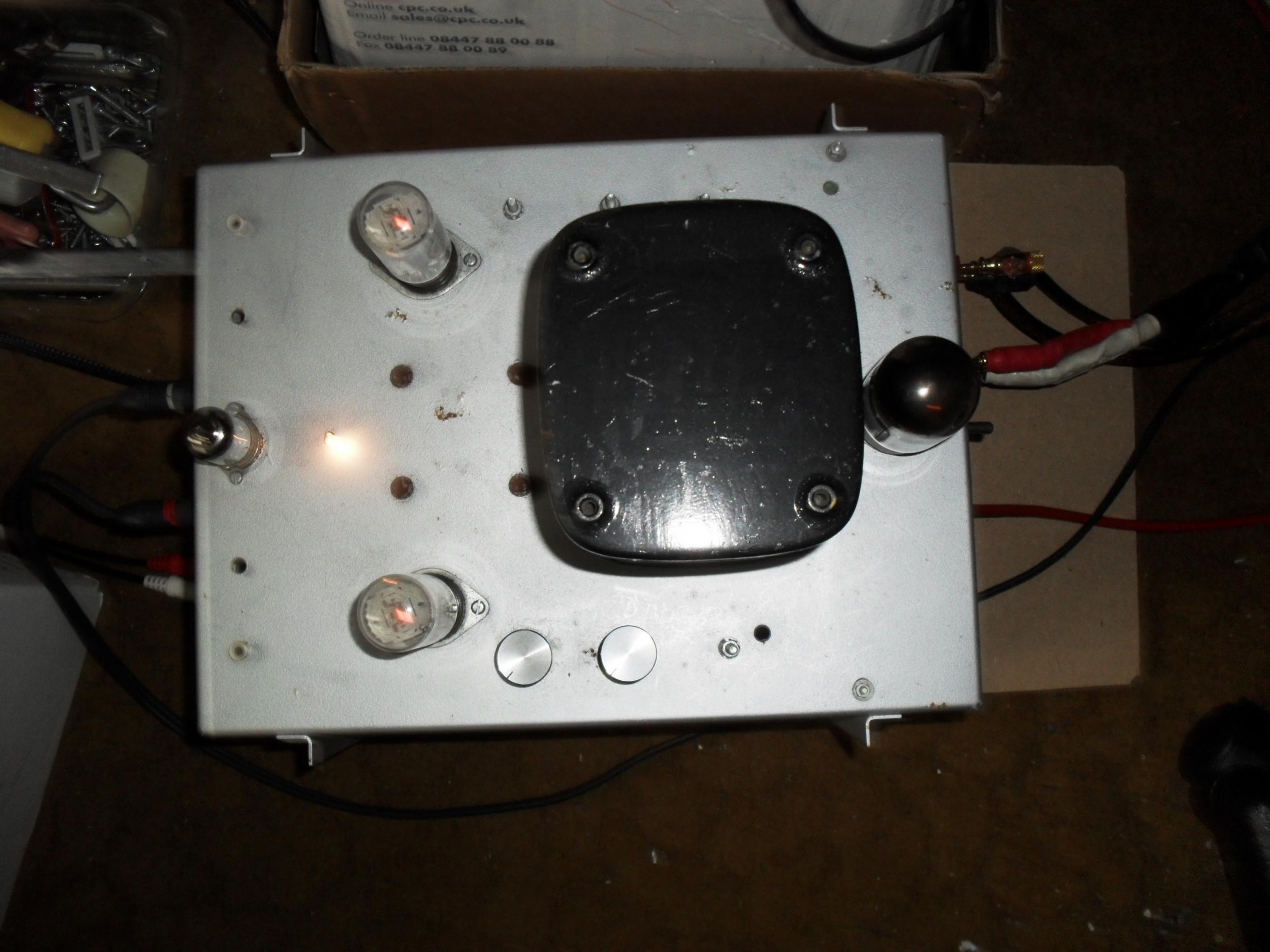

Showing my 2 full range planars and DIY amp using 2 6au5gt's and 1 ECC 88 + RECTIFIER. Very happy with the sound no more funny noises I had with mylar or polyethylene. At last I have arrived at my final design after many years of trying. Got a few more wood to build a few more full range planars.

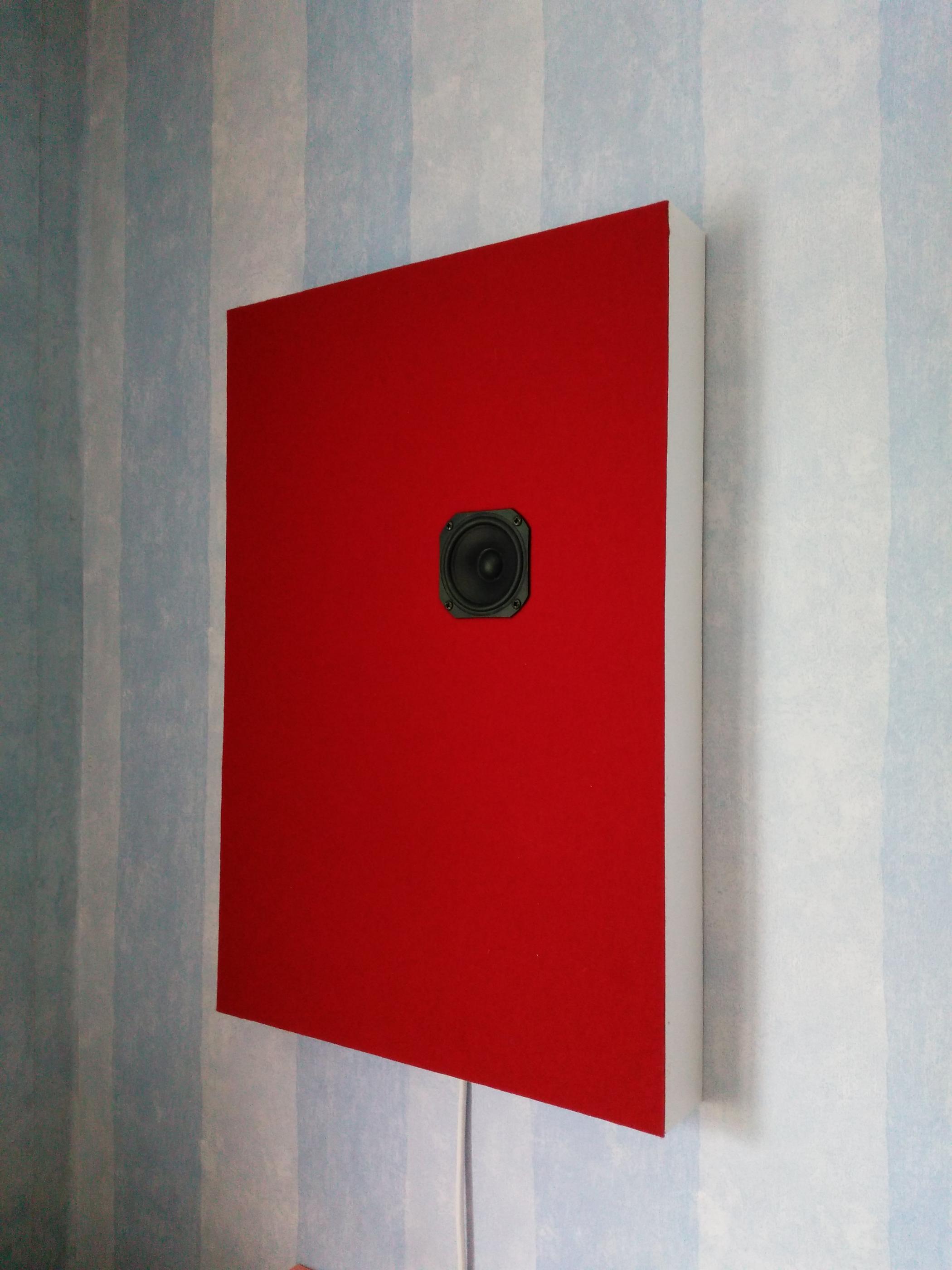

My rather simple but nice sounding wall speakers for the kitchen, based on Vifa 9 BN 119/8 (Peerless FR35/8, Peerless TC9FD-18-08). The design is a folded TML (overall length 120cm) called "Vifantastisch" and was published by a user on a german language board.
Material is plywood and wool felt for the front.

I am quite happy with the speakers' sound. I find it hard to compare them to anything similar, since they are my only full range speakers (yet).
Subjectively judged, they sound warm, not to analytical. They somewhat lack high frequency definition, but still: Hi-hats and cymbals sound natural to me (i am drummer myself). Bass is good, though not super punchy. Music with overly electronically enhanced bass drums (or synthetic bass) is not their strength, but jazz and normal rock, or even "lighter" metal, is. Voices sound great.

Horst - you pretty much described what "decent" FR drivers this size class excel at in almost any suitable enclosure.
Yes, that's two qualifications - all loudspeakers utilizing current technology and materials will have some compromises - and as much of a fan of them as I am myself, there's no real argument that small full rangers somehow magically escape that.

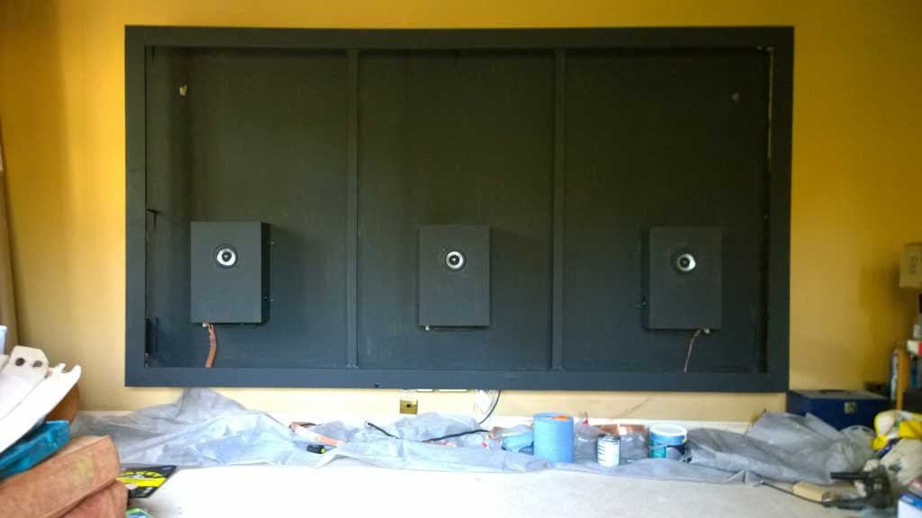

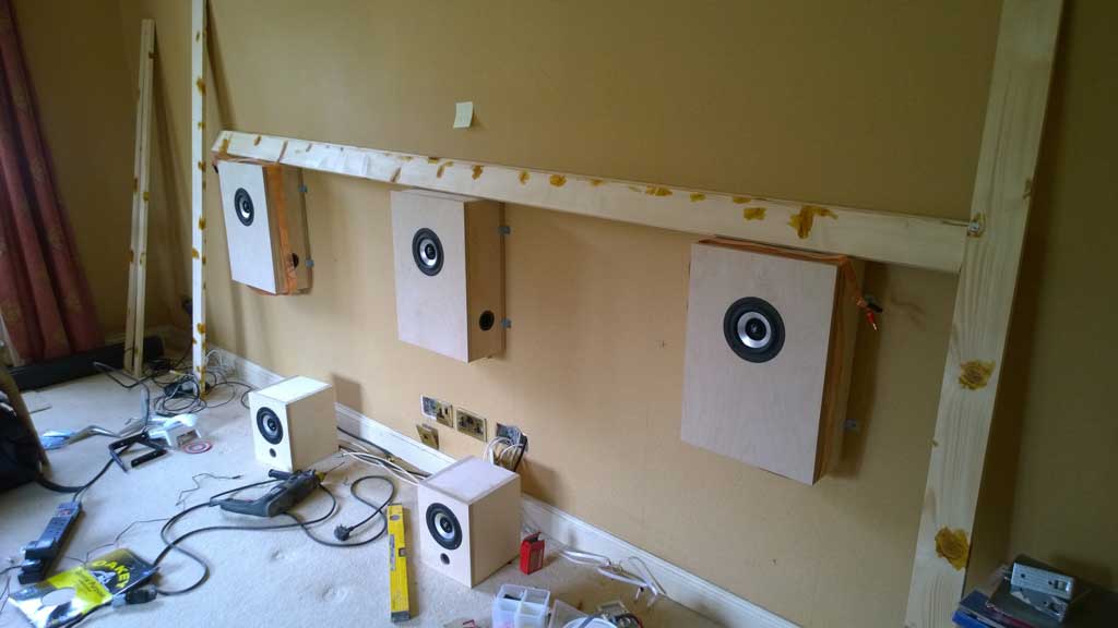

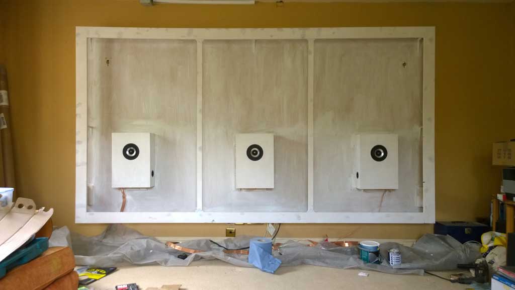

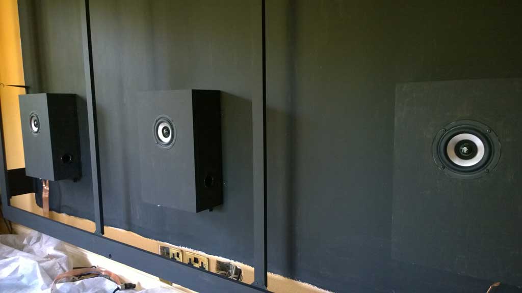

Just read the news about Ted Jordan's passing. Very sad.
It prompted me to post some pictures of my DIY home cinema using Ted's Eikona 2 driver. There's still lots to do but it's now working with 2 channels.
Each speaker has its own monobloc MyRef_C with Ultimate BOM and sounds stunning. I just need to finish the last three amplifiers and it will be good to go.
All of the speaker enclosure designs are from the Jordan website.
The screen will use Seymour Center Stage XD AT material.
I'd read many good things about Ted Jordan's speakers but not much about using them in this application so it was a bit of a gamble. I'm very pleased to say that they sound amazing and bring a smile to my face every time that I listen to them.
Thank you Ted.
