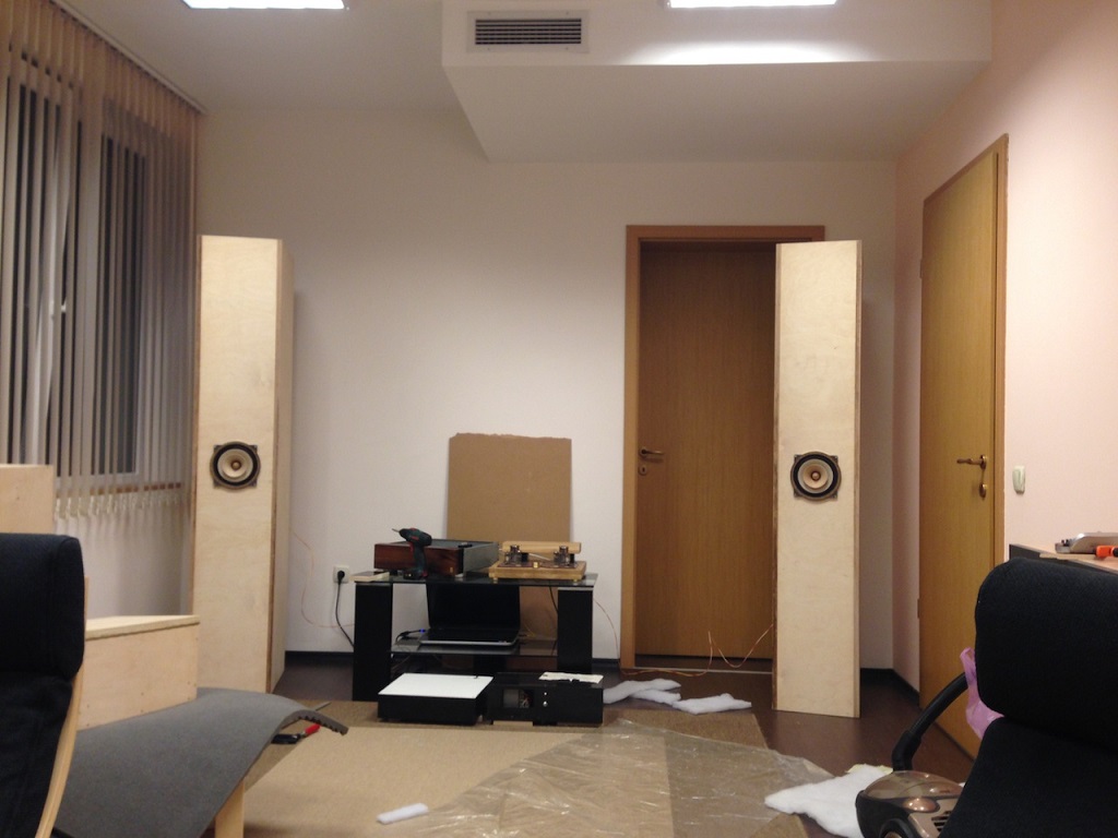

I first had Ether 7 in those enclosures - see the image - inspired by Scott's Kirishima's but with mouths on the back side (praise to MJK - without him my journey wouldn't have been so entertaining). In these the bass was too monstrous, overpowering all the other frequencies. Even though I tried hard, I couldn't tame it without subduing the lower midrange. I didn't realize before that you just couldn't stop the low end bass - it simply penetrates everything! So it was an overkill... Eventually I saved some money, caught a pre-expo discount and bought finished Centaur floor firing horns - much smaller, moveable and the base is just enough - see the other image.

You mean....back loaded horn....
Looks very good.
What kind of wood did you use for this?
No, its like constant cross section TL with 1/3 displacement of the driver location (like this: S.A.M. "Saburov Audio Manufacture")
Plywood + wall nut veneer + tung oil.

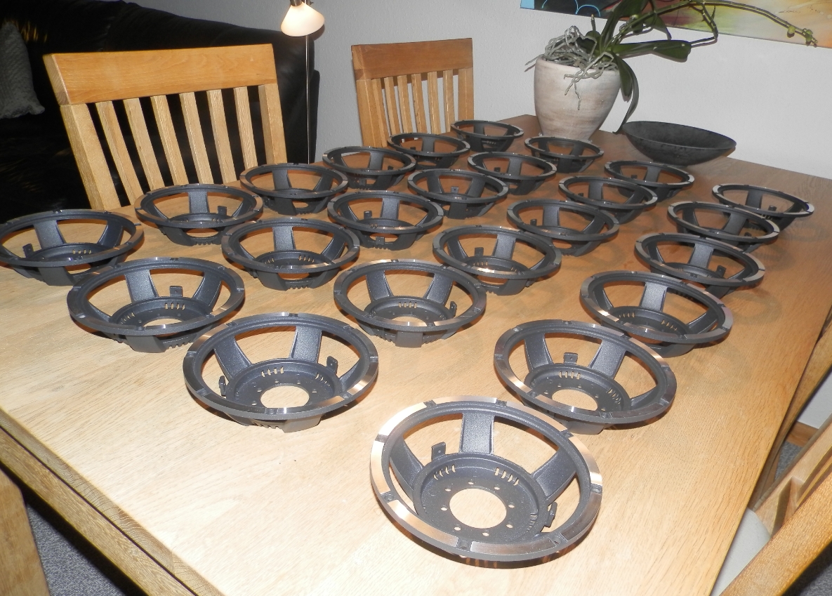

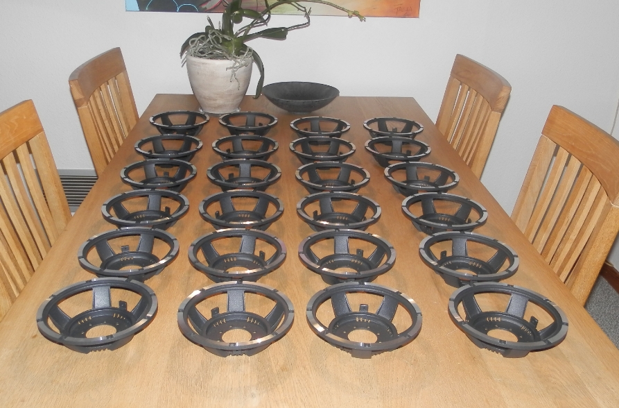

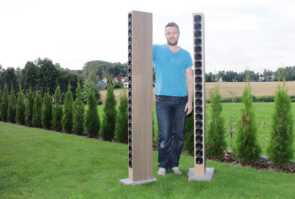

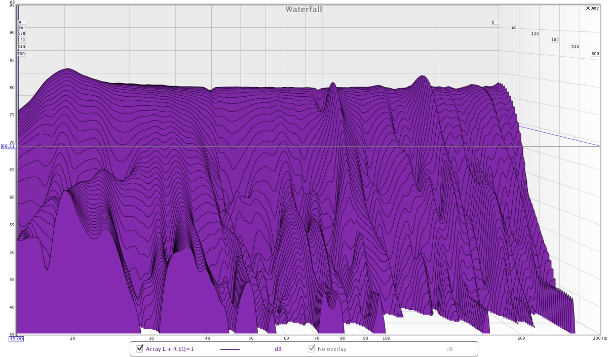

My first DIY-speaker Project - finished this spring.
No crossover, all drivers see same signal, only analogue EQ to counter the rolloff on top/bottom frequency characteristics inherent of line arrays.
