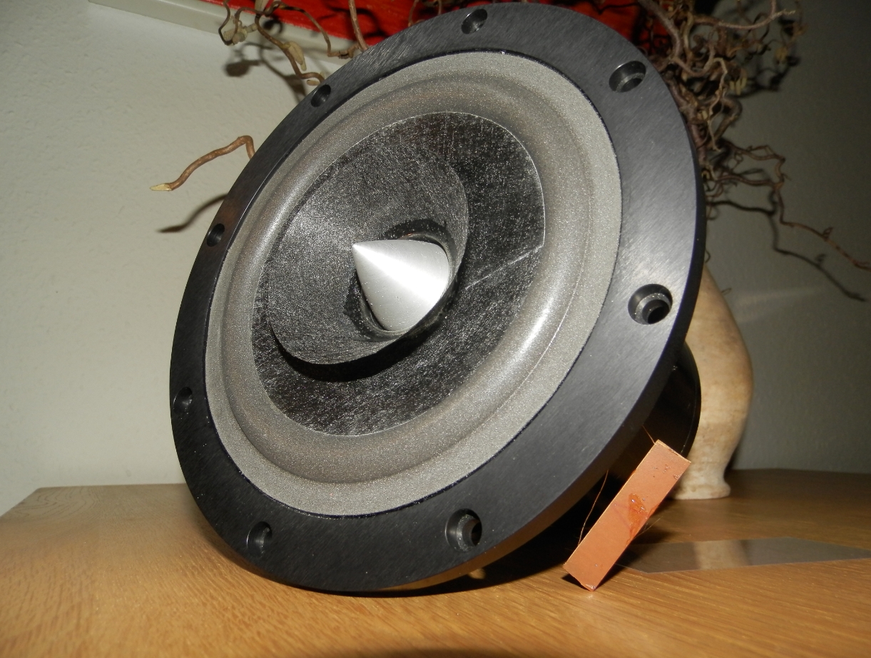

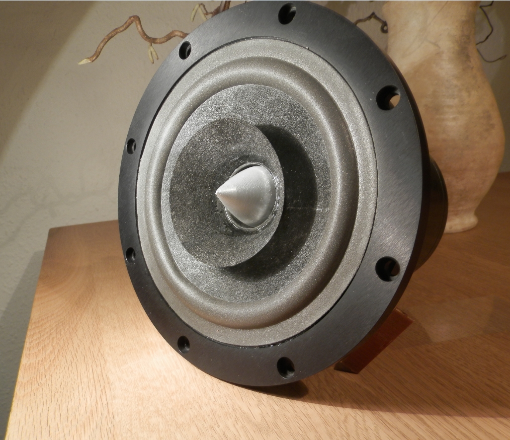

Alpair 10.2eN in "TL-Resonator"
picture.php
picture.php
picture.php
Cheers, Alex
Alex you do absolutely beautiful work. Do you make the butcher block? I just love this look it beautiful!
I'm listening to: Trust by Graus & Bronzwaer
Thetubeguy1954 (Tom Scata
Thanks Tom! The Block is made of two 1" glued beech wood boards. Thread over here
WOW! I just checked out the thread and I'm even more impressed now than I was before! You are a very talented speaker builder my friend. You should be making and selling those awesome speakers!
