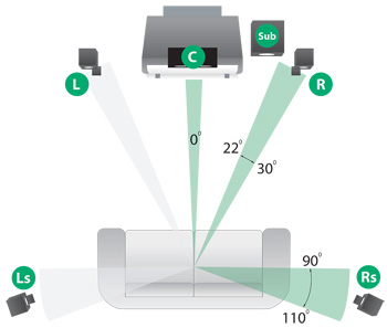

I'd like to do a full range HT setup that can get plenty loud. Close to THX spec, maybe (what even IS that for speakers, or is it just for "systems"?) Budget about $600 for the drivers only, not counting sub. Here's some options I've thought of please feel free to bash or add.
1. Center, a 206 or a 207 (need a center for when everyone's over, I can always phantom center when it's just me and the gf) My size limit would be 11"x44"x aprox 12" max to fit on top of the TV. Aesthetically speaking a horizontal double mouth or double slot port would be perfect.
2. Mains, use the Bruces. Would high passing them at 80 or 120 be a big waste of the lower tuning? Should I consider some sort of box for the 206 or other speaker that's tuned to 80 or 120? Size limit would be around the size of the Bruces 60"x12"x16"
3. Surrounds, use fostex 127's or 167's, or some Tang bands, either up firing on stands or in smaller sealed boxes mounted on the wall. Or even a dipole.
So there's my quest. SAF is fairly low, she's put up with the Bruces all this time I'd appreciate any input anyone has.

I was thinking about the 'phantom centre' but it seems to me that there's a tradeoff. If you put the L and R fronts close enough that you can safely eliminate the centre you are doing the opposite of maximizing the surround effect of pushing the L & R further apart. In my (future) HT system the L & R will be fairly well separated and without a centre anybody not sat reasonably close to equidistant from the L & R channels will not get the right experience. I guess it depends on the details of your set up in the end as to whether the phantom centre is a good bet or not.
Bigun said:I was thinking about the 'phantom centre' but it seems to me that there's a tradeoff. If you put the L and R fronts close enough that you can safely eliminate the centre you are doing the opposite of maximizing the surround effect of pushing the L & R further apart. In my (future) HT system the L & R will be fairly well separated and without a centre anybody not sat reasonably close to equidistant from the L & R channels will not get the right experience. I guess it depends on the details of your set up in the end as to whether the phantom centre is a good bet or not.
My system is 2.1. Speakers are pretty close to the "official" placement.
Even when i sit outside of the tight speaker (in the comfy chair) i have no issues with the phantom.
You just need a speaker that images well and has a wide sweet-spot. All of my favorites seem to satisfy that... listening to Tysen ATM.
