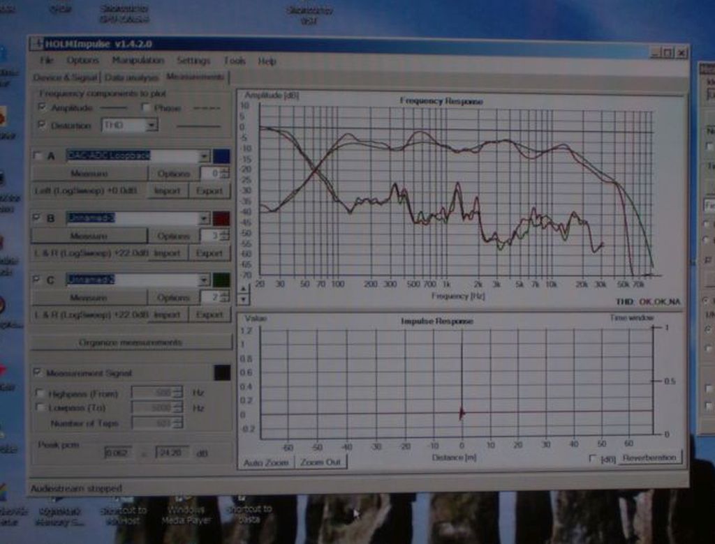

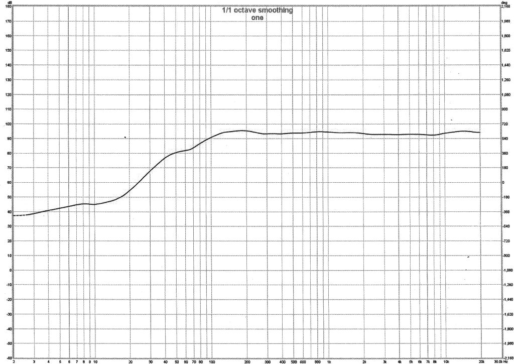

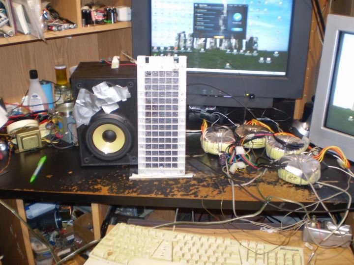

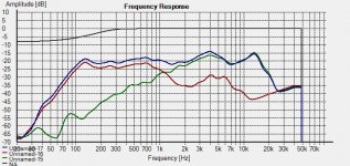

You Stated~ "I guess 99,99% of all speakers can't reproduce this level with resonable low distortion (1-2%)."
And I simply stated, That mine do fall into that rare .001% that does have such performance and a THD of much much lower than 1% throughout its bandwidth. :)
And does +105db as measured with only a 100watt capable (40Vpeak) amplifier. ;)
Yes, it is a Hybrid design as the diaphragm is only 3.25" by 9.75" big.
In order to get another extra 6db, Yes, I have to use one of my bigger amps, but when it is that loud you don't noticed any distortions. ;)
If the panel had more surface area then I could do the same with just a 40Vpeak capable amplifier.
It doesn't take exotic core materials to realize a THD .2% and lower at such levels.
I have shown those real world tests at full power (40Vrms) with a typical transformer from Antek (AN(S)-1206) here,
A TEST JIG FOR FINDING ESL STEP-UP TRANSFORMER PARAMETERS
At a normal listening typical level (5Vpeak) of 89db to 91db the THD is low enough that my sound card will barely register it at .005 % to.002% THD or so.
This is also my approximate sensitivity reference.
There is only one question of accuracy of some of these graphs and that is because I was using my motherboards sound system on some of them, and it was being glitchy.
Other than that the calibrations are correct as verified by my scope.
I know that the main issue here is the use of a full range panel, But I just wanted to address a few issues.
Sorry to have gone off topic a bit.
When they are run at a normal listening level they can go as low as 50hz or so when I do run them full range.
I have listened to them for many hours without a woofer and have been just as content!!
Sorry, But I don't have a more accurate and good to read real world THD graphs except this old blurry one, but there are several others in these threads as well.
All of my graphs are Calibrated though and 100db is 100db of SPL.
jer :)
