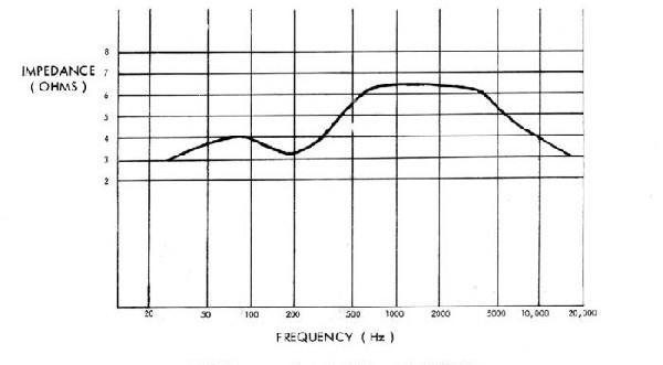

I would certainly be interested to see some imedance curves of the latest SL interfaces, if you have them.
While I don't have the curves based upon the current Toroid II design, I do have one significantly more up to date than yours. While the scale is different, the magnitude from 80 hz to 10 kHz is no more than 3x. The sharp narrow bandwidth spikes are absent.
I can certainly accept the notion that the dual transformer design is not inherently responsible for more linear curves. I'm also including one for the Acoustat as found in Jim Strickland's white paper. On the other hand, show me a design using a single trannie that is as smooth.
While I don't have the curves based upon the current Toroid II design, I do have one significantly more up to date than yours. While the scale is different, the magnitude from 80 hz to 10 kHz is no more than 3x. The sharp narrow bandwidth spikes are absent....I'm also including one for the Acoustat as found in Jim Strickland's white paper.
Thanks!
Looks perfectly reasonable for an 8 ohm damping resistance across the HF transformer and 1.5mH in series with the LF transformer.
You seem troubled/preoccupied with "spikes" in the impedance plot; a short explanation may help.
The narrow bandwidth peaks in ESL impedance plots result from a parallel resonance between the transformer primary inductance and the sum of its winding capacitance and the ESL capacitive load. If there were no losses in the system the magnitude of the peak would be infinite. In real physical transformers winding resistance and core losses limit the magnitude of the peak to something generally < 200 ohm. I know you feel these peaks in the impedance are something to be avoided. But all things being equal bigger peaks mean a better, lower loss, lower distortion transformer core.
In the example A3 impedance plot you posted, you can see both transformer peaks. The LF peak is somewhere below 20hz and has no extra damping added to it, so it peaks out at something > 50 ohm. The HF transformer peak is around 3kHz and is broadened and limited in peak value by the choice of damping resistor value(typically 5 - 15 ohm) used in the HP filter network.
The Acoustat impedance plot you posted is from the early pre-ModC crossover. You can see the two transformer peaks there as well(80Hz, 1.5kHz). The LF resonance is not nearly as low in frequency as the SL which has nearly 10x higher primary inductance. In the pre-ModC circuit the HF transformer capacitor is in parallel with the main portion of the damper resistance. So the damping resistance in the HF transformer circuit is effectively shunted across the LF transformer as well. That is why both impedance peaks are damped. The ModC crossover changed this setup to improve saturation resistance for the HF transformer, but it no longer damps the LF transformer and you will see the LF peak rise in level similar to the A3 plot you showed.

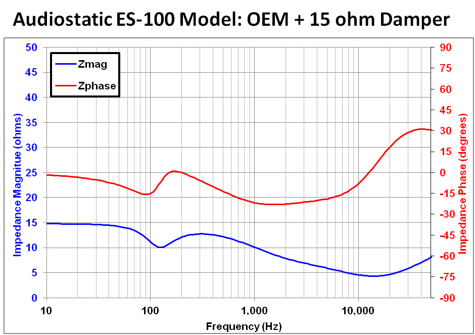

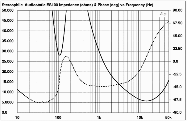

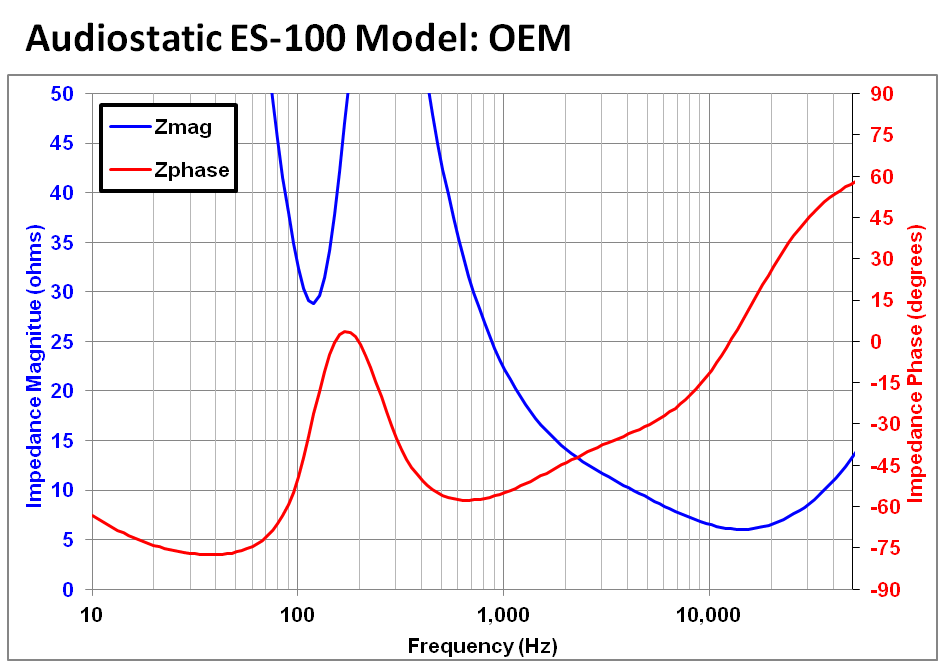

Since this is DIY, just add the damping resistance yourself if the impedance peaks bother you or your amplifier.
For example, suppose you had a pair of the ES100s.
Attachment #1: shows the impedance measured by Stereophile.
Attachment #2: shows the impedance modeled by SPICE(not a perfect match, but good enough for the purpose)
Attachment #3: shows the effect of adding a 15 ohm damping resistor

You seem troubled/preoccupied with "spikes" in the impedance plot; a short explanation may help...
They have no affect on the frequency response unless your amplifier source impedance is exceedingly high.
I would rather not be limited in amplifier selection while maintaining tonal neutrality. I prefer the sound characteristics of tube amps.
The damping seems to tame the nasty phase angle is well.

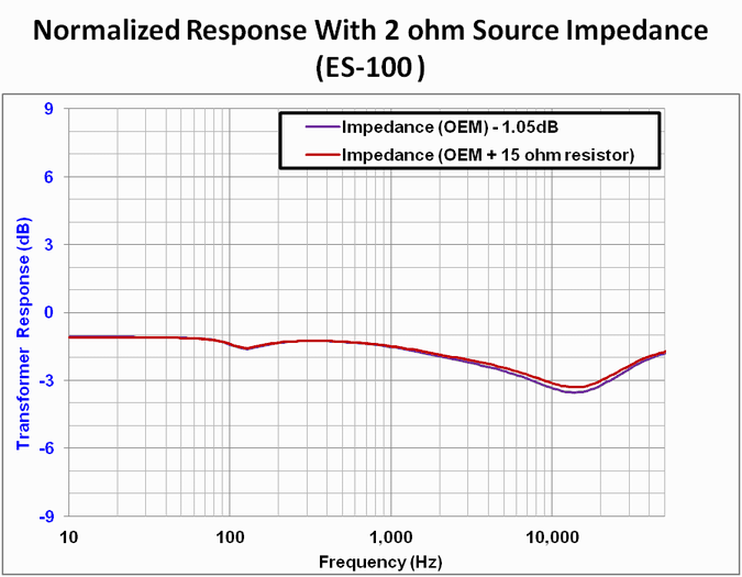

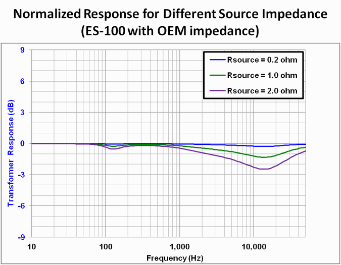

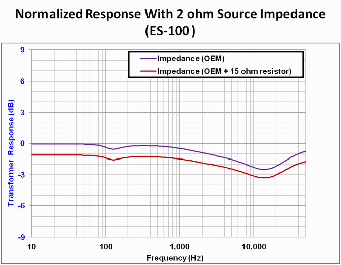

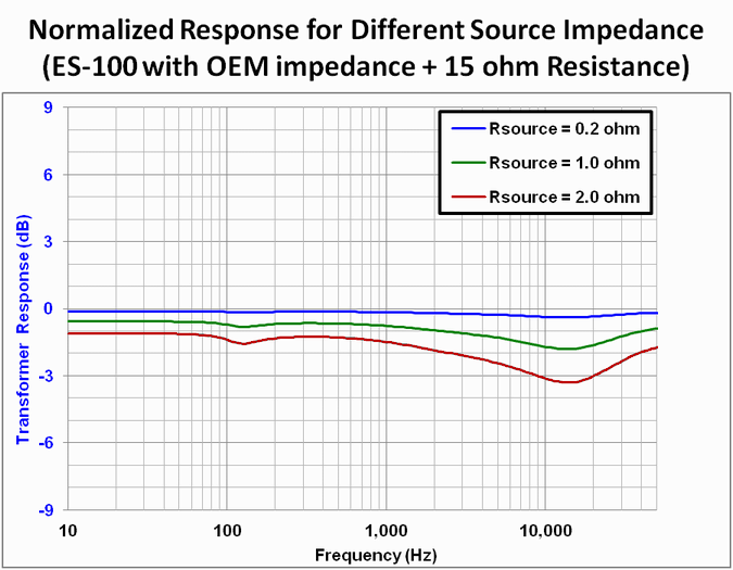

If the assumption is made that a given speaker is tonally neutral when driven by a SS amp with low output impedance, the higher output impedance of tube amps can change the response. However, it is only the frequency range where the impedance is < about 10x the output impedance that gets affected more than 0.5dB. This means that big impedance peaks do not necessarily cause peaks in the response when driven by tube amps. I’m not sure exactly which tube amps you prefer, but the VTL amp from post#19 has output impedance in the 1ohm – 2ohm range. To quantify the effect, I threw together a few plots to compare the ES-100 from post#55 with and without the damping resistance added. The 0.2 ohm curves are meant to represent typical SS amp when wire and contact resistance is included.
Attachment #1: Shows how the response is changed with increasing source impedance for the OEM configuration of the ES100 where the impedance includes large peaks. Note that below 1kHz where the large impedance peaks are, the response is essentially unchanged even for the 2.0 ohm source impedance.
Attachment #2: Same trends as in Attachment #1, but with the 15 ohm damping resistance added to the OEM configuration. Note that since the whole frequency range has impedance below 15 ohm the entire response is affected by the source impedance. The hope/thought is that by minimizing the impedance peaks, the overall response trend will by flatter.
Attachment #3: Compares the 2.0 ohm source impedance curves from Attachment #1(purple) & #2(red). The most obvious difference from adding the damping resistor is a loss of about -1dB in output. It is difficult to say if one curve is flatter than the other.
Attachment #4: To facilitate comparison, I subtracted -1.05dB from Attachment #1 curve(purple). Now we can see that adding the 15 ohm damping resistor did indeed make the response curve slightly flatter in the top octave, by about 0.25dB. I must admit, that is not as much as I had expected.
It does, which may be a better reason to add some amount of damping to ESLs. Most transformer driven ESLs have a combination of low impedance and high phase angle somewhere in the top couple octaves. This combination can cause problems with feedback amplifiers having low stability margins.
On a related note, google found this comment concerning SL ESLs and OTL amps:
"...I measured the impedance v frequency on my speakers with the modified set-up, and across the frequencies from 50Hz to 2000Hz, it does not dip below 20-25 ohms. At 5kHz it's about 8 ohms and gradually rolls off at 10kHz and 20kHz. Roger West pointed out to me that there is a sharp impedance (not frequency response) peak between 200Hz and 300Hz. Big deal! If it's there, it causes zero problems for my OTL..."
