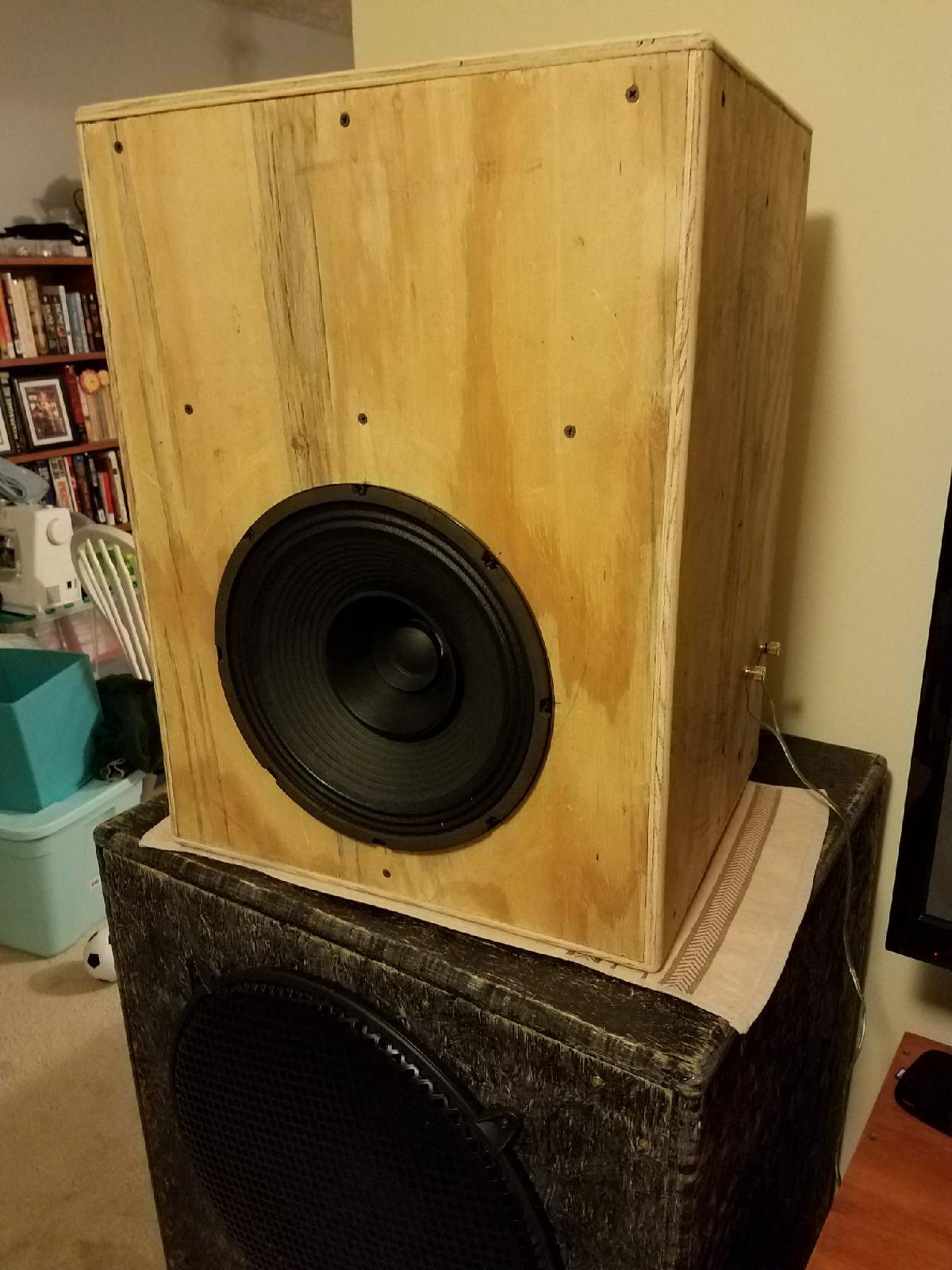

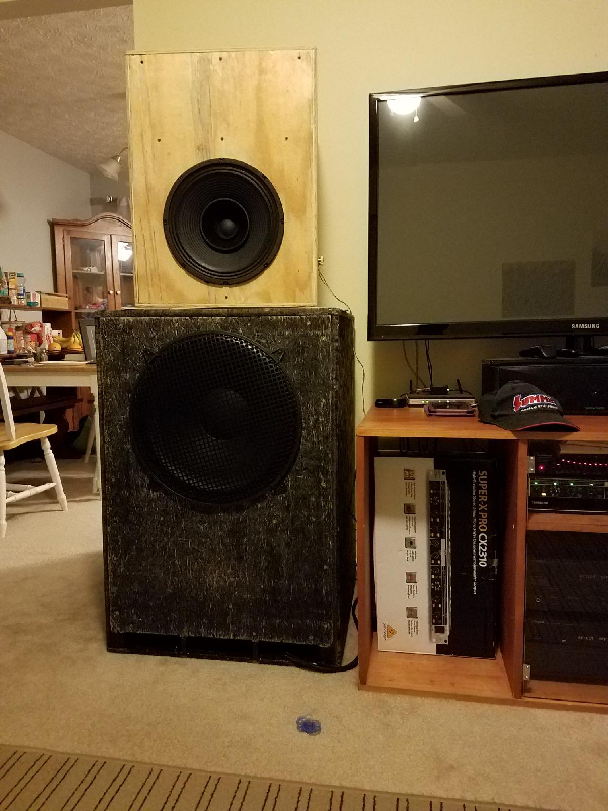

Ok, just got the first fane into a sealed box, with minimal stuffing inside (leftovers from helper woofer cab). Sounds pretty good, frighteningly loud, lol. Played with eq a bit and dropping the 4k a bit seemed to tame the shout to a reasonable level - its certainly nowhere near flat, as anticipated, but its fixable.
It does sound best off axis, the tweeter level highs on axis can be a bit much. I'm thinking a bit more eq, and of using a type of acoustic lens to spread the pinpoint highs a bit horizontally. You guys remember the old slant plate design that JBL used? That's my intention.

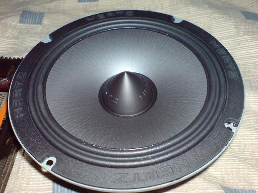

Visaton B200 has the same issue. Dustcapectomy & phase plugs added transform the driver.
dave
that double whizzer Fane has a papery extended high-end on axis and sounded good tho no low end in my K12 (about 35L back chamber) with bonded Dacron damped vent slits - no perceptible "boom". K12's aperture would have little effect upon the central HF beam. A Harvey & Kock style plate lens would be worth a try - are you going to try covering most of the speaker at first? - or a mini lens to take care of only the whizzer and inner cone area? (seems natural)
A K-tube can be suspended right in front of the whizzer - just far enough never to be bumped by the cone - would be goofy with a direct radiator (that did work to some degree in an 8 inch klam to pipe the highs out of the chamber)
Dave, i had thought about making a phase plug for the fanenn but wasnt sure how much sound was produced by the dome of the dustcap itself (like a dome tweeter?). Also, plenty of reading on folks cutting on the 12lta, but none that I've seen on the fane 12-250tc.

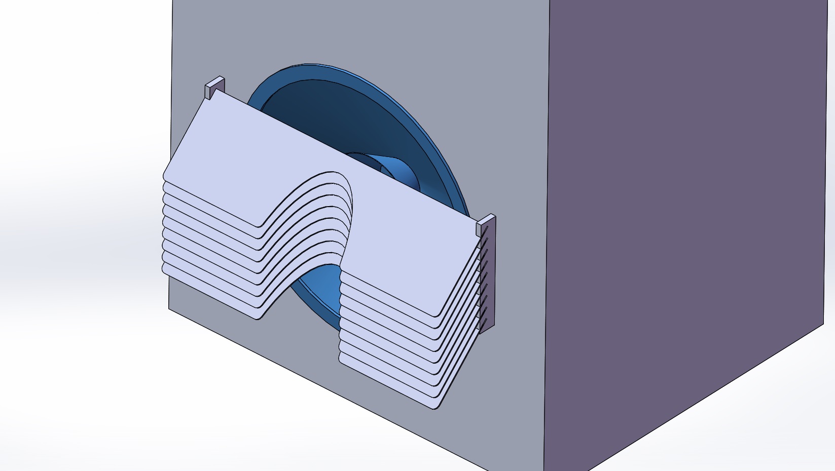

Something like this is what I was picturing for the acoustic lens. I need to dig into the design stuff more, all I've found thus far is that the space between plates is the ceiling for the highest frequencies affected, 1/2wavelength = space between plates. So 5/16" should cover up to about 20k Hz. Angle and overall length (depth) of the plates would affect what the time differential coming off them would be, and thus what the degree of "bending" would be. Width of the plates, I'm not so sure... but they do mention them needing to be open on the sides, maybe just to avoid reflections? I need to find that fellow Freddy mentioned next I guess, if I'm to go that route.

I didn't find any math for them when I was looking, I was looking at the same document you found. Here's the full document:
http://www.tnt-audio.com/clinica/acoustic_lens.pdf
Here's that fellow's rendition of it:
[DIY] Small Acoustic Lens
And his design, which he was kind enough to put the plans up for:
http://www.tnt-audio.com/clinica/plan.pdf
I'm not sure what his level of expertise is with these things, maybe he is well known over here or in similar circles? At any rate, he seemed rather pleased with them and their performance.
Here's a JBL ad for them:
https://i.pinimg.com/originals/ee/b8/7d/eeb87d1d590fe561b68036a36417b03c.jpg
which shows the slant plate design and also shows the corrugated plate design.
Initially I was going to pursue the corrugated design thinking it would be easier to just cut out some corrugated roofing sheet metal or something, but I didn't find anything I quite liked after looking at the store.
Here's another JBL ad for them which also shows the perforated sheet design:
http://www.lansingheritage.org/images/jbl/catalogs/1974-pro/page18.jpg
Fundamentally, all 3 designs do the same thing. I considered all of them at one point or another - a simple horizontal lens would be easy to do with the perforated design and a few sheets of it which could be just clamped together with spacers for experimenting. Ultimately, I didn't have anything laying around that I could use to make one, and did not find any formulas or direction on how to design one for X amount of dispersion, given an input dispersion of Y.
