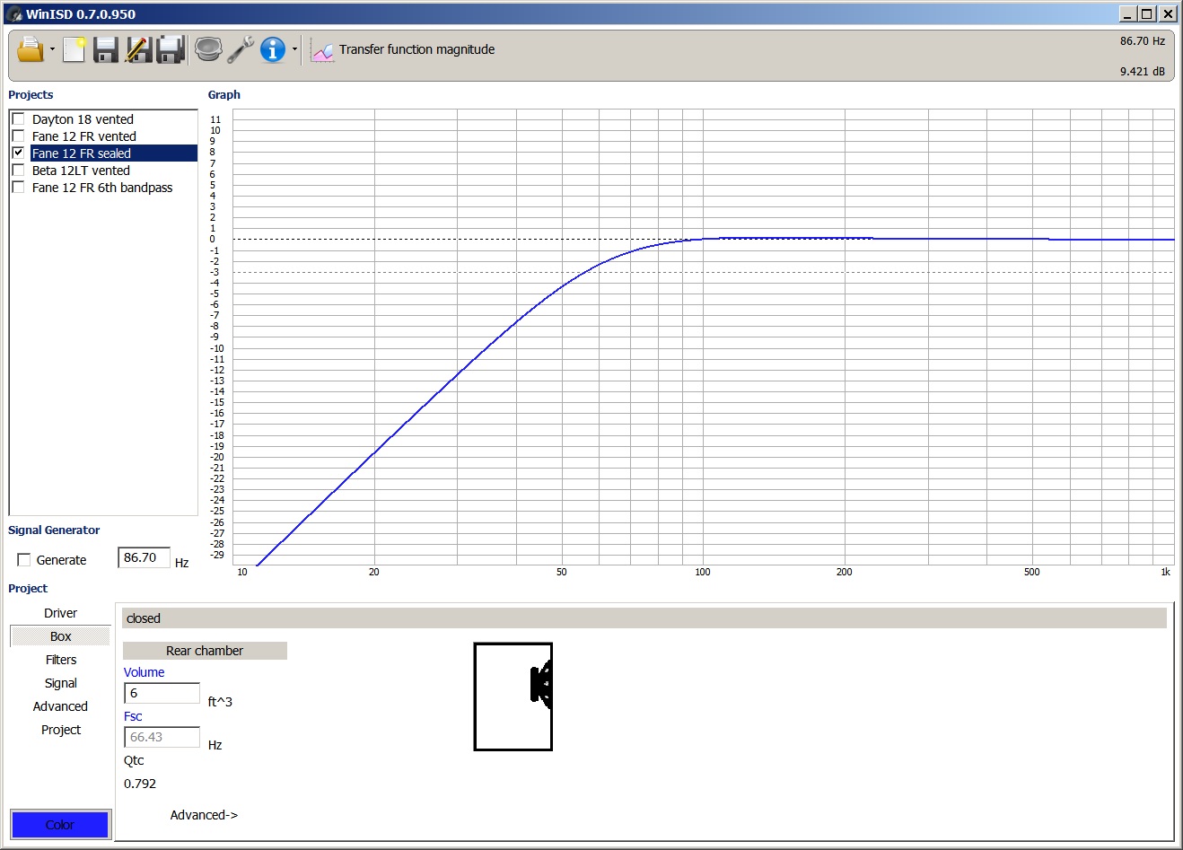

The rest of the full range duty will be Fane 12-250TC drivers... They seem to want a rather large box if sealed, like 19 ft3 for qtc=.707... qtc = .792 with 6 ft3, that might be enough... Bass reflex, they seem to be rather peaky due to the somewhat high qts, unless tuned low/small box to compensate, which pushes them towards a sealed response anyway...

Sealed does look fine for the Fane, just big cabinets... why didn't I check this before? I think I just looked at the Mfr recommended box size of something like 1-2 ft3, ha! Looks ok to me in a 6 ft3 box, 4 ft3 as Dave said seems to be pushing it, qtc = .846.

Yep, that's what I'm using in winISD.Qt = 0.64 on the datasheet i downloaded today.

Ah - I think we just have similar/confusing terminology, Qtc is total Q including box from winISD, Qts is total driver Q from Mfr. I was speaking in relation to hitting a "flat" tune of Qtc = .707, with roughy a 19 ft3 box - where the 6ft and 4 ft3 boxes had higher, somewhat overdamped Qtc values up around .792 and .846 respectively, when loaded with that Fane.Correction was only due to your earlier reference of Qt - 0.846.
My sim said an undamped box of 354 litres = 12.5ft3.

I'd venture to guess that its human error on my part... I'll double check all the entered parameters, that's a pretty big differenceMy sim said an undamped box of 354 litres = 12.5ft3.

Thanks Dave, will do. Is there a setting or anything obvious in winISD that I may have set wrong that people typically screw up? For instance, I don't have any options under the advanced tab clicked - like "sim VC inductance".
