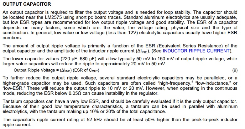

According to its DS, LM2575 has output ripple (52kHz typically) of around 1% of the output voltage. Hence 50mV for a 5V supply.
My Popu digital amp has an ADC which is fed from a buck reg (might even be an LM2575) and the dynamics sucked big-time on the analog input until I installed an LC filter on its power rail.
The datasheet says noise can be reduced by using >680uF on the output (min ESR is 0.05R) and that noise can be further reduced by a factor of 10 with a second LC filter of 20 μH & 100 μF. It's still going to be noisy though eh. But the efficiency means no heat issues so ... :(

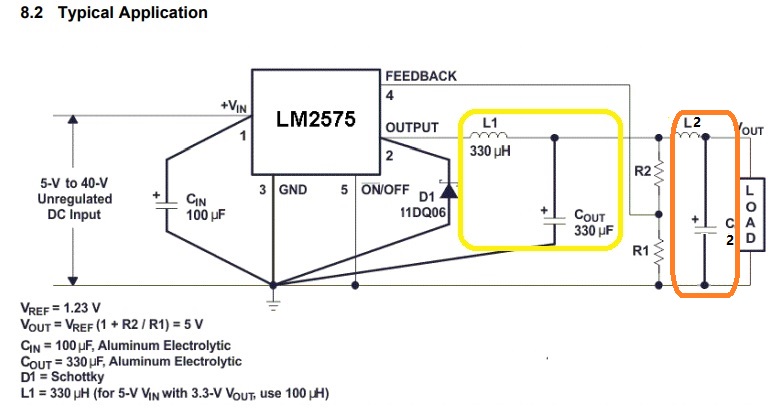

from LM2575 datasheet - extracted the description & a schematic -
the recommend 1st pair of LC is now highlighted in yellow box.
Abraxalito, I guess you are regarding 1st pair of L and C (1mH L and a low ESR 'lytic (Nichicon HZ) right? what L C value is approriate?
Nanoloop, the 2nd pair LC (20 μH & 100 μF) modded in orange box - is it correct?

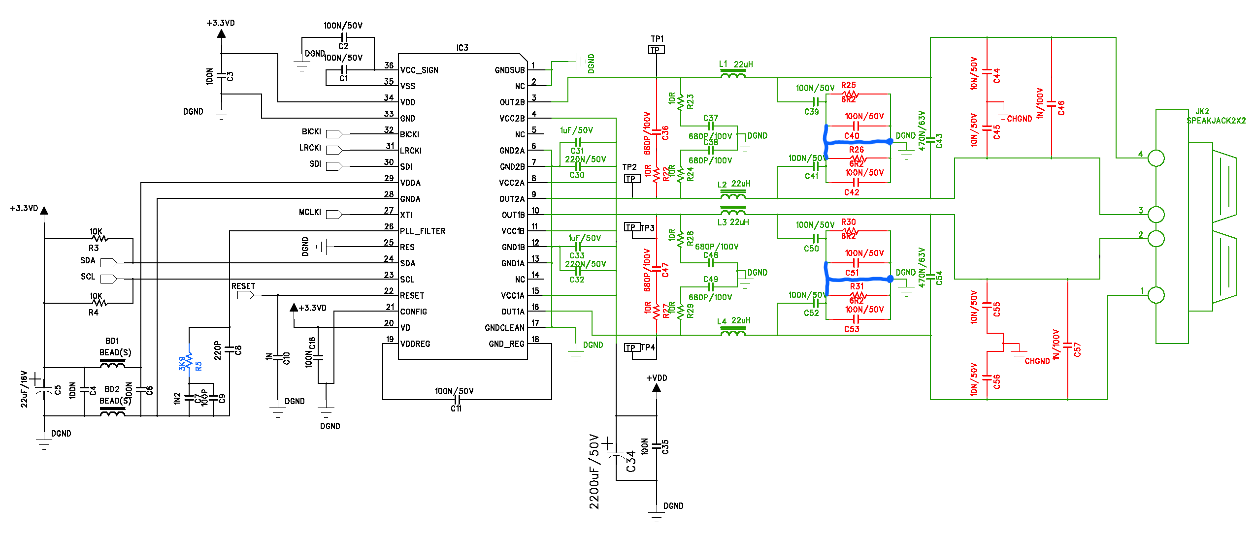

Anyone can make a guess what are functions/impact of the remaining red miss parts in these 4 areas (as pointed by Red arrows) - D8 removed them & had the blueline shorted to ground.
I intend to restore the snubber filters in yellow box, not sure if it is worthwhile to follow-thru the remaining 4 red areas
Datasheet Fig 28 suggests the output inductor should be either 33uH or 47uH for the load (about 200mA in my YJ, maybe higher in the D8). My YJ has 33uH. This value is dependant on the load and the graph has shaded out 1mH - I assume that's because the load would need to be very light not to cause oscillations.
The output cap advice is as large as possible but with an ESR no less than 0.05 ohms. For a low ESR cap like Panasonic FM, that means an 8x11.5mm size which is at best a 560uF 6.3V cap. For Panasonic FC it can be a 1500uF 6.3V 10x20 or 12.5x15.
The second filter looks correct - no specific details given.
Bear in mind that this will give, at best, about 1mV of ripple/noise at 50kHz. This is still very noisy.
All of those parts (everything after the inductors) make up the output filter which removes the digital "noise" from the analogue signal. You can Google "BD output filters" and read the pdfs from TI to find out more. TI also do a spreadsheet that has an output filter calculator if you want to design your own, or model the D8 design. You can download it for free. It's very handy for getting the filter to match the speakers. LCFILTER-CALC-TOOL Class-D LC Filter Designer | TI.com

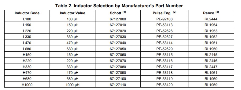

To help my amateur-level in understanding:
Referencing fig.28 & Table 2 for LC -
"This value is dependant on the load and the graph has shaded out 1mH。
Using YJ 5V@200ma as example, either 33uH or 47uH"
33uH/47uH correspond to less than 100uH (frm Table 2 that would be inductor code L100), cross-ref to fig 28, meaning bottom-right corner of low input voltage + high load current?
or for YJ, Vin cld it be 12V, to 5V@200ma, gives something like L680 ie. 680uH?
another question is: say nominal load 200ma, but let say we pick inductor for 400ma (factor max load case). Using inductor for 400ma, what impact when the load at 200ma?
