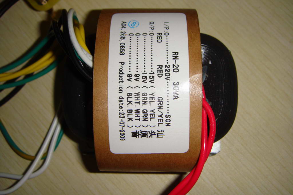

how about this R-CORE transformer ^_^
What a nice transormer :) Are these for sale too? Do you have another transformers? I used to souce them from USA, but these could be interesting.
Hi S3TUP, I don't suggest buying huge transformers from CN,for the shipping will cost tooooooo much ^_^
but for a 30VA transformer,$30 is enough for one including airmail shipping
I know that the AC voltage in USA is 110V,but transformers in CN provides 220V most of the time, that is to say, you may need 'custom made' ... time and price will increase ...

Hi bbp,
are there any kits left of the TDA1541 OS DAC and the USB converter?
Here in germany at a store namend conrad a toroid transformer is available which has the following specs:
80VA, 2x15V main secondaries plus 1x8V/0,1A additional secondary winding.
Would this one be a suitable solution for powering up the DAC, or is 0,1A not sufficient for the digital part?

Hi martin,
Both DAC and USB convertor are available ^_^
For the transformer, 8V 0.1A seems not good for the digital part indeed, but it is safe unless your transformer is in very poor quality. The SAA7220 needs 5V/180mA=0.9W POWER, In my opinion, the 8V/0.1A from a 80VA transformer may provides more than 0.1A actually.
