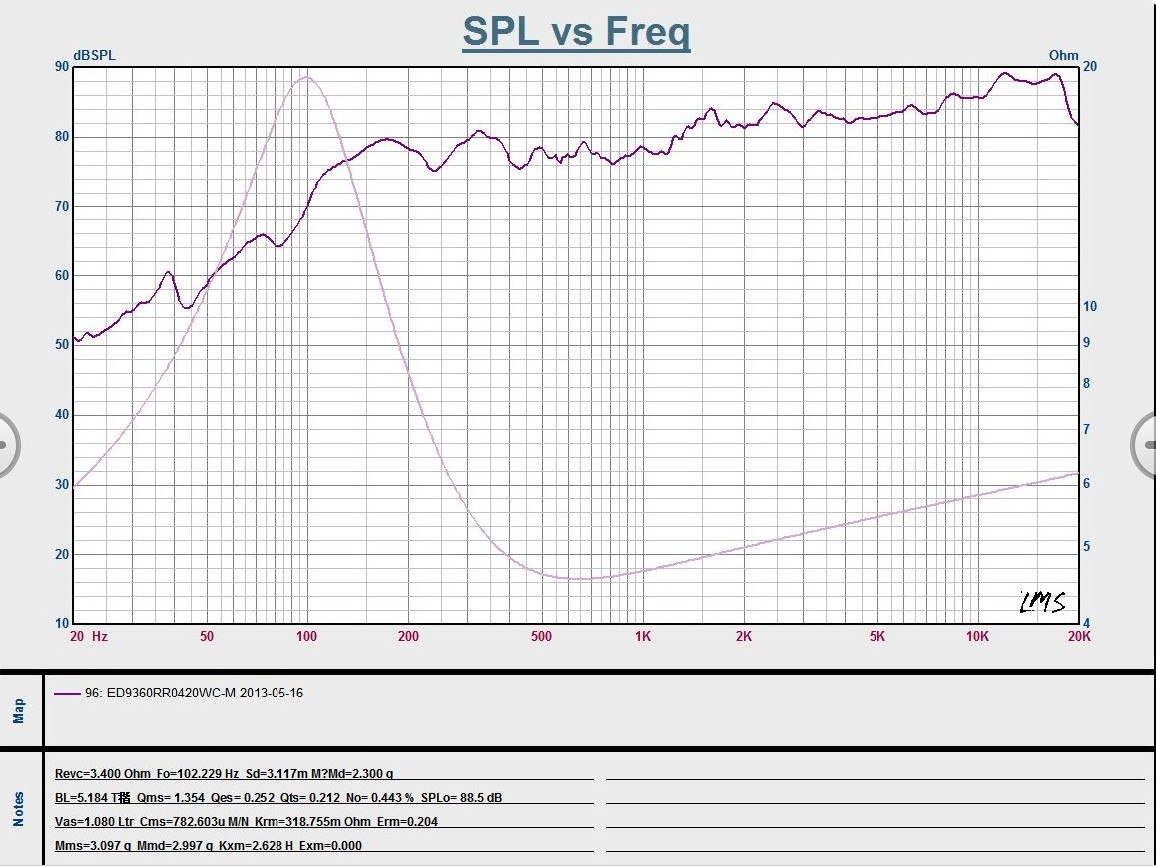

Are you asking if your driver could be used in the FH3 style box? If so you will have to post some data so the smart guys can help answer you.
The original test figure
The same size parameters and Fountek FR89EX
