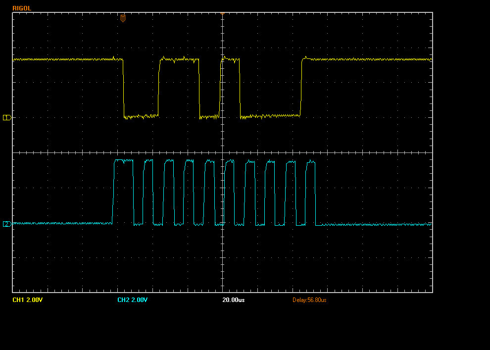

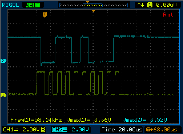

I am having issue with my second board, Ada doesn't seem to respond on i2c bus. Adau1701 is running and generates clock just fine. Eeprom can be written to and read from on the same bus. I even replaced Ada with different part to no avail. Also tried all available i2c adresses without any luck. Scope on sda and scl shows there is activity on both lines when I press read registers in sigma Studio.

Are you going direct (3.3V/SV2) or through the level-shifter (5V/JP3) circuitry? If I remember correctly SV2 (e.g. the USBi connector) is directly connected to the ADAU1701, whereas the I2C pins on JP3 are connected via a level shifting (e.g. 5v -> 3.3v) circuit.
I'd check for continuity between SV2 and the I2C pins on the ADAU1701 (22/23). If you're outputting a 5V I2C TTL onto JP3 - then scope at SV2 - do you see a 3.3V SDA/SCL?
Maybe try using an Arduino to poke the board using 5V I2C on JP3 - in case the traces to SV2 are damaged?
Thanks for the response, you might be onto something. The board that works is freedsp classic, the one that doesn't is classic smd one. I don't see level shifters between Ada and USBi on either schematics. It seems there are only between Ada and arduino. I'm not sure how classic works then without shifters... They both seem similar in that respect.

I'm confused. The classic will work with both 3.3 and 5V TTL for I2C as it has shifters. USBi: 3.3V and JP3 5V.
What is your I2C source ?
Which of the SMD boards are you using - balanced or unbalanced?
I'm using classic (working) and classic SMD A, both unbalanced. I2C source is USBi programmer.
In both schematics I see direct connections for SDA and SCL between ADAU and USBi connector. JP3 is for Arduino afaik, which I don't use, and there I do see level shifters (2N7000?). EEPROM is also connected to 3V3 on the same bus as ADAU and works fine without shifters.
Is classic SMD A supposed to work at all with USBi, if it does not have level shifters? Or is there 3.3V version of USBi programmer that works with classic SMD A board?
I think the usbi is a 3.3v part (I don't have one) as sv2 on the classic board is directly connected to the adau1701. Only the pins on jp3 go through the level shifter.

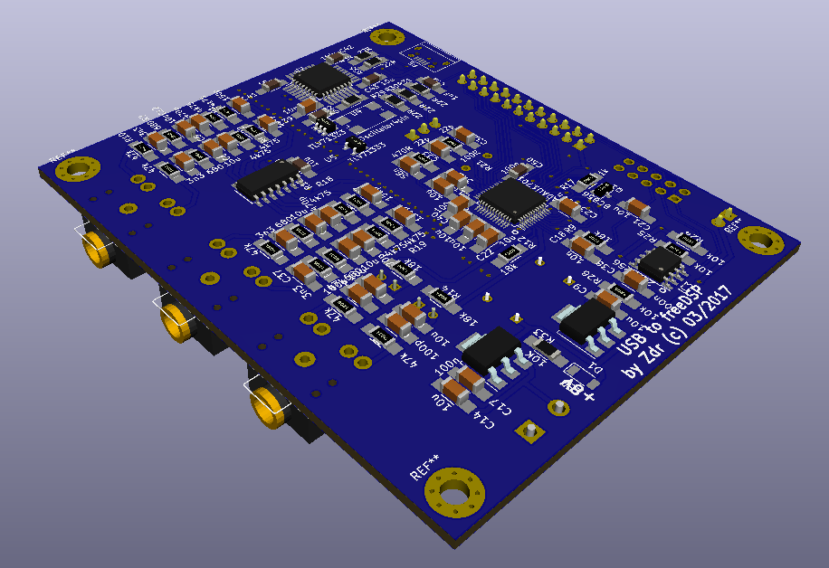

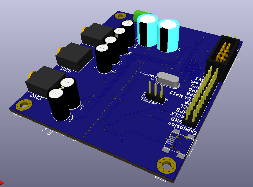

USB to FreeDSP PCB almost done.
What are you using for USB->I2S? My project is going to implement audio-widget as I understand it to be the most open isochronous platform for USB->I2S.
