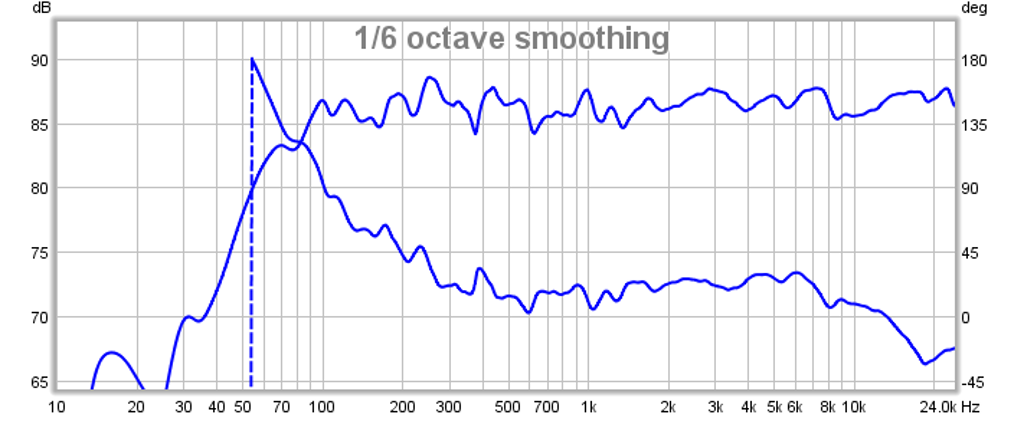

The good driver I have is like Zaph's measurement, as shown here:
And the bad one has the bass distortion hump centered at 80Hz that is twice as high.

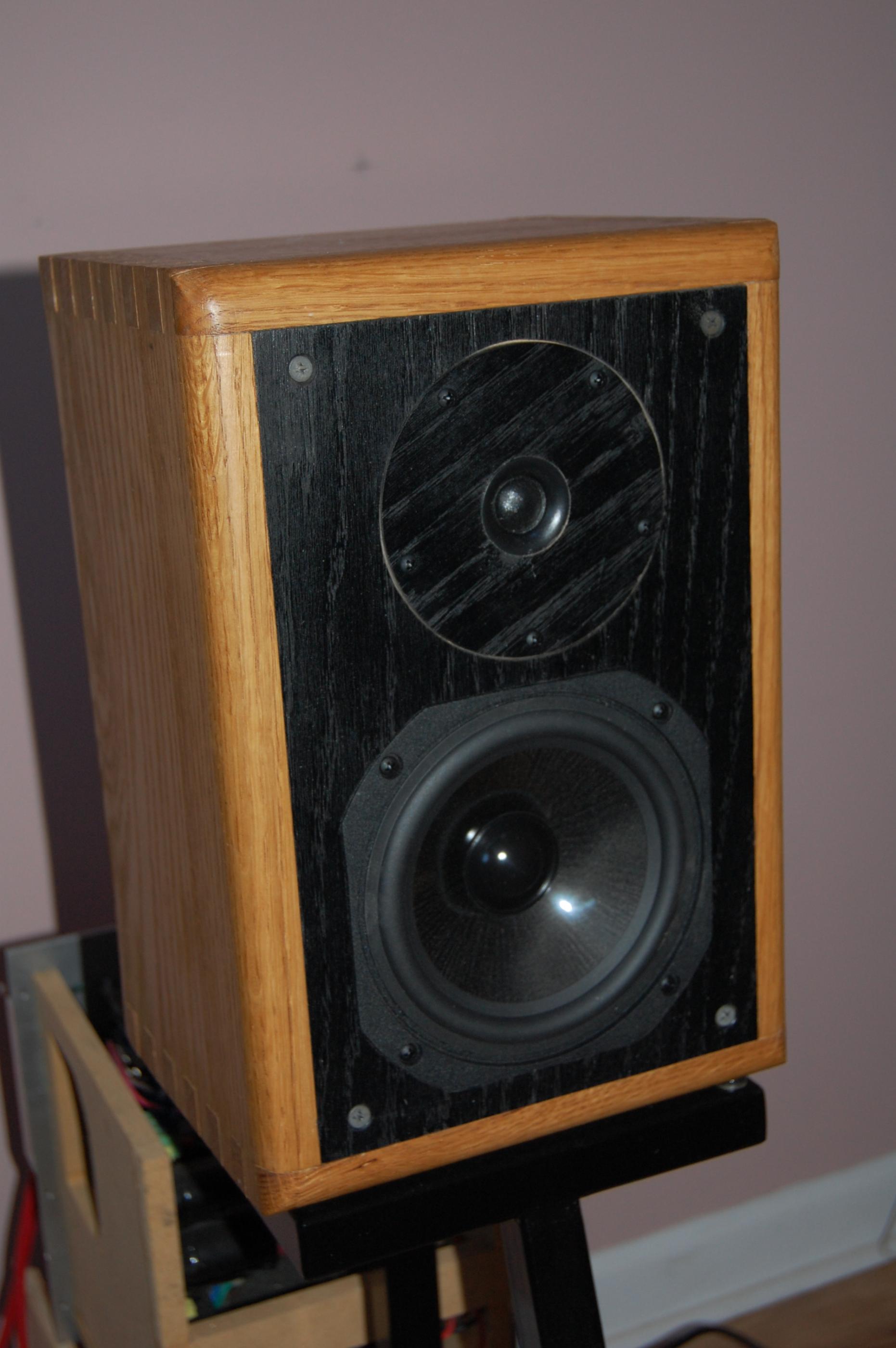

I have a pair of oak cabinets that I made a few years ago for some Royd drivers. size is 390cu".
After reading your thread and other comments about the AC130F1, particularly the Continuum positives, I decided to assemble a pair with some Dayton ND16 tweeters. Crossover is presently LR4 at 3500Hz and sound really, really good.
The AC130 is super smooth up to 5khz, and then easily managed with a minidsp. Sealed and stuffed with Polyfill.
Probably the best bookshelf size speaker I have built. I will also try the FR58 and XT25 and maybe, if Santa is kind enough a pair of RS28A.

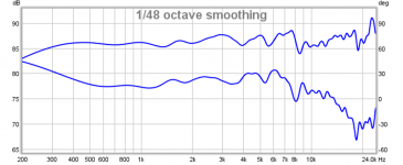

Stereo Pair Completed
I finally had some time to put together the stereo pair for this speaker. Some motivation was provided by seeing Pjblakey make his nice pair. Did not take long at all and glad I did. They image really well and the sound stage is super realistic. I may move them to my computer table next as near field monitors.
The stereo pair:

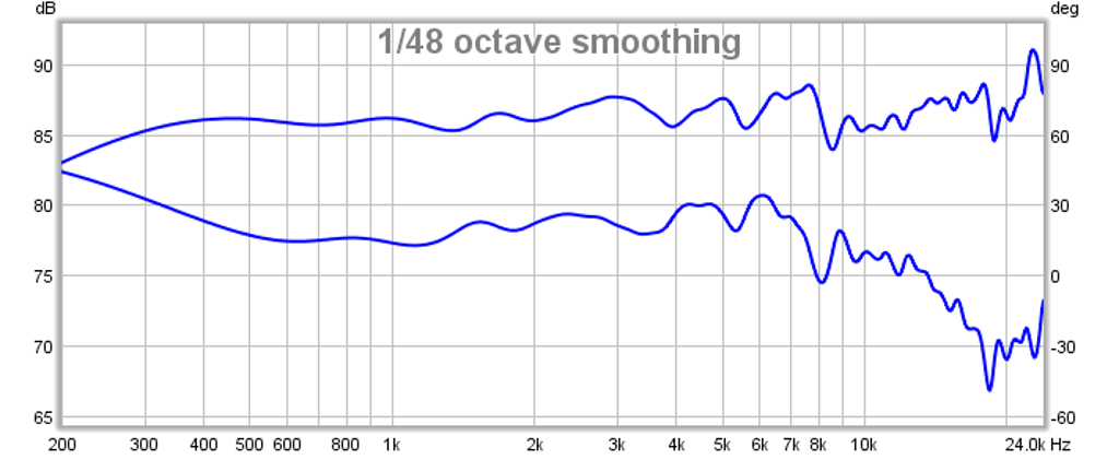

Here is the measurement of the response and phase on unit 2:
with 5ms gating - phase is about +/- 15deg from 350hz to 14kHz:

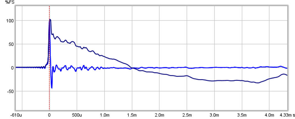

IR and SR:

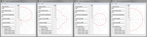

Because asked at all is as said FR58EX can do it verse a real tweeter and because you have nice fast configurable tool miniDSP.

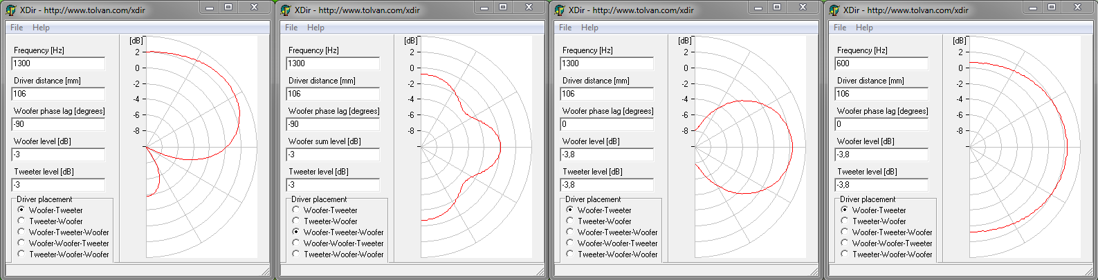

Picture 1 is vertical lobe at a single point frq (same as XO point) ctc spacing is set 106mm:
1. BW1 woofer/tweeter XO at 1300Hz.
2. BW1 woofer/tweeter/woofer XO at 1300Hz.
3. HARSH woofer/tweeter XO at 1300Hz.
4. HARSH woofer/tweeter XO at 600Hz.
First plot suggests if you turn speaker upside down should make some difference.

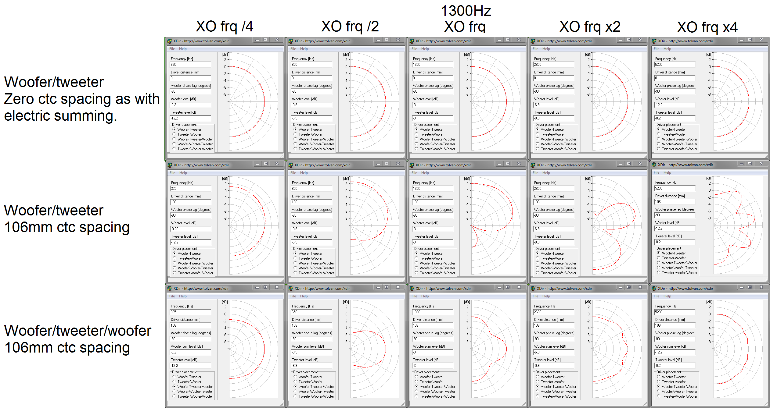

Picture 2 is not only at single point frq but also at 2 octaves below and above frq point. While all three configs show perfect same spl being 100% on axis and thereby linear phase, ctc spacing do make frq dependant lobe sectors. This was fun study and maybe show why Dunlavy use W/T/W config for his BW1 based speakers.
