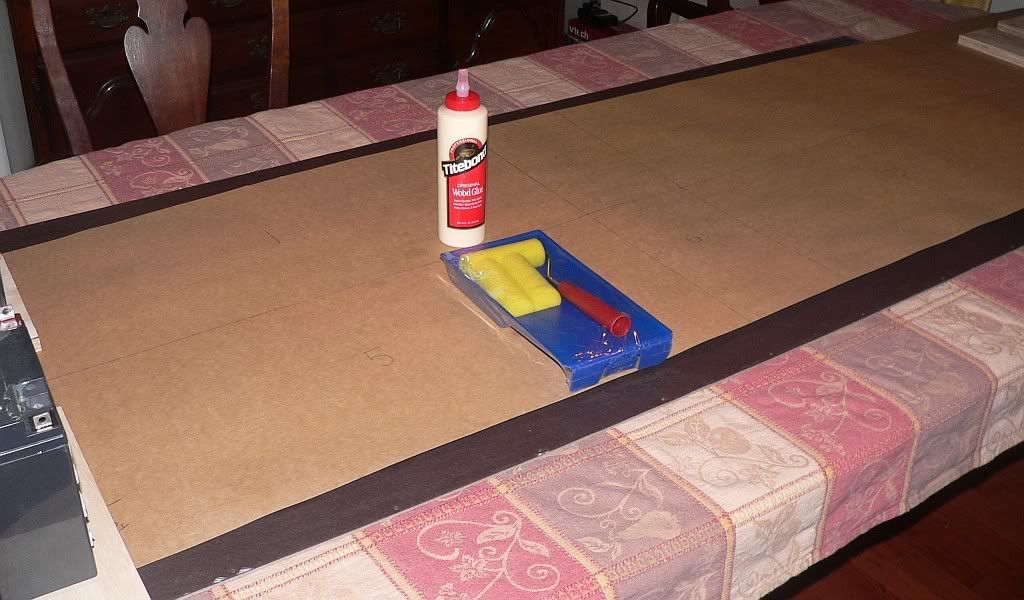

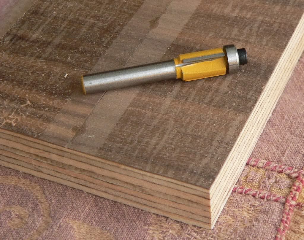

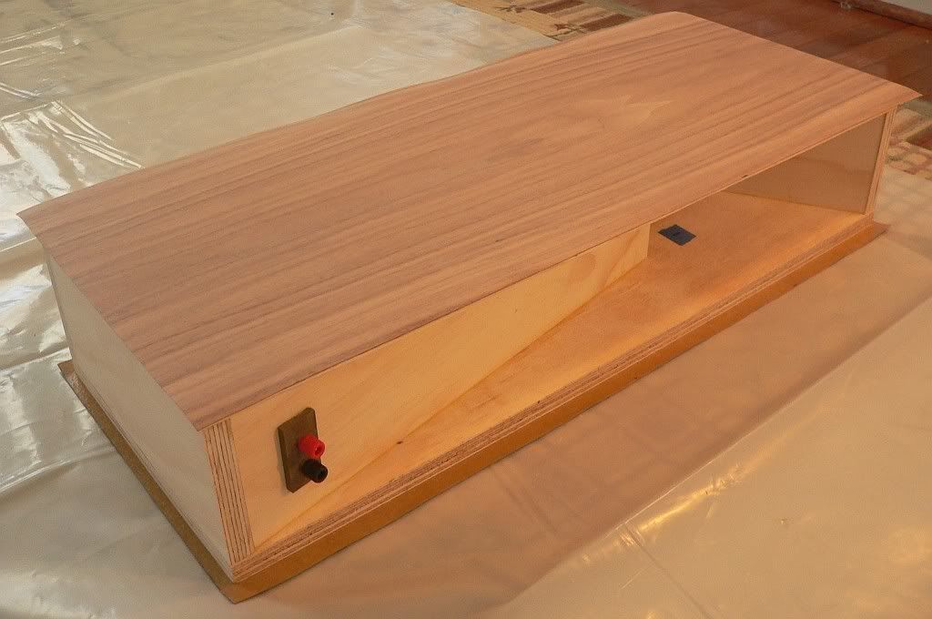

That day is getting closer. It won't be finished this week, but at least there is progress. I have run into a little snag. The sides went on quite nicely, but the fronts are from a different roll of material that doesn't want to lay as flat. I'm getting a fair amount of bubbles and ripples in the veneer, despite nearly 45 minutes trying to iron them out. I gave up for the evening and let them sit overnight. Can I try ironing them again, or has the glue already set for good?

I'd definitely wait until the glue has dried sufficiently before ironing. Veneering is much like hanging wallpaper; if they're only slightly noticeable, the waves that appear beneath the wood could actually be where the glue has pooled a little bit. If that is the case, they should disappear as the glue dries.
Larger bubbles are usually due to insufficient clamping. If you reeeeeeally need to take off the veneer and start again, use your iron's steaming function. Start steaming at one end and s-l-o-w-l-y start working the bad section of veneer off of the plywood. The fact that you used paper-backed veneer should make this a bit easier. Once the veneer is off, let your speaker dry a little, then use a proper sanding block to lightly sand the old glue down a bit.
Before attaching the new veneer, make a clamping caul out of a piece of cheap MDF. It should be the same size as the front of your speaker, or slightly larger. Apply the new piece of veneer like you did before, except this time place the caul on top of the veneer before clamping. The idea here is to evenly distribute the clamping pressure - and avoid the dreaded glue voids.
BTW, beautiful work so far! Mine have yet to be veneered, so they still look like deux-deux. ;)
Ty - I'd give a firm re-ironing at your iron's highest temp a try first - and don't be afraid of a little bit of scorching, as you'll be sanding it out with at least 150 to 220G before applying your finish. Just make sure there's no residual glue on the iron sole plate - I regularly take a RO sander and 220G paper, then green Scotch-rite scouring pads to mine.
Another possible cause of bubbles (as opposed to lumps) is too little glue applied to either / both surfaces. Plywood is especially absorbent and needs more than MDF. I personally have better success with the short pile "velvet" rollers than foam for this application, and always apply 2 thin coats in perpendicular patterns.
I set the iron to its highest setting. It seems I almost can't scorch the wood. I'll leave the iron in place for five seconds, then move it about 1/4". Repeat until the end. I'm using a thin cotton sheet between the iron and the veneer, so no worries about glue on the sole. For the smaller panels, I've switched to using a single sheet of typing paper. The paper does tend to yellow a bit, so I guess the iron is plenty hot.
I hope I've got enough glue. I have one coat on the back of the veneer and another on the cabinet. For the last few pieces I've used two coats on the cabinet. It seems pretty thick to me, but what do I know? The 16 oz bottle of Titebond was brand new when I started the veneering, and now it's all gone.

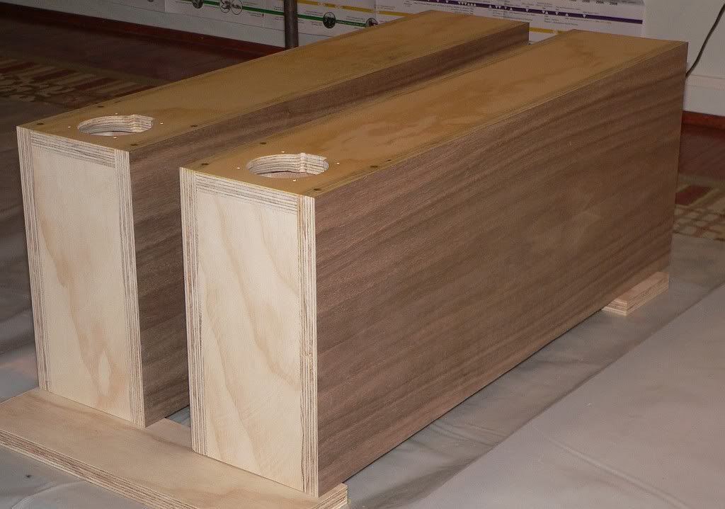

It seems to be turning out well enough. Once again, this project has had plenty of learning experiences. All five sides are now veneered. I'll leave the back naked, since it's too hard to dress the mouth of the horn. The bottom still needs trimming, then I guess I ought to sand everything before I stain and poly.
I was happy to see the magnets seem to be working. They could hold a little tighter, but it'll be good enough. I was concerned the heat from the iron might weaken the magnets on the cabinet. I used 1/4"D x 1/8" in the cabinet, and 1/4"D x 1/16" on the grilles. In hindsight, I wish I had used the thicker magnets for both. Maybe next time.

So, I start wiping on the first coat of Watco's, and what do you think appears? A bubble! It's about the size of a quarter, and smack dab in the middle of the front. Bah! :mad:
OK, now things get interesting - not the time to reapply the iron - those scorch marks would be much harder to sand out.
Try cutting a small slit in the direction of grain with veneer or utility knife and injecting a drop or two of white glue (great for cold pressing your veneers, but I wouldn't use it for structural work) with a syringe, then apply clamping caul and weight, and wait.
Well, for better or worse, I did hit it with the iron. I put a clean piece of white cotton cloth on top and kept the iron moving in a small circle. The Watco's oil, which was still only a few minutes wet, smoked a bit at first. I cautiously lifted the cloth expecting to see a weird mark or just have the cloth permanently stuck. Instead all I saw was that the oil had been dried or driven out. So, I ironed for a little while longer. Then I took off the cloth and pressed down firmly with a small wood block.

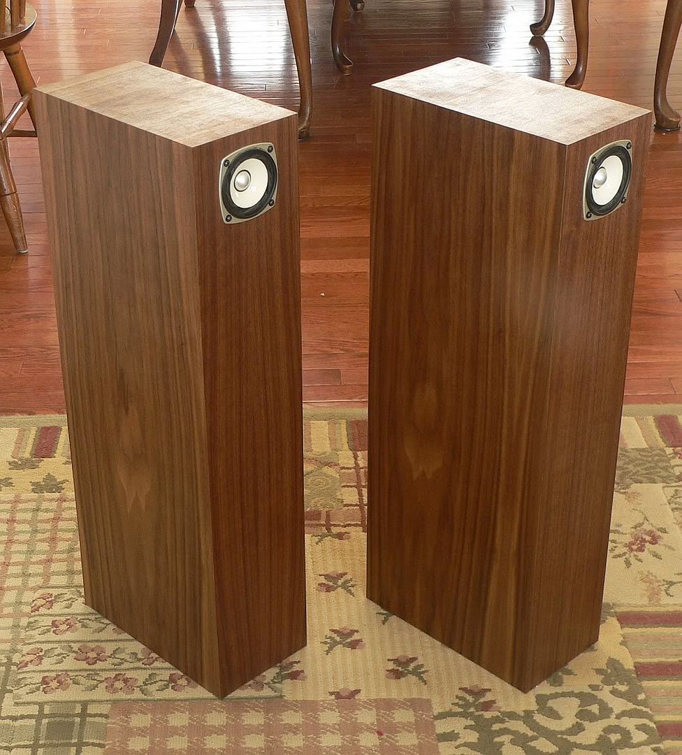

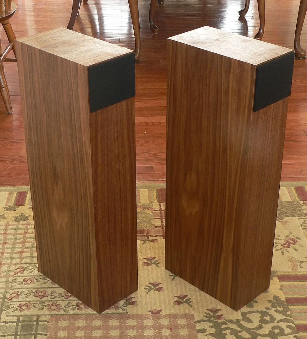

There's a weird little divot there now, but it's much smaller than it was before. Hopefully the veneer won't lift again over time. I've since oiled all the other surfaces, and thankfully no more bubbles appeared. I'll get a good look in the morning when the oil is drier and the sun is up.
I will say this much - Mr. Zenith was absolutely correct about the color of walnut. Once it is oiled, it's an absolutely beautiful wood. I can't believe I was considering using a stain on it. Thanks for talking me out of my foolishness!

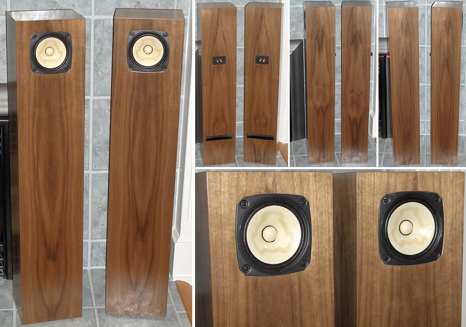

Chrisb: yours look great, too. They look like Buschorns from the front, but the lack of a large hole in the rear (there's a joke in there somewhere) leads me to believe otherwise... :D
