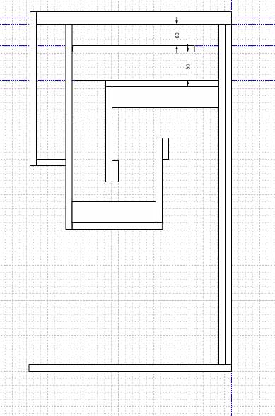

Carcass construction
I'm just sketching out the recommended cabinet carcass, I decided to double rear panel to remove those two "pillars" on the back and have now decided to add an extra layer on the top after the above comment?
As I'm about it? how about doubling the front speaker baffle - if any vibrations are to appear this must be a sure candidate!
On my cutting schedule, it looks like I need 4 (4x8) sheets of 18mm MDF (obviously with waste). Has anyone been more "economical" than this?

Re: Carcass construction
I'd recommend void free plywood (otherwise you are wasting 4 sheets of MDF). The difference isn't subtle.
dave
greenie512 said:I need 4 (4x8) sheets of 18mm MDF (obviously with waste)
dave

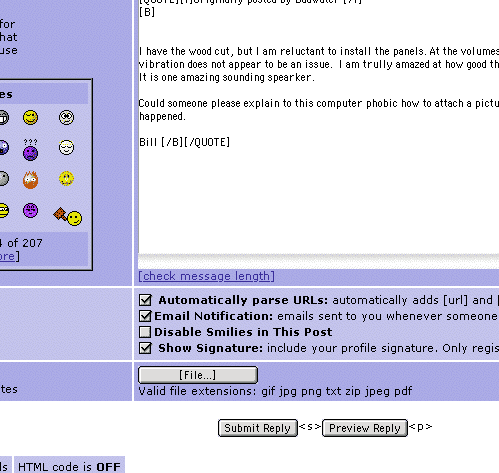

I have the wood cut, but I am reluctant to install the panels. At the volumes that I normally listen vibration does not appear to be an issue. I am trully amazed at how good this project has turned out. It is one amazing sounding spearker.
Could someone please explain to this computer phobic how to attach a picture? I tried and nothing happened.
Bill
Badwater said:Could someone please explain to this computer phobic how to attach a picture? I tried and nothing
At the bottom of the reply window is a button called "File". Click on it, it brings up a directory browser, select the file on your computer you want to attach (max 100 kb), click OK....
dave
Re: Re: Carcass construction
Dave - I wrote MDF without thinking. Are you specifically saying, with this design it's better to use plywood??.
Bill .. have your picture (jpg file) saved to your hard disk and when using the reply feature here, use the browse button (slightly lower than the text message panel) and click the button and locate/select the picture wherever you saved it on your hard disk - post reply - vola
Re: Re: Re: Carcass construction
No question... MDF is used because it is cheap, is easier to finish, and to machine. I've never really used MDF, but used to use HDF all the time. I now use ply in any critical application. If you can recycle some 40 or 50 year old plywood, it is usually even better.
dave
greenie512 said:I wrote MDF without thinking. Are you specifically saying, with this design it's better to use plywood??.
dave
