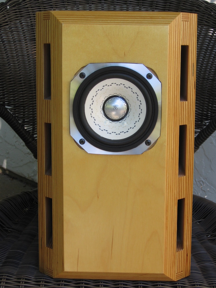

I would also highly recommend the F120a. I have many different Fostex drivers including the FX120 and F120a. The F120a is my favorite of the Fostex and, compared to the FX120, does a better job with low level detail and has better definition at the upper end of the scale. I've used both (FX120/F120a) in a 10-liter ported enclosure and the results are very good. There are two Fonken enclosures the Planet10 guys made available. I would try one of those as a step up for the enclosure.

Having built Metronomes w/ both FE108eSigma and F120A drivers, let me say:
-- The 108 is a very special diver! however, it really needs a sub to fill out the bottom end; and it will sound even better if you filter out the low end before it gets to the 108.
-- The F120A is even better than the 108; HOWEVER, it is very picky about the amp driving it! IME, most SS amps will make it sound very disappointing; it responds very well to tubes; so if you aren't prepared to use it w/ tubes, then don't bother.
