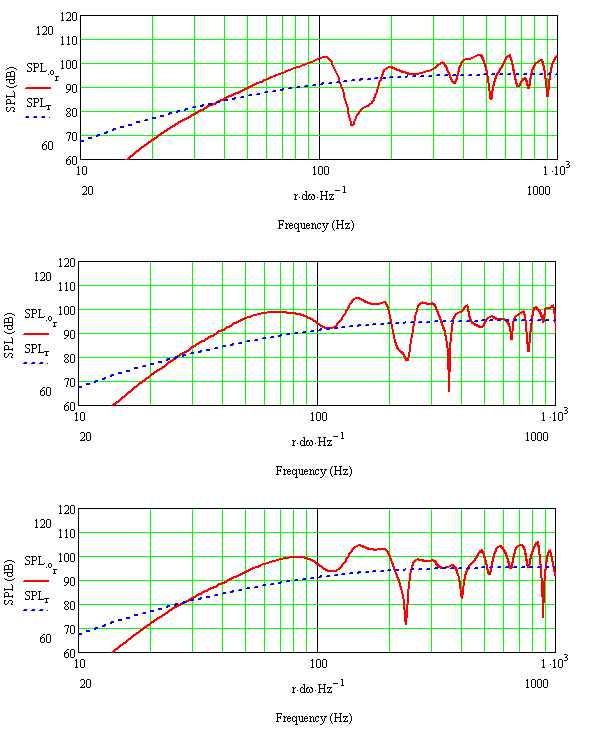

Hornresp does fine with back-loaded horns. You just have to remember to combine the direct radiator output with the horn output. I'll attach two sample SPL response plots that I made quite a while ago.
