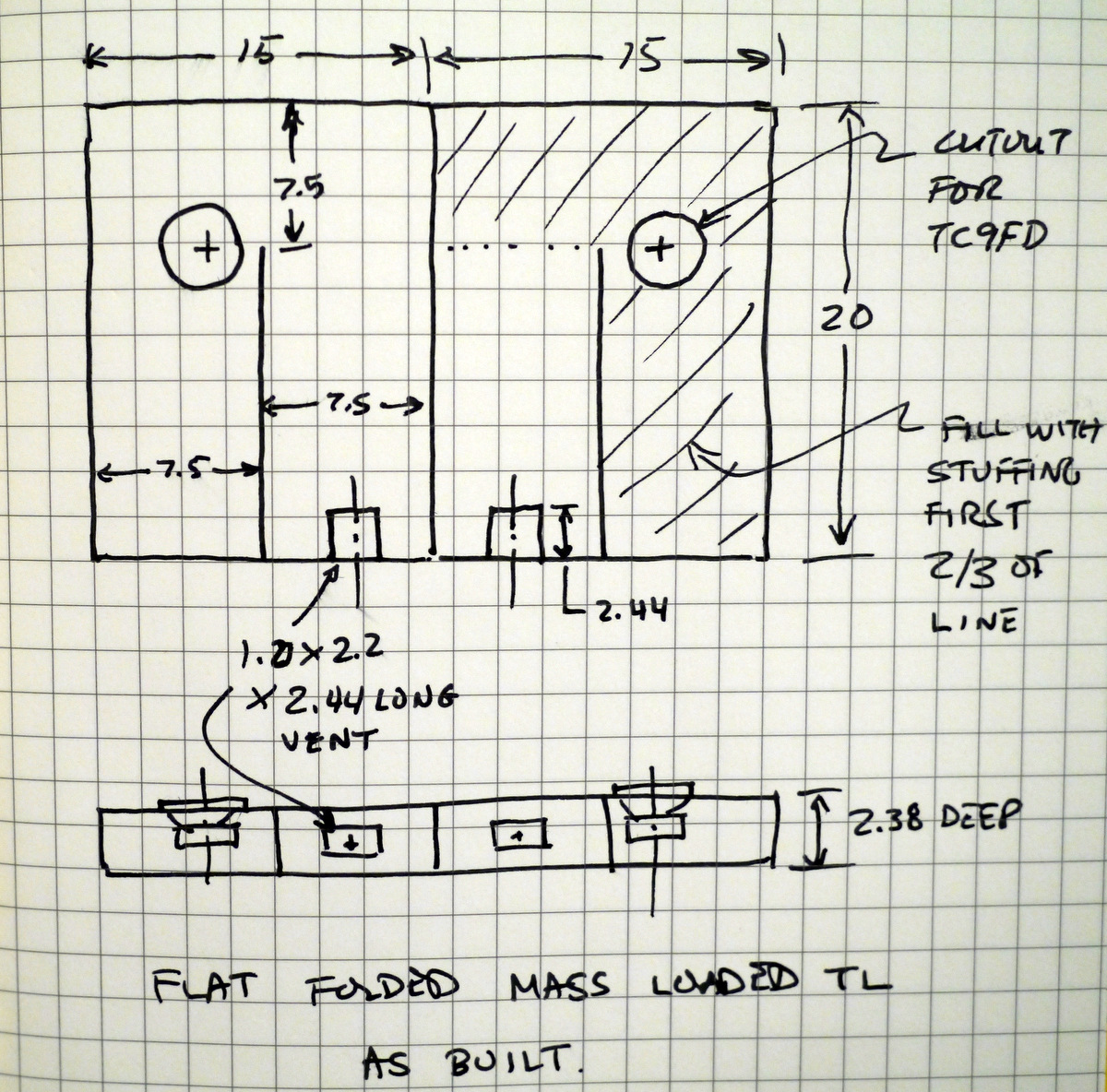

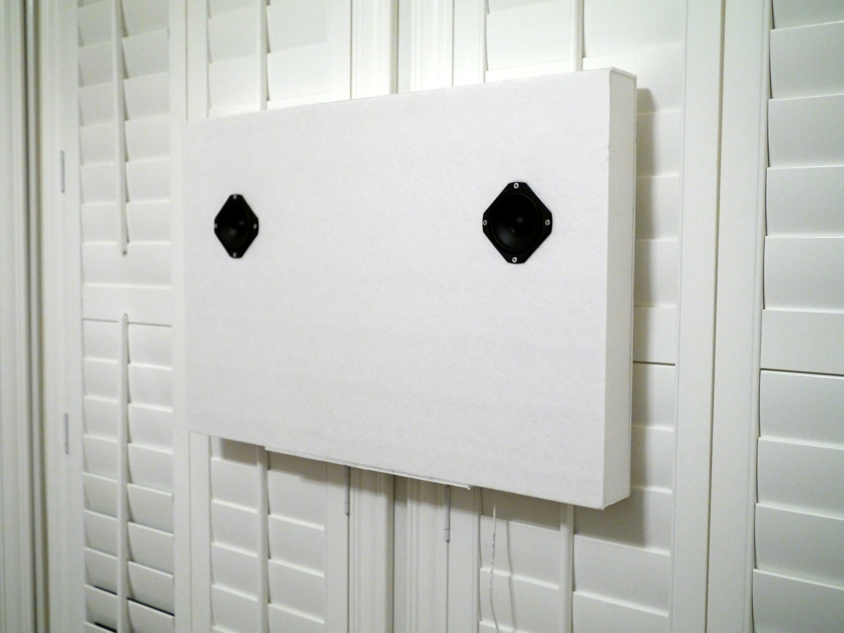

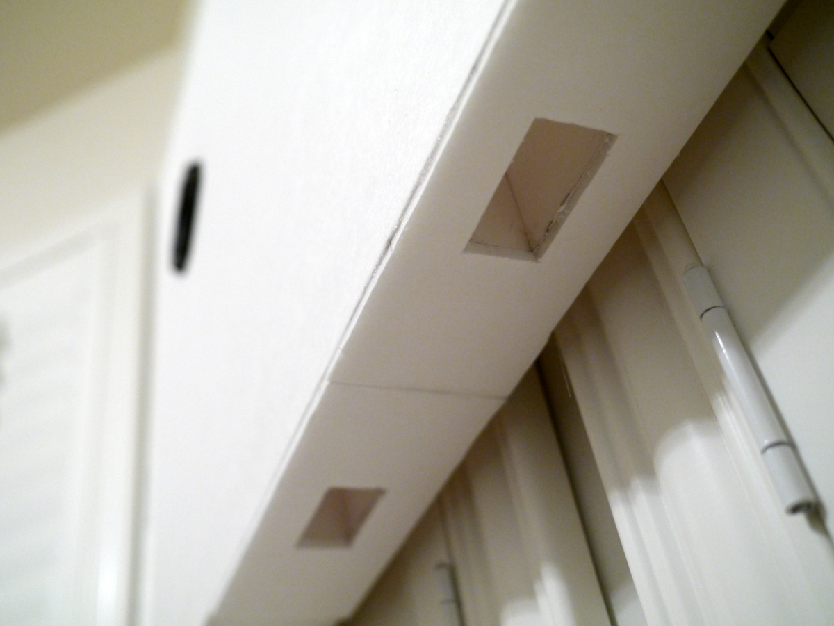

Folded Flat MLTL Stereo Speaker

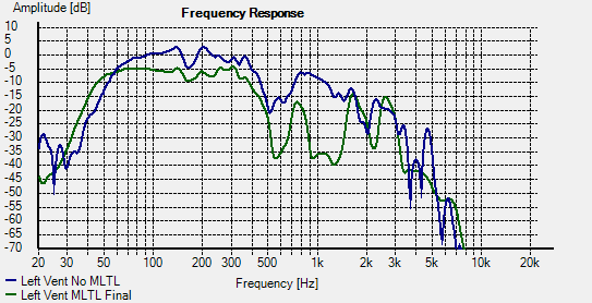

I modified my earlier folded TL stereo wall mount speaker to be a MLTL by adding a constrictor vent. The bass response is much better now. I did not do a full sim, I just ran WinISD to calculate a BR vent based on volume and added the vent at the end of the line. The TL has stuffing in the first 2/3rds and now reaches down into the 50 Hz region with tight punchy bass (see freq response of vent before and after constrictor vent was added).
How does it sound? It sounds great! Very nice office/bedroom speaker and gets quite loud with good stereo separation considering the drivers are about 2 ft apart. Once decorated with a painting or poster, it will blend right in. The bass is very good due to wall loading and of course, no BSC is needed.

Doesn't the measured freq. range looks "erratic" in the 400 to 2.8k Hz range? Maybe your enclosure design is more suited for a 2-way of a mid-bass or FR speaker with a tweeter?
Founder of XSA-Labs
Joined 2012
This is just the vent output. So that's just the higher freq components leaking out of the bass port - rather low level. Notice how constricting the terminus really reduces the HF junk. The majority of the mids and highs are dominated by the direct radiation of the driver.
