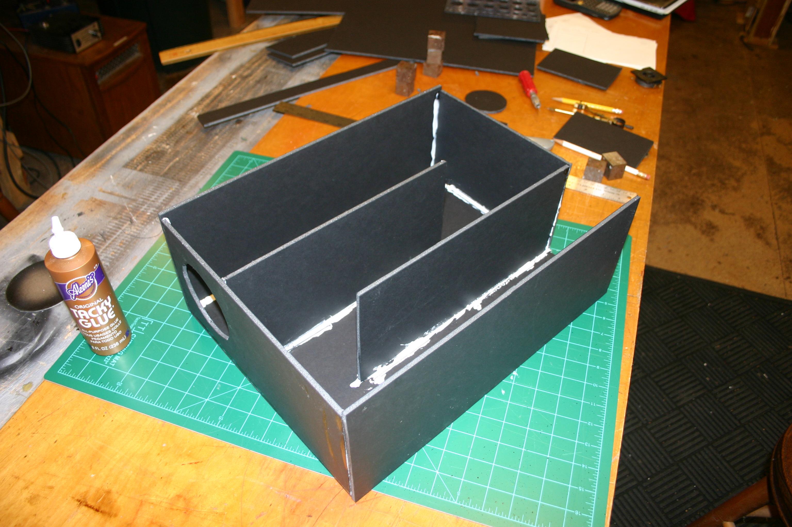

Foam Core Board Speaker Enclosures?

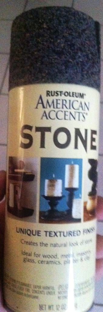

The after is nice looking - what kind of finish is that? How do they sound? :cheers:
They don't sound too good, as the drivers have not arrived. I ordered Tang Band W3-1364SA for them, but they will start shipping tomorrow. I also ordered TB W3-881SI to try them out. These enclosures were designed by Planet 10 for Fostex FF85WK, but those are will not be available until mid-March; I will order then. I have other projects pending where I can use the drivers that "don't make the cut".

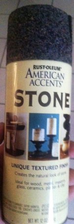

As for the finish, textured stone spray paint did the trick (see attached photo). I would have chosen something else, but I had 1/2 a can unused that I purchased to do some custom electrical switch plates my wife's decorator came up with. My wife and the decorator are experts at coming up with great ideas that no one sells or has, and I have to end up figuring out how to make them and/or install.

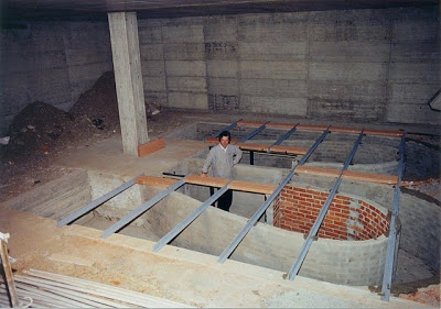

Where did you get this photo? Is that real? :D
xrk,
I had the same question. Since I had already gone over the edge with my Klisphorn references,:D I was doing a search for the JBL Paragon as another extreme horn design. That image came up but I couldn't discover any more information. I vaguely remember a reference in a book but can't find it now.
As far as I can see "largest" woofer returns two items:
Worlds Largest Driver
Worlds Largest Woofer

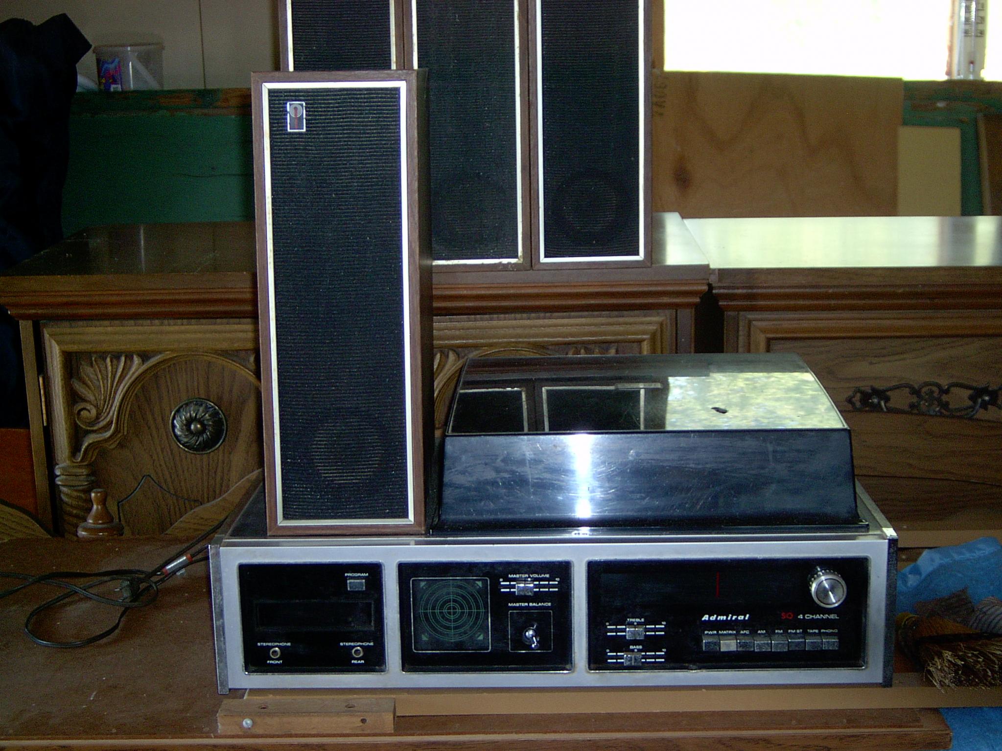

Here is my venture into the world of foam enclosures. Its the Admiral 1970s Tunnel Reflex also known as the Bull Horn. I was in engineering at the time and we had to get a license from General Dynamics to use the design. They had bought Stromberg-Carlson and owned the labyrinth patents. The tunnel is lined with 1/2" blanket batting and is not to be stuffed as the tunnel has to be open all the way. I will use a Visaton FR 10 and take some measurements.

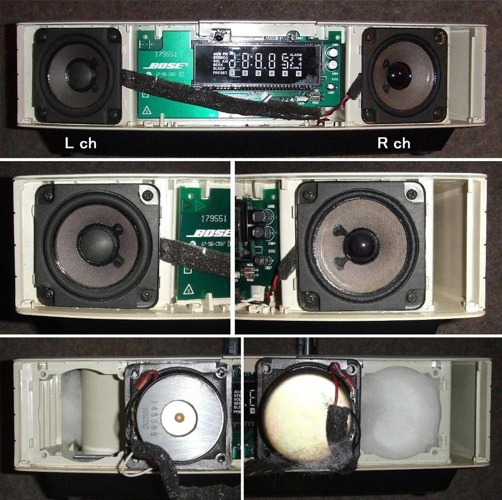

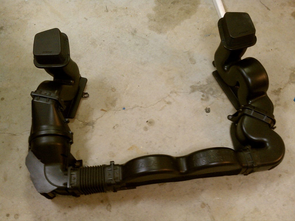

Bellow is the some pictures I have found on the Wave..
I have burned and awful lot of real Tunnel Reflex boxes. I'd never think of building one. Thy came lined with 3/8" felt on all the panels, and get better if you add stuffing.
BTW, if you find a real pair used, they cost about the same as the foam core to build a set, and come with FE103A.

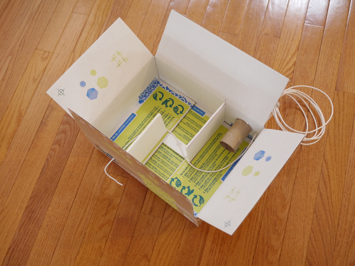

Reminds me of my much smaller 3-fold MLTL made of cardboard - uses 3.5 in driver. Post #1089 http://www.diyaudio.com/forums/full-range/223313-foam-core-board-speaker-enclosures-109.html

Admiral had a plant in Shelbyville, IN where all TV and stereo cabinets we made until they shut down in 1978. I was in field engineering at the time and made a visit due to some QC problems with color TV cabinets. They made the Tunnel Reflex there also, as I recall it was 3/8 plywood with a vinyl wood grain covering. The speakers were from a plant in Taiwan, not Japan. I remember seeing pallets of them ready for loading in the cabinets. I only had one set, ditched the cabinets and sold or traded ( cant' recall which) with some guy on line in the 90s.
frugal-phile™
Joined 2001
I cooresponded with the daughter-in-law of the guy (Jack Virva) who got the patent that these were based on.
I also got a pair of the drivers in those pallets. A variation on the ones i have pulled out of the actuall speakers i've gottenmy hands on (25+ pairs). All were versions of the Foster 4" driver known generically as the FE103A (same basket as the Fostex FE103 variants made until circa 2000 when they changed to the current basket. Foster has/had factories in Taiwan & S Korea for the less expensive stuff.
There was also a larger version with a 5" driver (a Coral OEM i believe)
