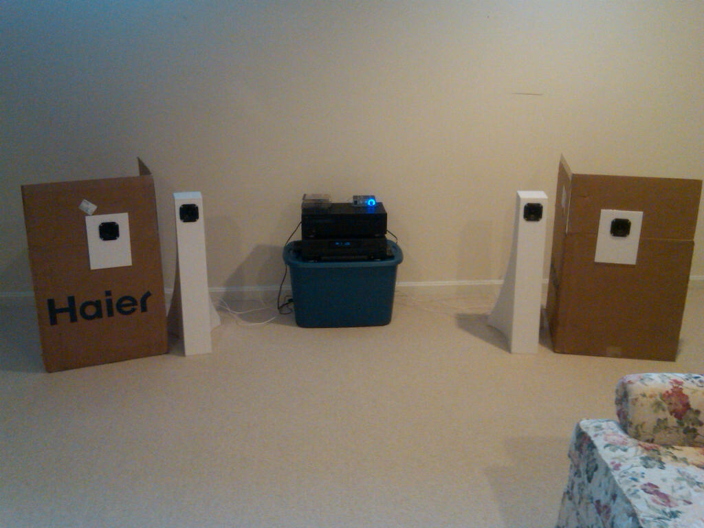

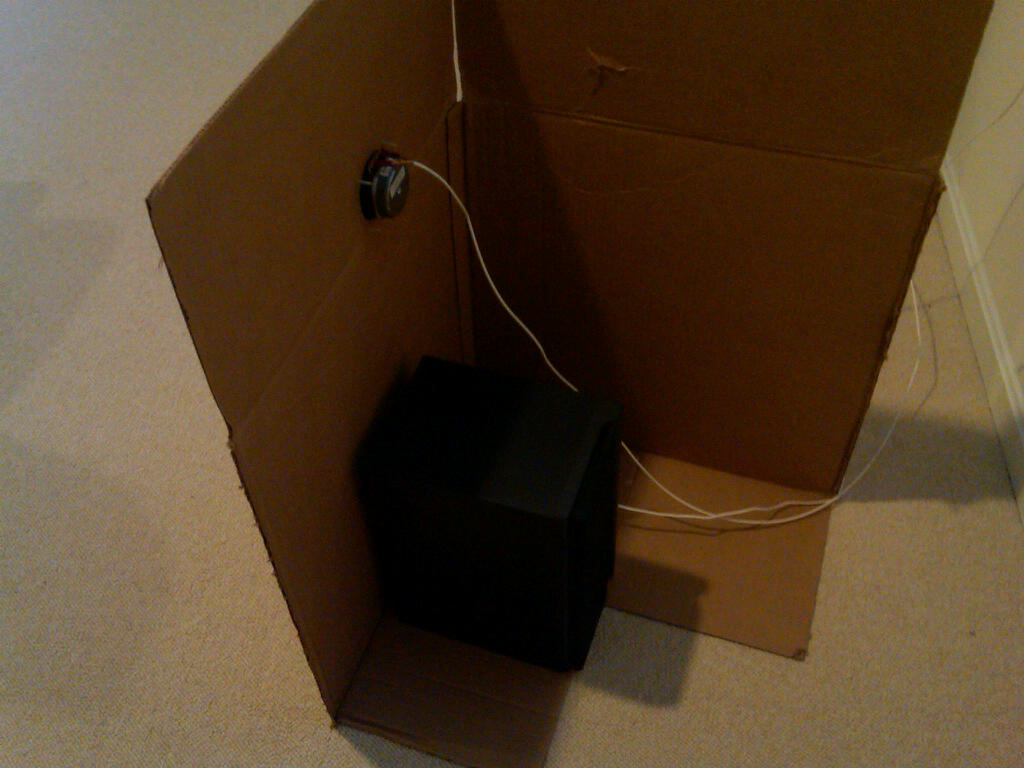

I had an old refrigerator box that I was flattening for recycling and noticed it was about right size for an open baffle. I cut the box into two 90 deg sections and glued a piece of foam core for reinforcing the driver mount. Cut two holes for TC9FD and mounted them, then I put a ported sub woofer (old JVC labrynth subwoofer speaker) behind the baffle and aimed port backwards against wall. So with a sub assisting a full range, I guess I have a FAST with an OB. I hooked up the A output from Yamaha amp to Vifa's and B output to JVC subs no crossover. I have never heard an OB before and I was pleasantly surprised to hear that it was pretty good - very spavious open sound with nice mids and highs. I even tried bi-amping by driving Vifa's with Lepai T-amp. That allowed me to independently control level of sub woofer and bass which was nice to overcome baffle step. Cardboard is fugly and there is no way I am keeping this long, but it was fun and quick. 10 minutes from idea to first sound. Pretty cool and fun if you have never tried open baffle before. In case you are curious, I did an A/B comparo of the FH3-inspired horns and the OB, the horn wins in imaging and vocal clarity and cleanliness of bass compared to sub. I think what surprised me is how good cardboard and 10 minutes of effort can sound! I mean for a small party, these would have been more than suitable for some fun with friends and drinks. :D

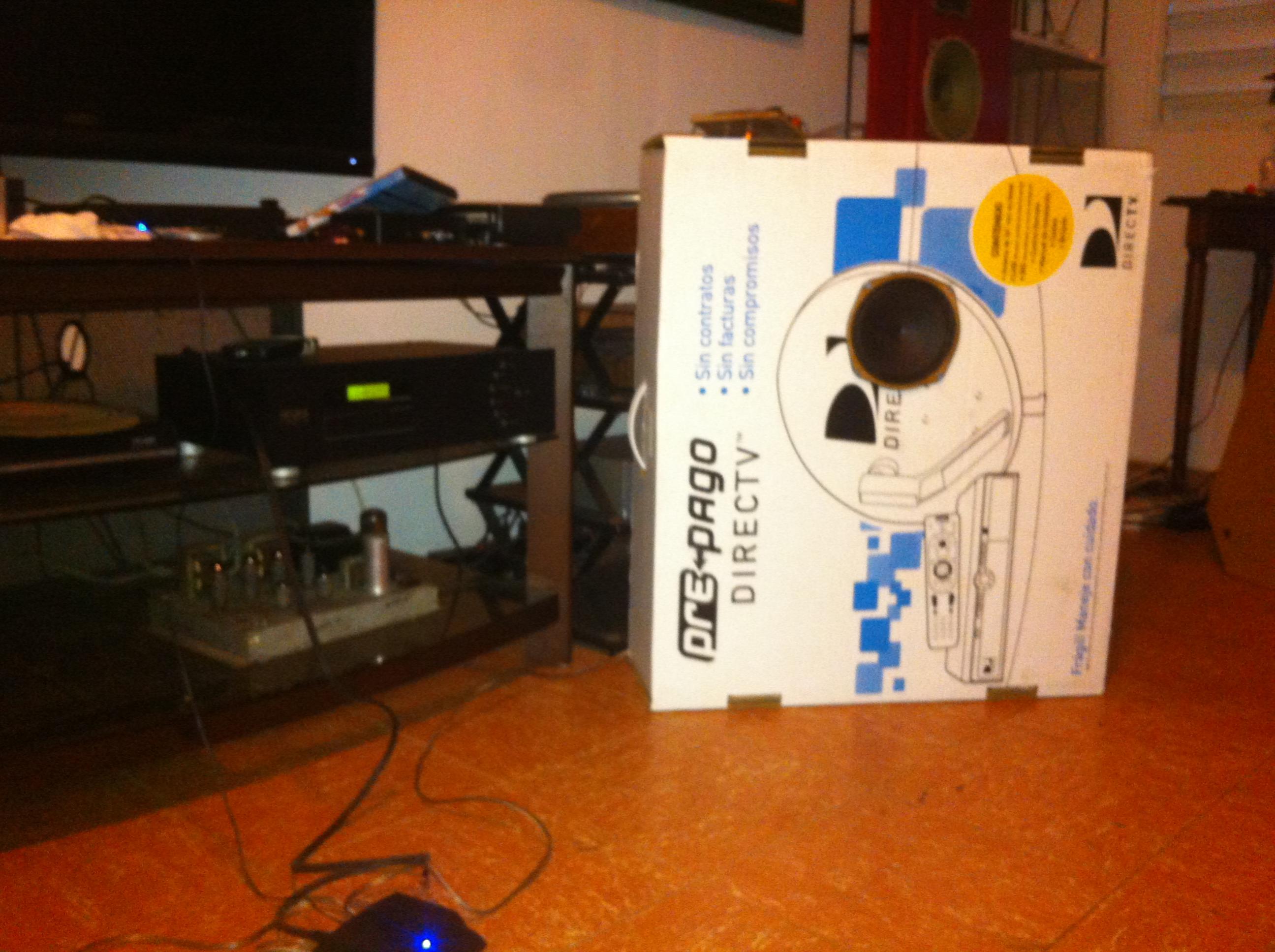

Cardboard is good to experiment, but I like the durability and how easy it is to work with foam core. If you want the carton to last, just get 2-Part Epoxy, the one used for fiberglass cloth, and "paint" the carton with it. It will stiffen and be waterproof.
