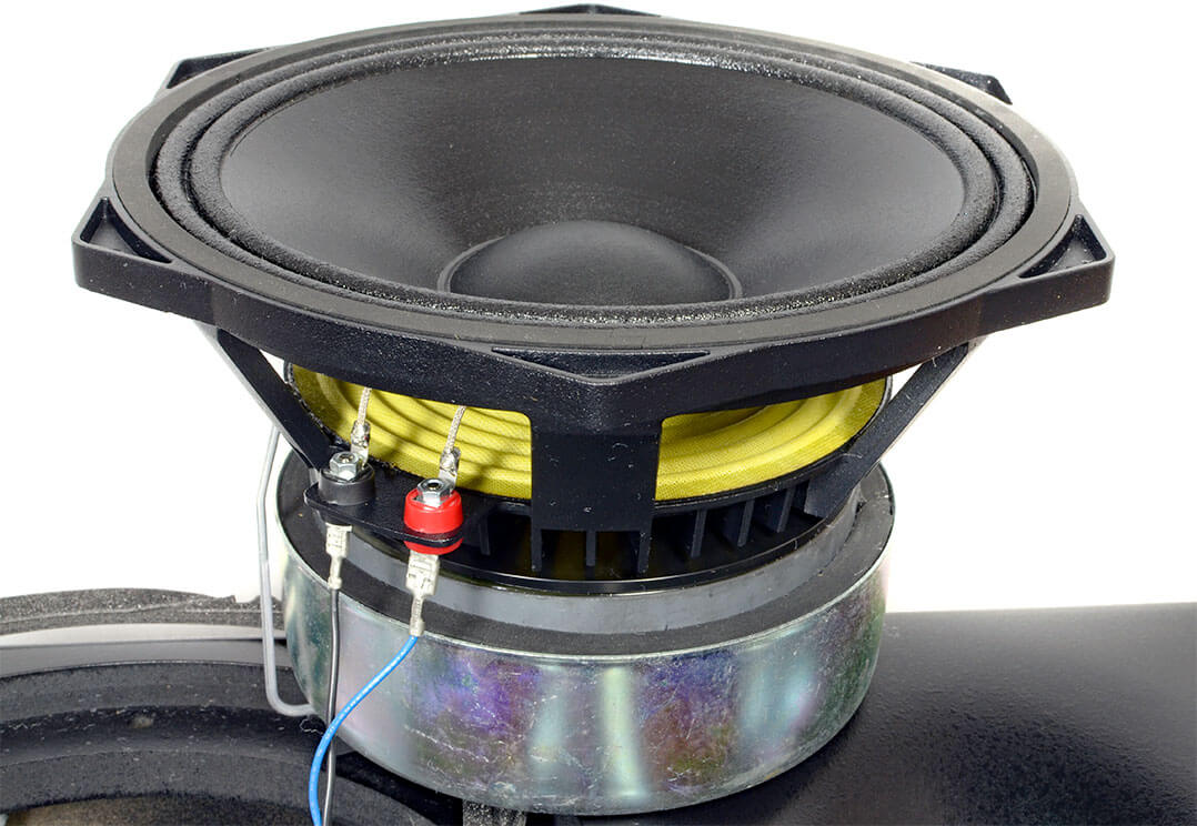

The low end of the 3002 is practically unrivalled, considering it's basically a PA woofer.
The sensitivity of (only) 91 dB is indicative of subwoofer characteristics.
Depending on the shape, size and treatment of the room, the extension in the low-end may be too much, as illustrated by the quote from a review of the S360.
For those who'd like to clone Lindell's 2-way, but 'don't need' the low-end of the PHL 3001, there's a nice and cheaper alternative: the SM110/N, Beyma's classic 10" midwoofer.
