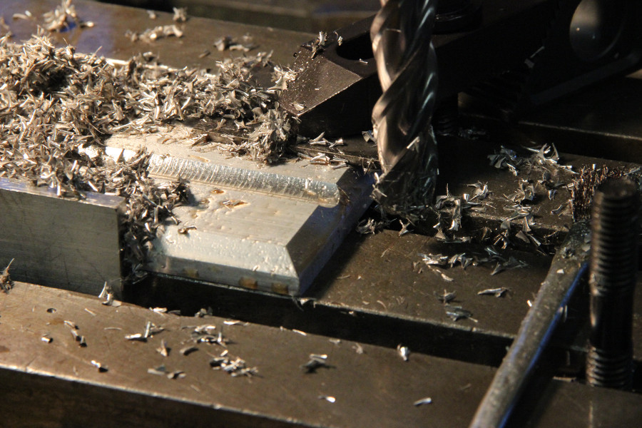

Speaking of which, I am DIY-ing my own HPA-1 chassis. Here's a snapshot of me milling the frontplate on a circa-1955 Bridgeport:
attachment.php
I'm having to make some changes to the volume knob arrangement though, since small-batch anodising is too expensive.
Jeff.
