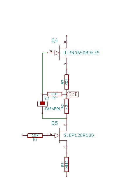

Why? forgive me for my simple understanding, irrelevant of the type of device used, any modulation to the gate puts the device in source follower configuration, what am I missing?
maybe I'm missing something , but I can't see in picture you posted for UJN - any sort or way of modulating it

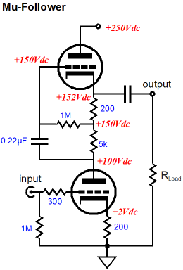

Scrub the previous post, this is simpler.
Yes, you can use a depletion mode FET in a SRPP.
One that has a Vgs between -0.5 and -2V at bias, with a Yfs of say 3~6S ideally.
In practice, such FETs usually have a high positive tempco.
So bias will increase with temperature, whereas the Semisouth has a rather low tempco.
So you will have a DC drift issue to solve.
Can be done, of course.
Patrick

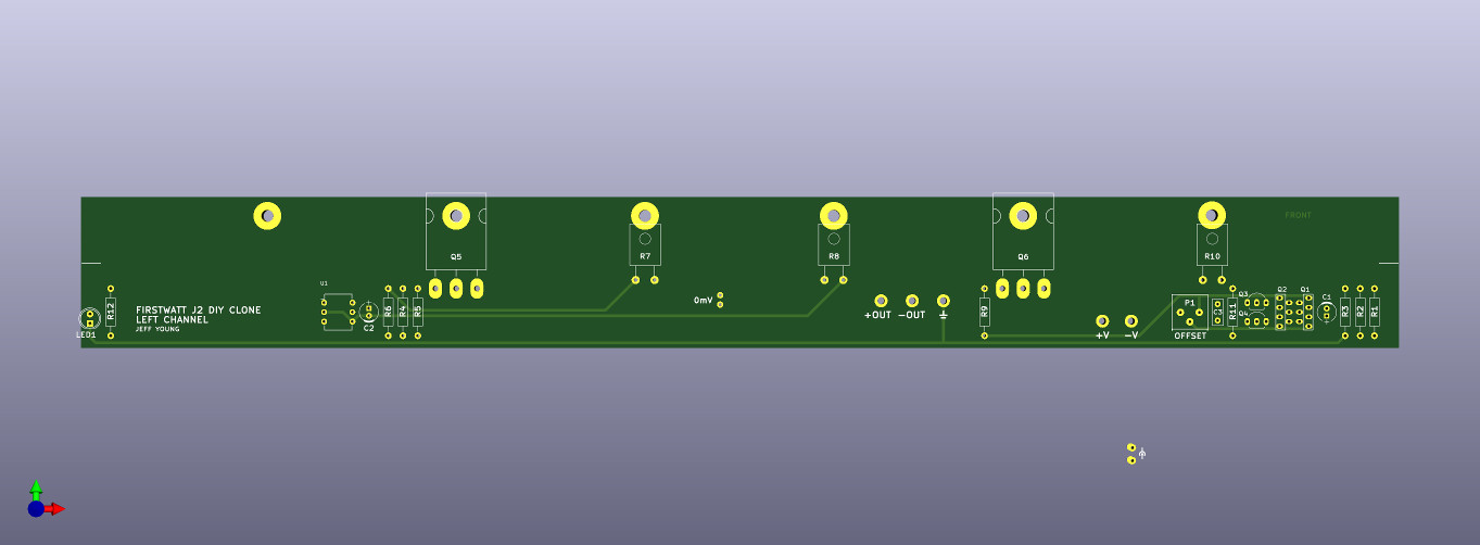

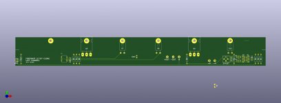

While we're having fun, here's a draft of a FirstWatt form-factor board using Ohmite TO-126 package power resistors in place of the parallel Panasonics.
777450d1566731242-firstwatt-j2-j2-board-draft-jpg
Pardon my ignorance, but how hot are the axial resistor when in use?
Aren't you heating your power resistor while thermally coupling them to the JFET?
Any benefit doing so (resistor value drifting with temp, etc)?
Ohmite TNP series can only take 1W in free air, and 10W on heat sink.
It is thin film and low tempco, but has limted choice of low resitance values.
For the same foot print as 2x Panasonic 2W, one can also use 10x Beyschlag MMB0207 in series parallel.
More rated dissipation, thin film, low tempco, low tolerance, low inductance, .....
Patrick
Given their respective power dissipations I suspect the heatsink will slightly heat the source resistors and slightly cool the drain resistors. Not that I can imagine either of those making any difference.
The primary benefits (such as they are) are that it lowers the parts count just that little bit more, and I think they look cool.
