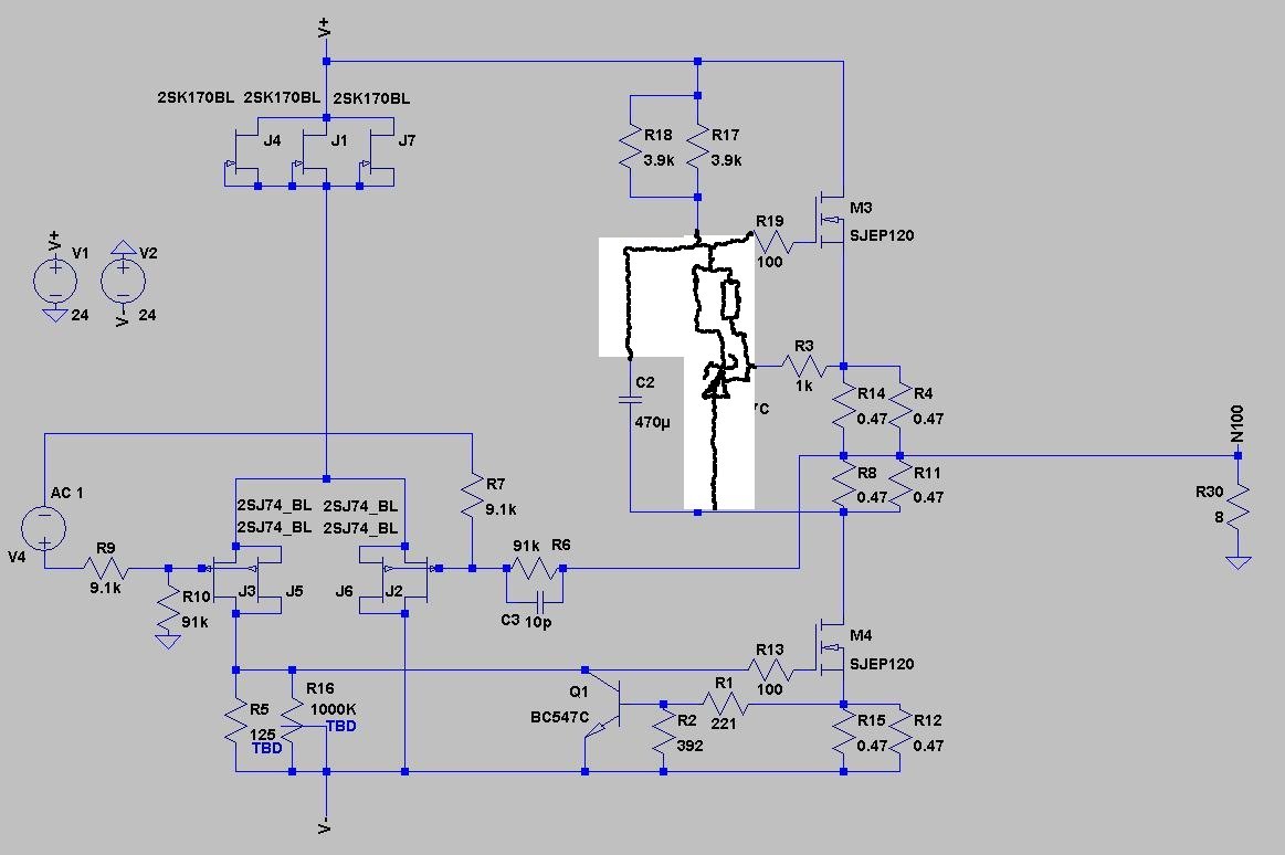

Old schematic used, needs correct values...
In my opinion a possible topology...

I built an amp very close to this design. My front side is essentially exactly the same.
On the back side, I used 15K off the V+ (instead of your parallel 3K9). I also used a CNY17-4 for biasing. I used parallel 0R68 in the bottom half of the circuit where you have parallel 0R47.
The amp works. I would publish the schematic, but it was given to me by another forum member who's already said they intend to publish it.
I'm eager for the author to publish the schematic, because he and I have had different experiences in biasing. His published numbers are fantastic.
I used a picture of another member, just put in my changes. Values have no meaning - I just want to discuss topology...
Regs, Dirk
If you go over to tubecad.com Joe Broskie have several articles detailing what he calls "impedance multipliers" which essentially is the exact same thing as the outputstage of the J2.
The thing is although 2.5V (tl431) would be about the right voltage needed for biasing there is to my knowledge no 6-pin 431 available from any vendor, it is however the common package for optocouplers.
Don't care about number of legs... ;-)))
